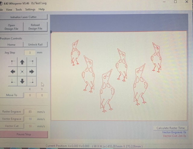

Hi,
Here are the images and an the file which illustrates the problem.
Affinity does not seem to work with K40 Whisperer.
I appreciate your attention.
With thanks - John

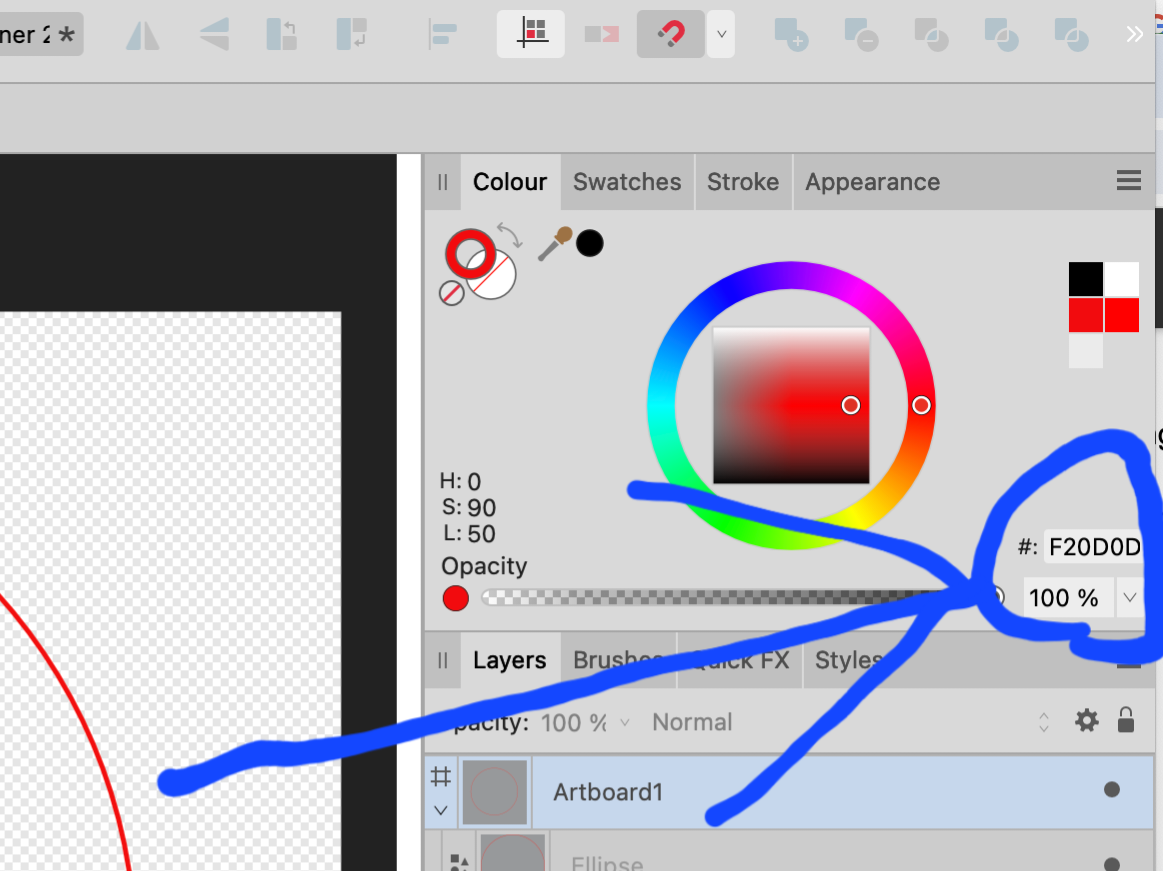

When I open your SVG as a text file (svg is a text format) I see:
<circle cx="142.776" cy="127.758" r="106.651" style="fill:none;stroke:#f20d0d;stroke-width:1px;"/>
Your original posting implies you need this line to be RED (#FF0000) for it to appear as a cut line in whisperer.
You can try to edit your svg file (with vi/nano or whatever) and change the stroke colour to #ff0000 on that line. If that works I guess you need to look to affinity to determine why the line colour is not set properly.
You can see the line color is set to “f20d0d” in the screen shot. Just change that to “FF0000” for red (vector cut) or “00FF00” for blue (vector engrave).

I really appreciate your assistance with this issue. We have solved the problem (fantastic). Using colour FF0000 was the solution.

Side Note: If red is applied as a fill color in Affinity (or any other program) it will not be recognized as a vector feature. Fill colors are always handled with raster engraving.
