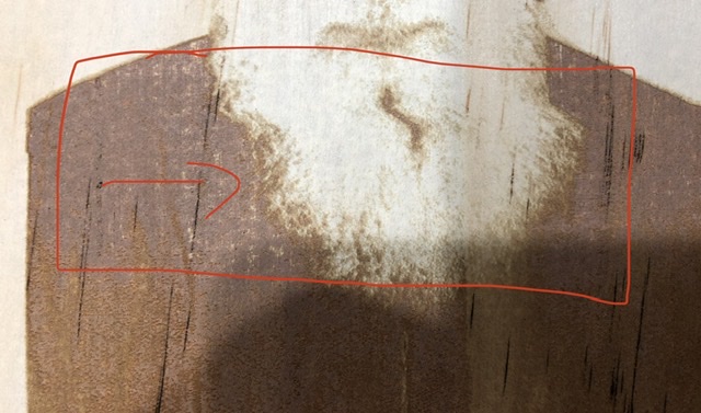

I’ve been using my k40 Chinese laser engraver for over a year now and have only recently come across this issue. The machine plays up half way through engraving. It begins to engrave the image indented. I’ve tried engraving multiple images and the same ’indenting’ occurs. I’ve checked and cleaned the rails, pulley, belt, mirrors and lens. Could a possible lag on my laptop during engraving cause this problem as my laptop freezes at times and is very slow?

Thank you for replying. Just an update the problem only occurs half way down the laser bed (so as in half way down the y axis on the laser bed) and that’s when it starts to play up a little for a few seconds before carrying on with the engraving.

These are the pictures that show where the indent occurs at the exact same point on the laser bed no matter what I engrave.!
The first photo shows the problem, indent caused from the engraver half way down the y axis. The second picture shows what the engraving should look like.

If it truely is limited to a specific part of the laser area, “half way down the y axis”, as described above I would strongly suspect a mechanical problem.
Ideally pauses in the data transmition would not affect the output but I have heard of weird things happening sometimes.
I don’t have any great insight but more testing with a simple design might give more insight as to when the problem occurs. Also moving the laser head around to see if there are any tight spots might provide sone insight.
Yeah I was thinking mechanical as well but want to check with you.
@Claire I would do a check like Scorch suggests by releasing the head and moving it around manually to see if you feel anything different when the head gets to the problem area.

I clicked on ‘unlock rail’ under position controls in K40 whisperer software however I didn’t hear or feel anything out of the ordinary.
I ran another test with another image and the same issue is still occurring in the same X axis area.
