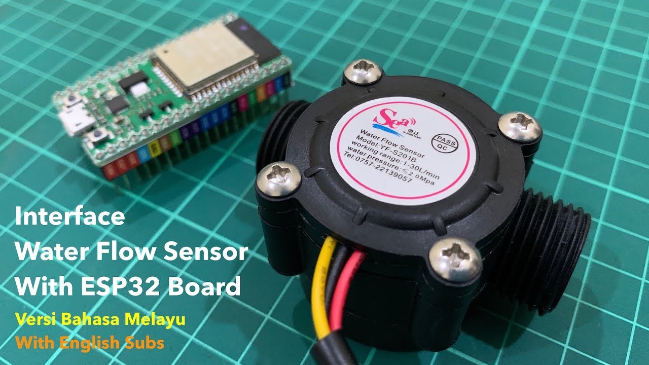

more material, this time waterflow sensor →

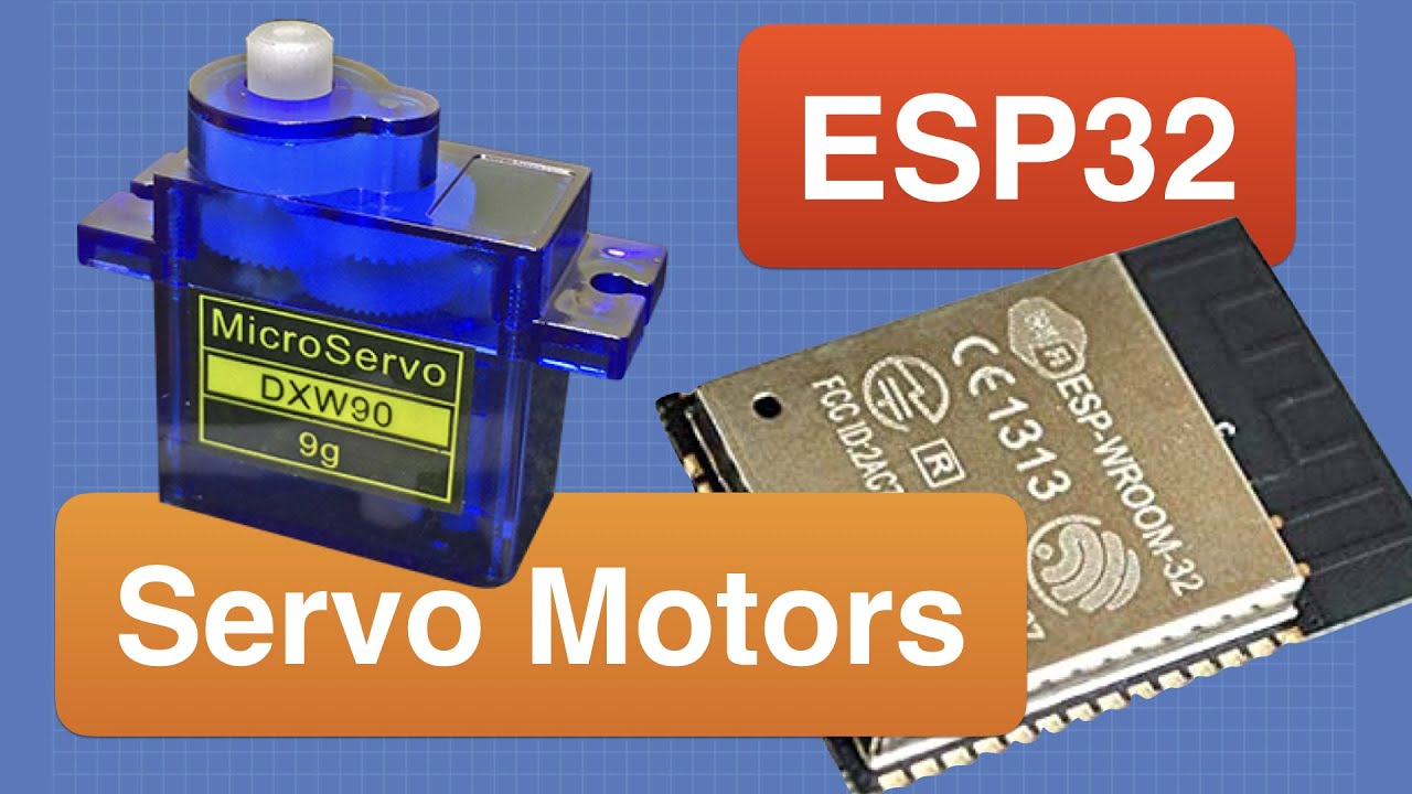

to finish with servos SG90 size for k40 laser head 3D design:
