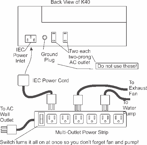

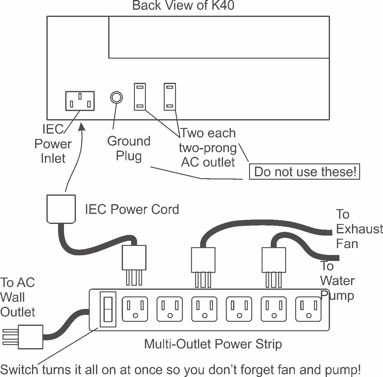

Use a switched power strip
Here is one suggested way to plug in the K40, exhaust fan, and water pump. The grounding plug and two-wire outlets on the back of the machine are safety hazards unless you are an electrical expert. See Laser safety: Light and Electricity - Getting Started with CO2 Lasers - Maker Forums or better yet, use a multi-outlet power strip to turn on the laser, fan and water pump all at the same time. You could also plug your air assist pump into this as well.
