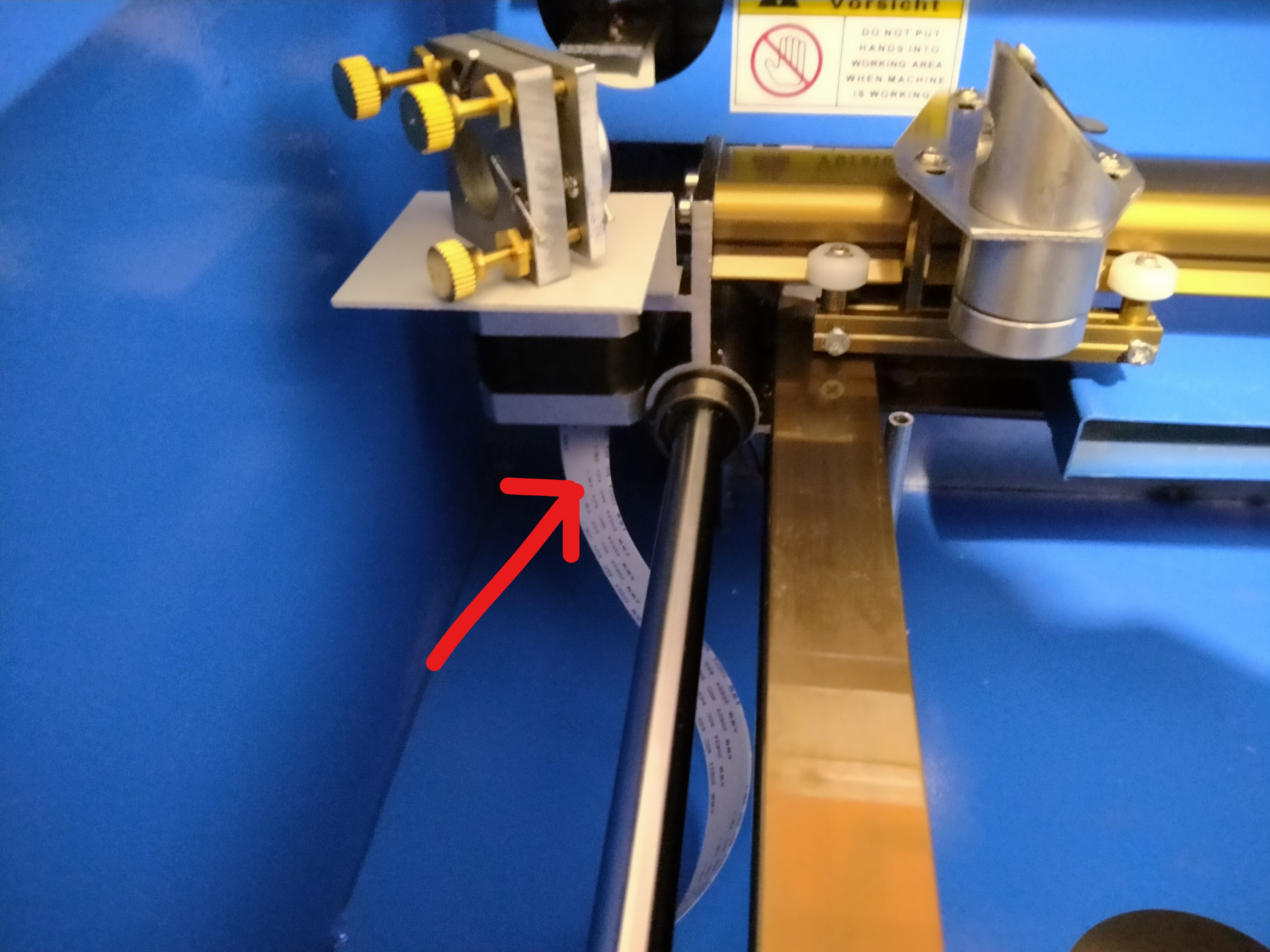

  • When turning it on, i expected the head to go to home position but the motor keep running and bumping on the limit of the Y axe. The head does not move on the X axe.
  • When intalling K40 Whisperer, (by following the setup explanations on scorchworks) the installer can’t even find the machine. The machine is running (i unplugged the Y outpout on the motherboard to avoid bumping, tought i could reset home position directly on the software), the usb cable is connected on a usb slot that works fine with other devices (i tryed with other slots and an other cable, don’t fix the problem). I can’t finish the installation, it says “Cannot install. Laser device not found”. If i close the installation the software run properly, but of course does not operate the machine.

But i my case nothing blocks the emitter/receiver unit to slide into the metal tabs at the endstop, and if i slide a screwdriver into it, it does not stop the movement on Y axis. I may have a problem with this emitter/receiver unit…

The wires to that limit switch might be imperfectly connected or broken. Do you have a digital multimeter and know how to use it?

I just solved this problem : You were right, the cable that leads to the motherboard was not correctly connected, i flipped it on the other side and now the head move fine on the Y and X axis.
Then i managed to properly install the drivers. So now the machine is running and recognized by K40 whisperer, step one completed ! Now looking for other problems propably incoming :stuck_out_tongue:
I have a brand new K40 that I am about to try and get going, and in mine the ribbon you have in your picture (with the red arrow) is just laying there, not hooked up! I was wondering what that was all about, now I am guessing it’s probably a problem…
Yep i don’t know if the head will even move with that cable unplugged…
I actually never tried it, luckily I noticed this post and realized the ribbon was important before I turned the laser on. I honestly thought maybe it was for a light. My other laser came with a cheap LED light ribbon in the housing that was useless. I guess the good side of the issues I had is they forced me to learn more about the machine, and it’s good to know more since I rely on the laser pretty heavily for a engraving a part I use in my business.
The y-axis will still move since that motor is not on that cable. It will just run to the back and keep going. :grimacing:
See this recent vid.
The ribbon cable has the x motor connection, and the x and y limit switches.
