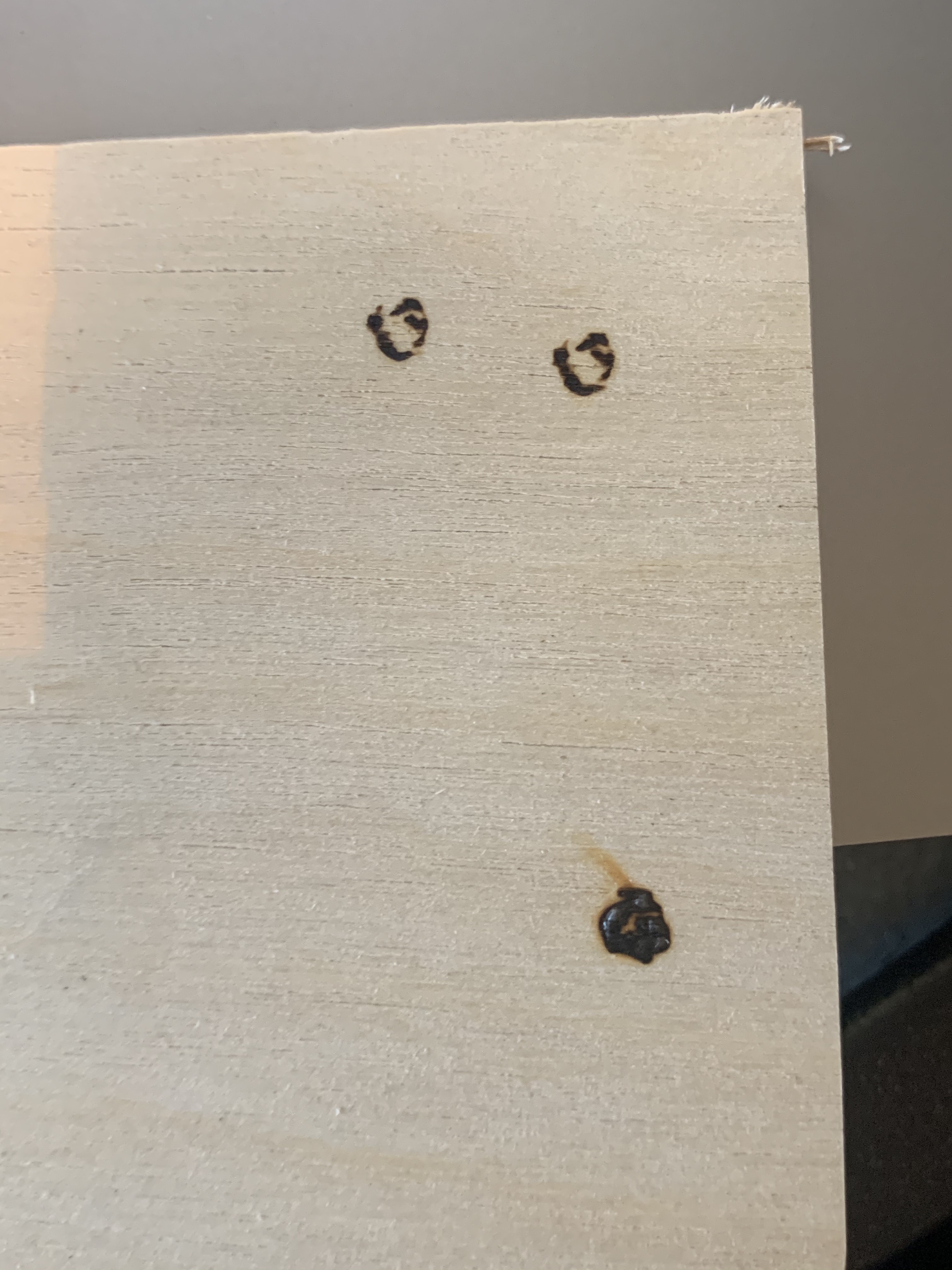

I have a question. I purchased a 50W co2 tube and its firing a broken(non complete oval with no burn spots near the middle of the oval) beam. I put a piece of wood near the opening of the laser that aims towards the mirror 1. When I look at the internal mirror in the tube, furthest away from mirror 1, as its firing, I can see little, what I can only describe as charred spots light up on the internal mirror when I hit the test button. Is this normal? Did I get a faulty tube? Any help you can provide would be greatly appreciated as I’m kind of stuck not using my k40 until its repaired. I aligned the laser and its right on, however it wont even go through a piece of 1/16" poplar.

top is 10% power for 1 sec
bottom is 99% 1 sec
right out of the tube, beam hasn’t hit the mirror yet

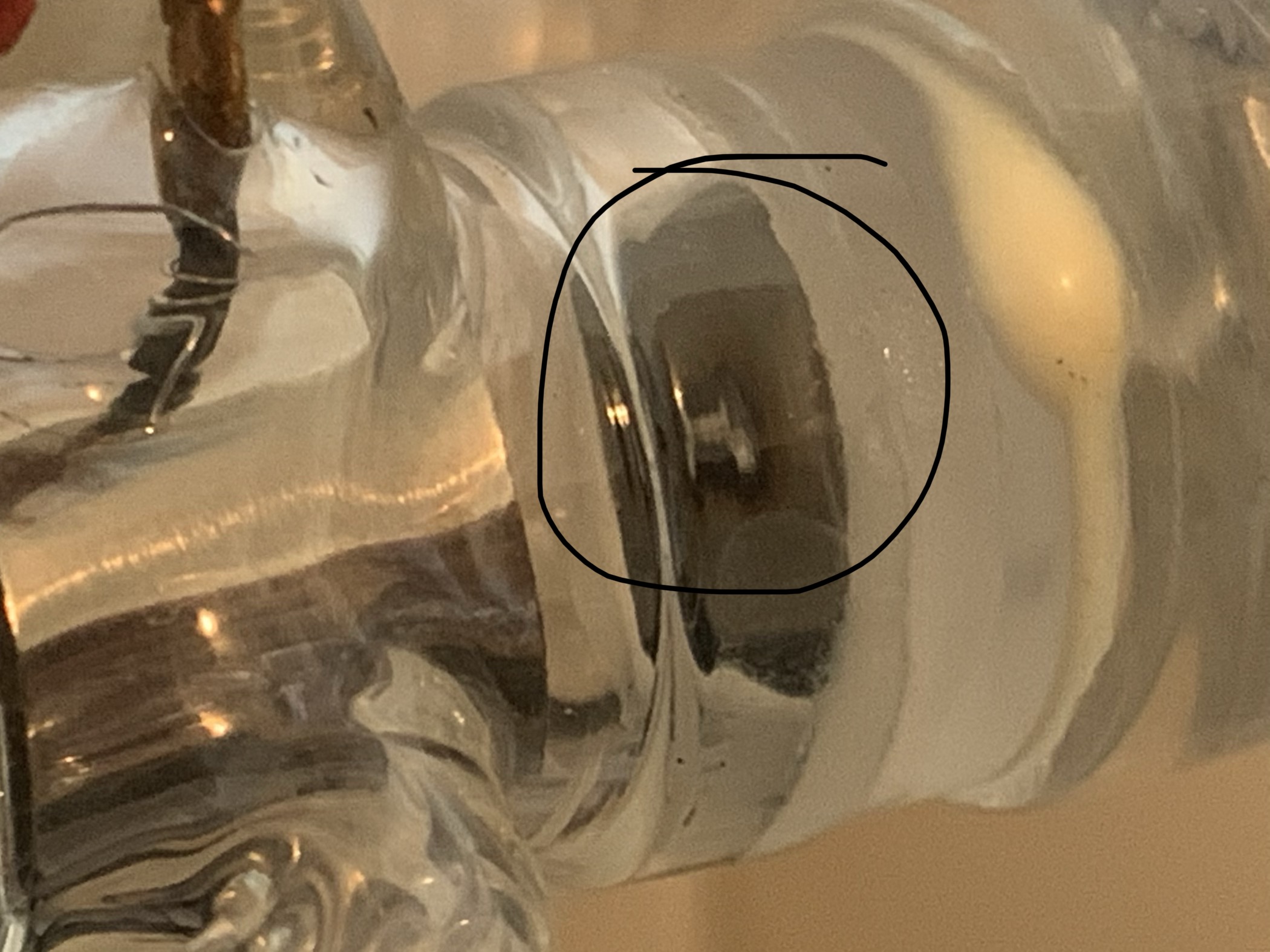

internal mirror not firing

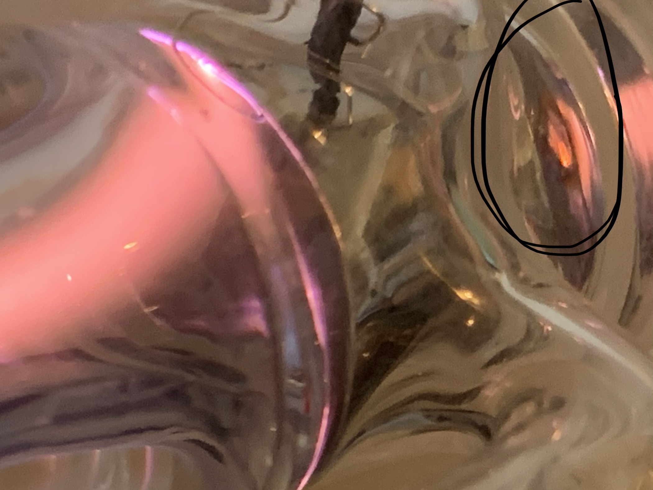

internal mirror while firing
With the tube compartment opened and ppe using an iPhone XR
Hello. I think you have the same problem as i have. The tube. When the power is at around 13% it does an oval mark. If i rase at around 40% it split the beam.
I see what you mean when you say your beam is split. Mine is coming out hollow for the most part. Slightly different issue but maybe they have some of the same root causes. Have you found a solution to it yet or still looking?

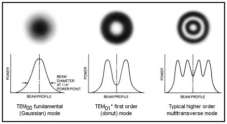

Solution is a new tube. This one dont have more that 50 hours but because of covid i didnt use the laser for more than 2 months so i cannot ask about any warranty. The problem in my case i think are the inside mirrors from laser. In your case i think the tube has gone TEM01 mode. Something like this:
You can find other examples of discussion here about TEM01 mode that might be helpful for confirming the diagnosis:
Here’s a recent example:
