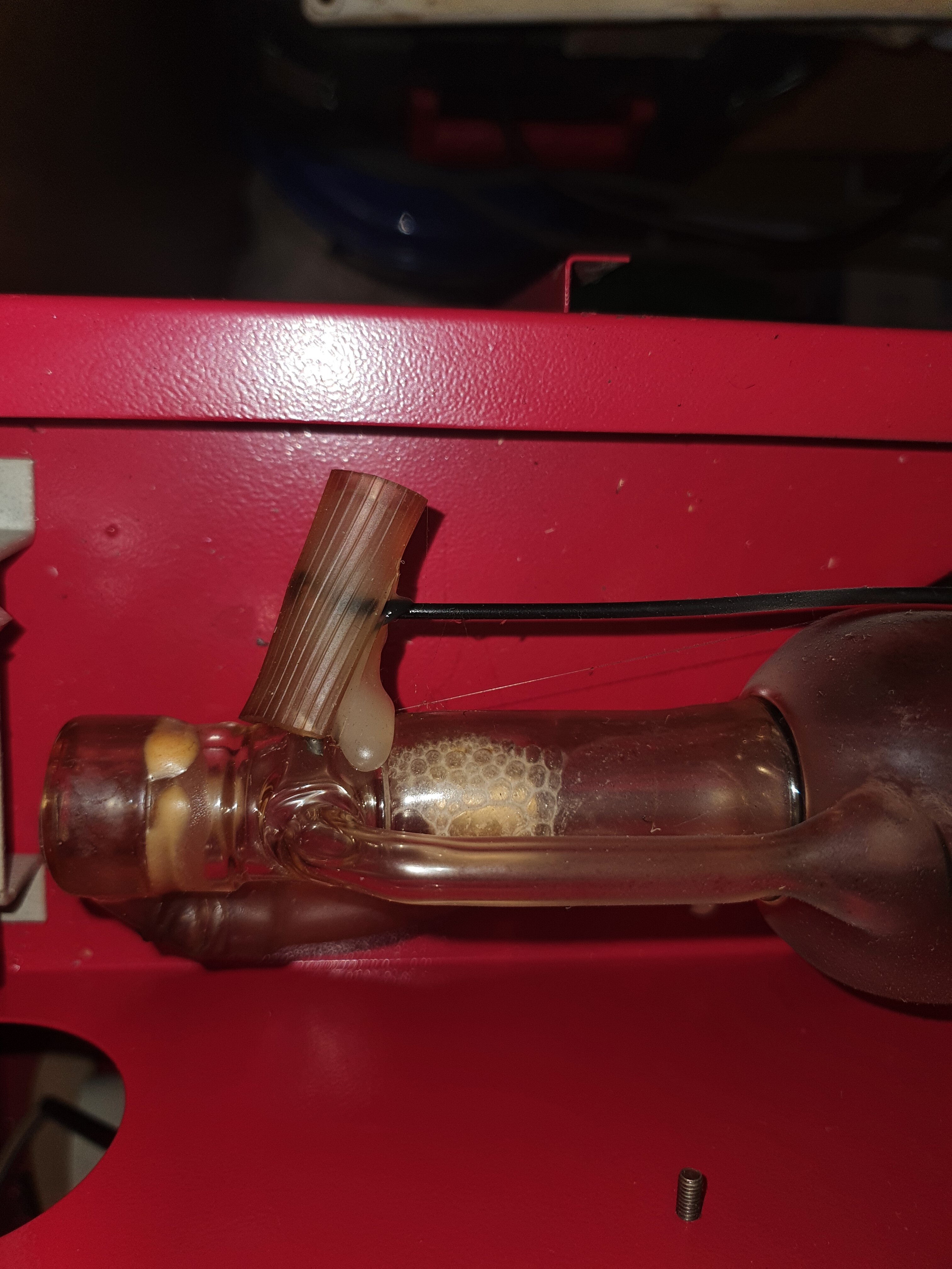

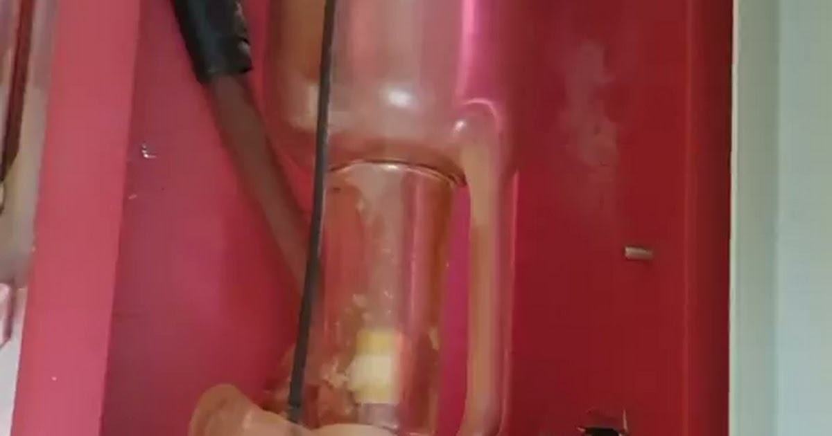

I have one other consern . There is something on the tube that i cant exactly understand if its a cracked tube or just bunch of bacteria .
The pics are a bit bad its under the braket and if i remove it it will be pain to realighn it again because its 3d printed and not exactly the correct screws . Currently i put water + a bit of bleach to clear the bacterias inside and there is a big bubble there that i cant manage to remove no matter how much i lift the laser . Is it possible for the tube to work while being cracked ? Thank you for your attention and i hope you will have a bit of a laugh about my lense mistake … in my defence i didnt expect the round end to have to be on the top while the flatter one to be pointing to the material im cutting / engraving . And a quick tip i found about allighning the 3rd mirror if you dont have the expensive laser that goes on the end . You can put tape on the end where the laser exits and after you test shoot you look directly in the 3rd mirror with enough light on the table you can clearly see where the laser hit the tape with out having to remove the tape or mark it in any way ( just be sure to not press the fire while your head is in the way ofc even better click the button to stop the power to the laser before checking the hole ) and sry for my english not sure how many mistakes i made while writing this .
I panic easly … good news it was just dirt now its clean and no bubbles there my only spot with bubbles now is in the front but i assume its from the bleach
Should clean up in coupple of hours i hope . Do you have any suggestions what yo put in the watter to not get the bacterias . I read somewhere Antifreeze is distorting the laser wavelength or something like that refracting it not sure exactly ?

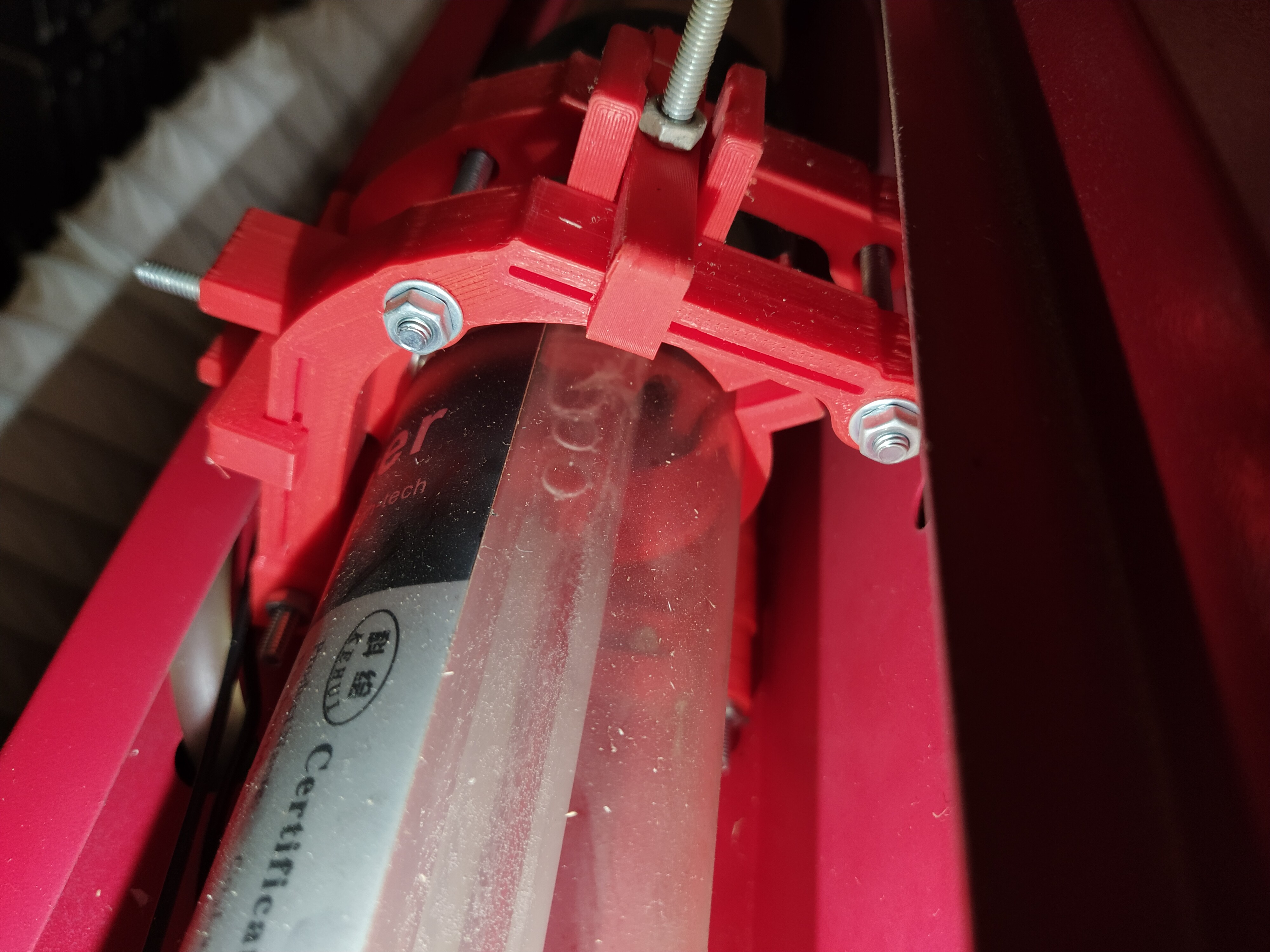

My saga continues … :smiley: i was able to use it for a while but i started having misalignment issues so i tought to buy a beam combiner but it didnt fit in the k40 and i already had put new holders for the tube cuted some metal moved the whole internal bed so i can cut and put it back making sure its paralel to the back wall same goes for the tube .
I manage to align all mirrors as pictures show close and far test fires
I even has to make a new stand for the 1st mirror ( 3d printed from the original one )

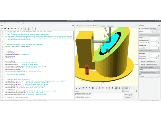

This might help with the combiner issue:
