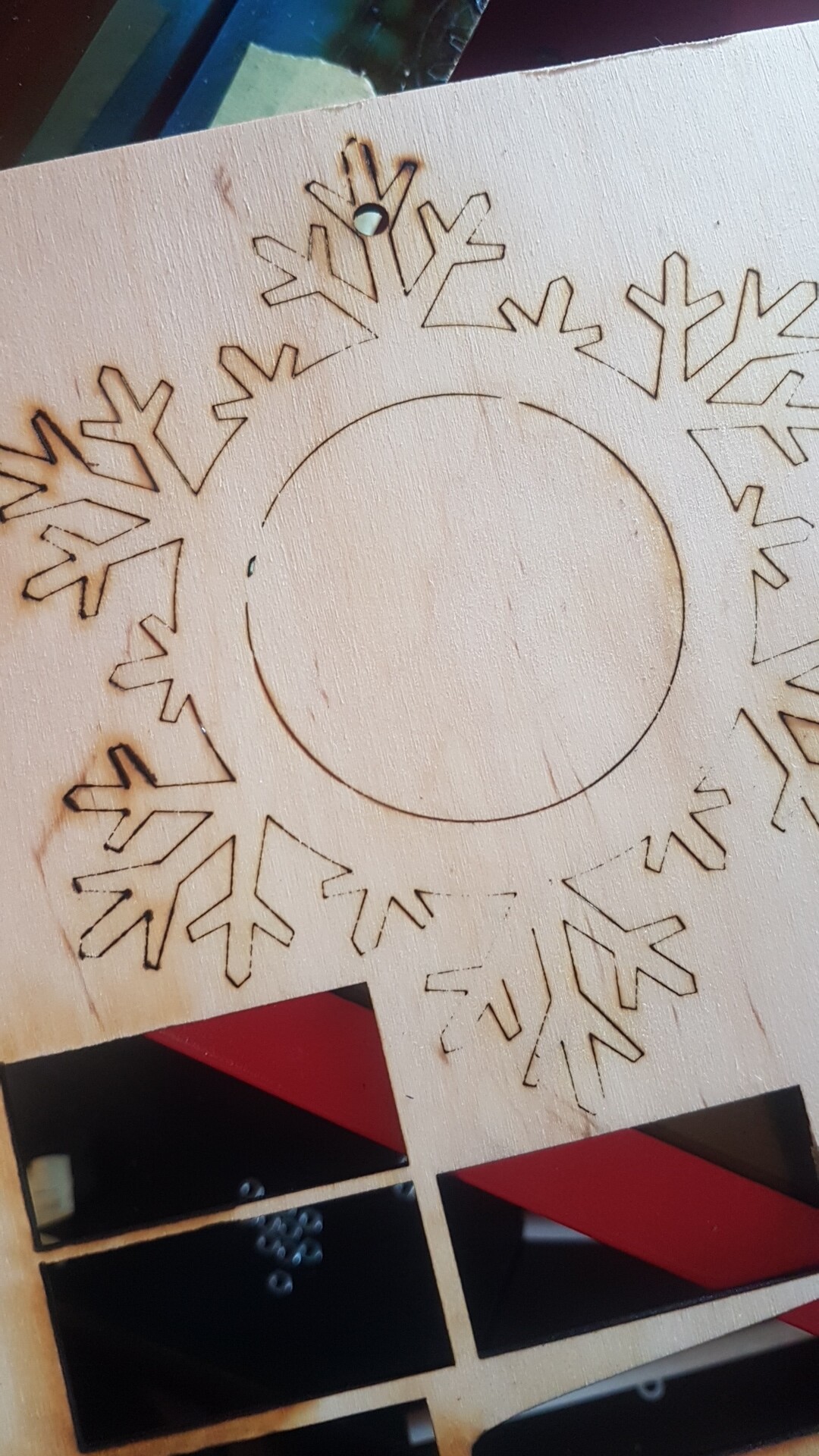

Hey guys first time writing created my account to request your assistance . I have a k40 little modified added 3d printed mirror holders and 3d printed tube holder . My issue right now is that when i cut its not cutting all the way everywhere .
Its mostly on the right side when it stops to cut bu there are some places on the left half too . Mirrors and lens are cleaned and aligned as much as i could <1mm error i assume . But i doubt that yo be the reason for this . I would appreciate any advice of how to fix it . ( i was using air assist from a little blower i had but today it broke ) this is halfly done with AA . I even run the program 2nd time a bit faster on same power with the hope to cut it were it did not but there was almost no improvement .

Yes its 3mm plywood and yes the glue makes some issue but most is just coloring and making dirt marks on the back ( i would appriciate if you can point me to another type of wood that i can use this is the only one i manage to find in my city that was not like crazy expensive )

You should be able to cut through common 3mm ply without much problem. There is plywood made with a melamine glue that is much easier to cut, but it’s going to be more expensive.

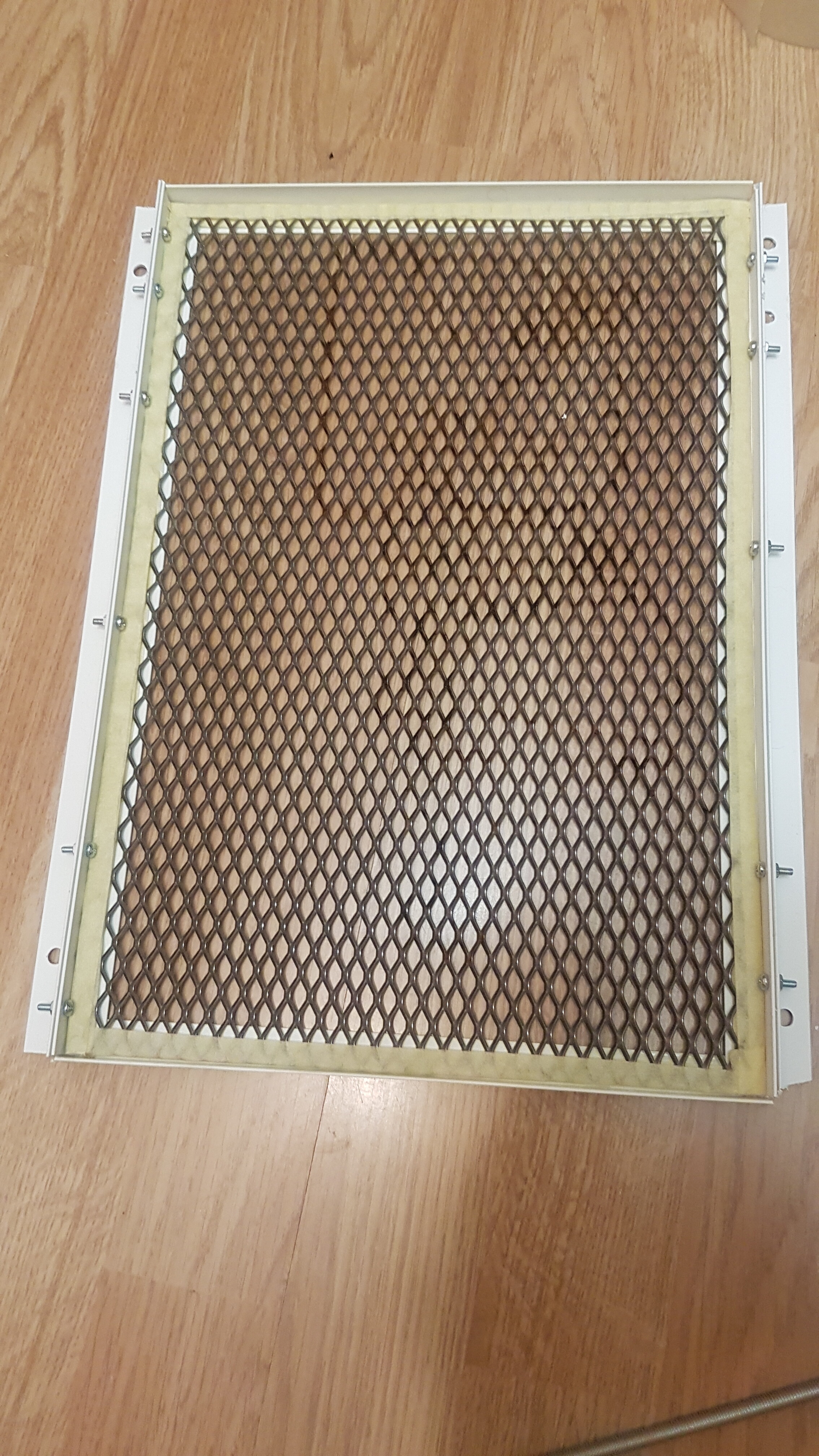

And i appolagise for t he messy picture apperantly i can share only 1 pic at the same time so i just mashed them all in one . The first 2 are the 2 beds i tried one was the stock one the other was a mesh one but it warped so now i’m making a holder (3rd picture) with some brakets to hold it and i had that long bolt thing cutted in 4 small pieces to be able to ajust it with nuts . The lower 3 pictures was my air assist which burned out i assume the propeller melted because it was not supposed to work more than 5 mins at a time :smiley: who reads the manual before use . I will look for some fish tank pump . I will try to add more information about the progress as i go forward with it . I had to dissasemble the whole bed again (with the moving parts ) to get the exaust out and got it cut even more because it was in the way of the new bed in addition i noticed that there is a lot of room to allign the X and Y arms when i’m bolting them to the chassy (last 2 pictures) any advice how to properly mesure if i’m bolting them alligned . (I know i will have to re-allign the mirrors when i’m done but first i want to make sure the whole constuction is alligned ) .

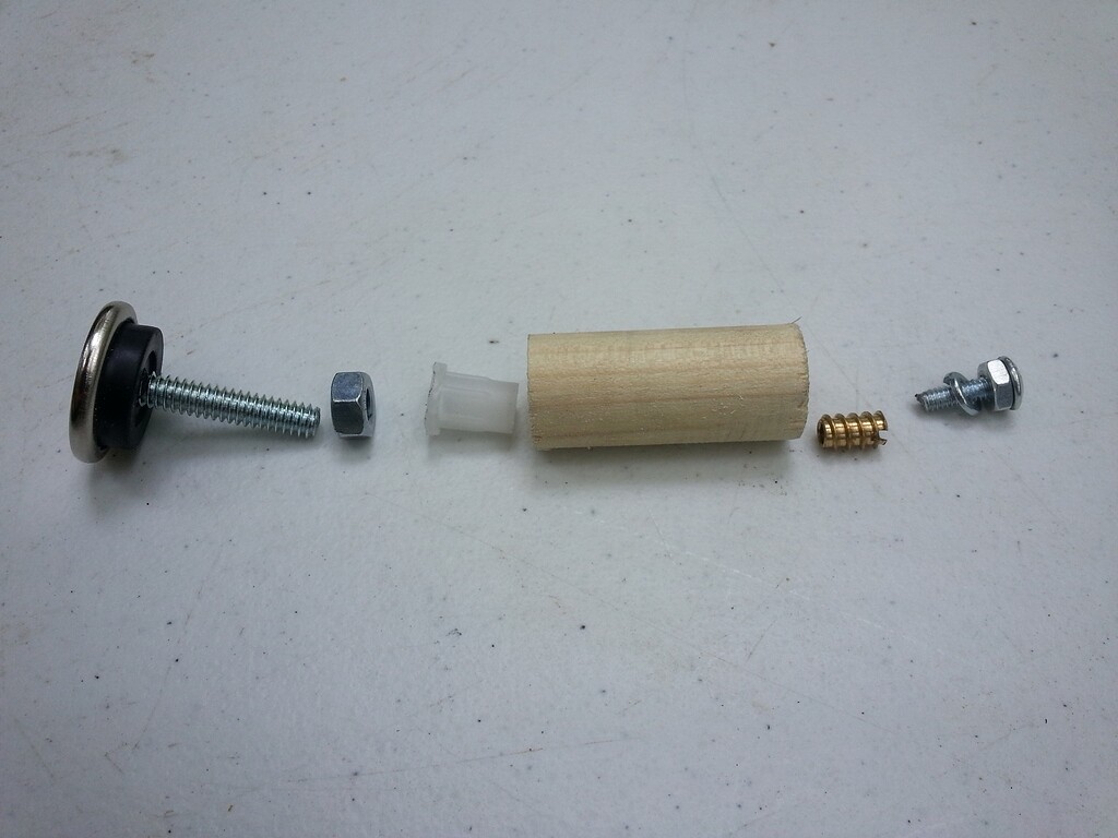

With your bed set up I do not think you are working at the optimum focus point for cutting. You really need to have someway to adjust the bed height. You can search on here for a number of options for an adjustable bed. Here is a quick and easy one I did when I first got my laser.

I made some ajustable bed and with a toothpick i manage to adjust it almost perfectly should work untill i figure something better . And for air assist i found a very old weak air pump for aquarium but it works good enough i get clean cuts now .

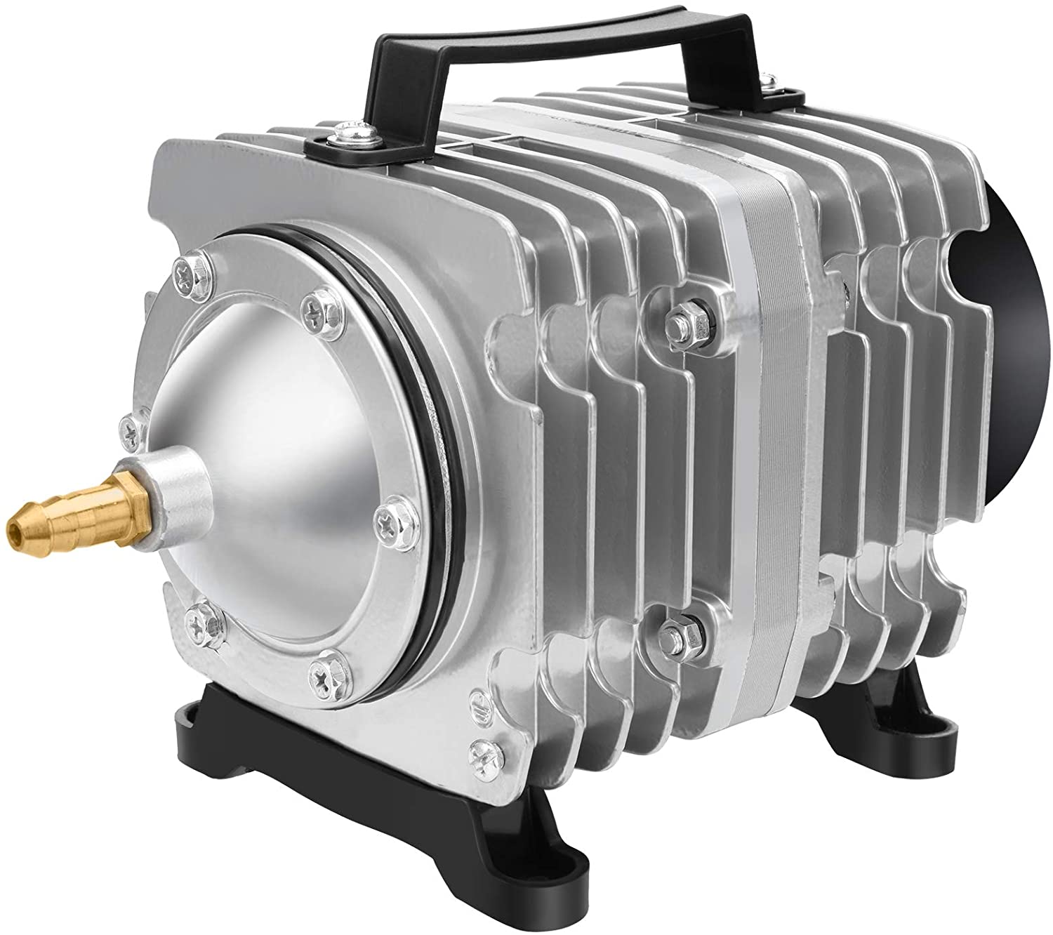

Glad to hear :slight_smile: . With aquarium pumps we typically recommed something like this for better air flow for future reference

A bit of an update still havent tested it and when i do will write again . I changed the head with the one in the picture and change the base of the metal mesh . It is supposed to have a belt to move it up and down but i assume i wont need it that much having in mind the new possible Z movement of the head . I will still need to calculate some things because from the lens to the tip of the head is 40.8 and the lens is 50.8 so i need 10mm between the tip and the bead but if i put lets say 5mm thic wood that little 10mm chip i use wont be usefull and i will need to make one that is 7.5mm (from the tip to the material) for example ot at 3mm will need 8.5mm chip to hit the middle of the wood .
And yes i used hot glue to glue the base :smiley: while keeping the same tabletop from the previous try but it was wobly and harder to level . The base is a 3d model from thingiverse .
you definately NEED air assist to not only help keep your main lens clean but it greatly improves cutting capability. The pump @NedMan posted a link to( ~$45 ) is the one to get. I use a compressor and a small diameter tube blowing right at the cut but will be moving to this same compressor since my main compressor is so noisy and requires pressure regulation and a hose running across my garage. The air assist also blows the smoke, fire, debris away from the cut and out of the way of the cutting beam.

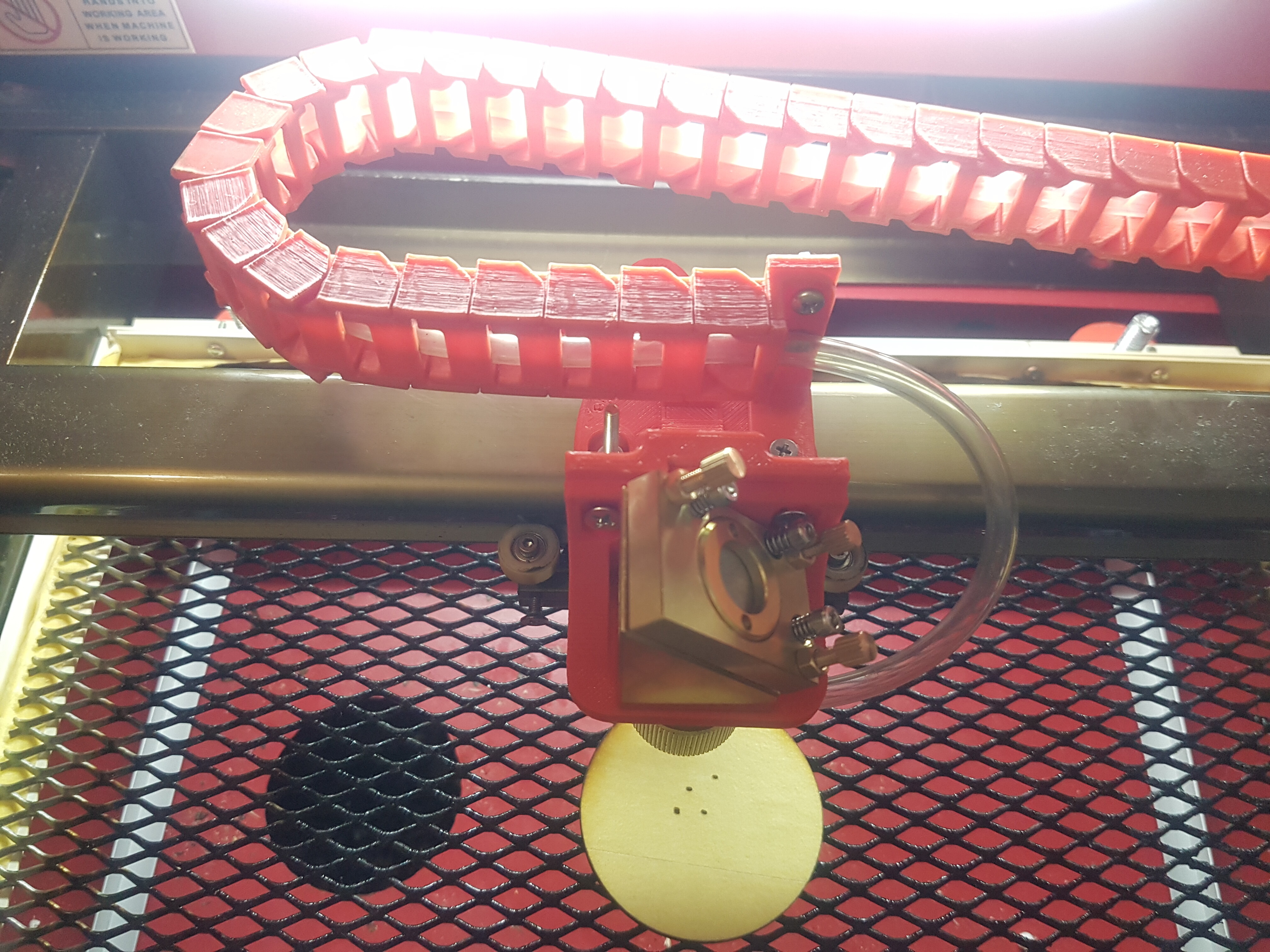

Hi everyone . A bit of update i manage to butcher it on the laser head with my trusty 3d printer and some thingivers models. My only issue now is how to align the 3rd mirror towards the lens . Currently its making the laser dot a bit like elips instead of a dot . Any suggestions
