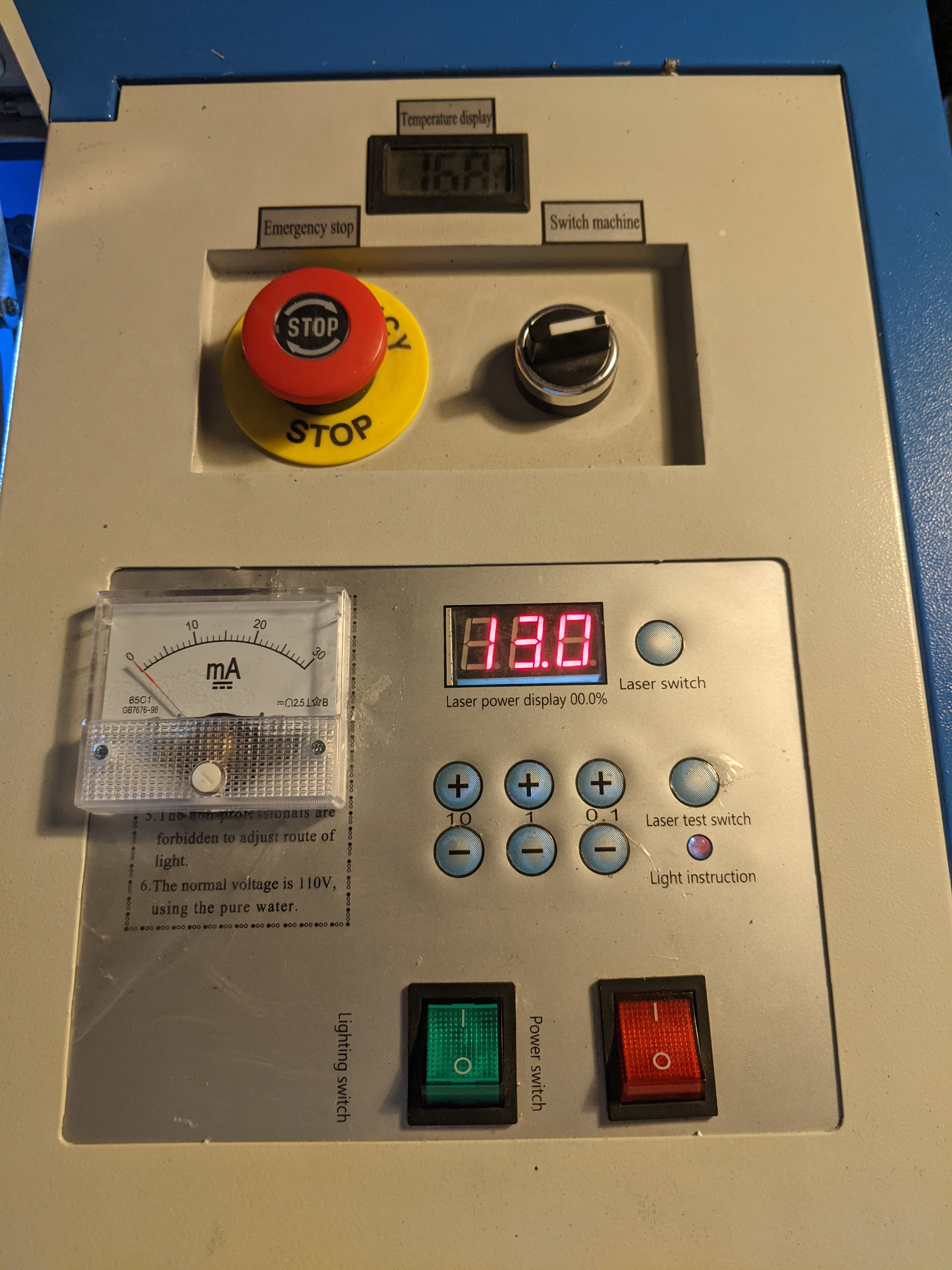

  • If I do a test fire from the control panel it works fine once I dial it up past 13% power on the display there.

  1. Post a picture of your control panel.

  1. Here’s the control panel top and underneath

Sorry I missed your question about the power. I have the machine set to 13% which is showing at like 3 or 4 ma. If it’s below that it won’t test fire, if its above it will. I haven’t tried raising the power level to see if lightburn works if the machine power is higher because I assume lightburn can raise the power itself.
I’m new and don’t want to break anything so taking baby steps. I could try setting the machine power higher and then trying to run the test file in lightburn maybe?
Update: I tried raising the machine’s power to 30% on the control panel and that started making the laser fire when running the test file, so my assumption about lightburn moving the laser % up and down by itself was incorrect. It appears I need to set my laser power independent of lightburn?
I found a number of other threads explaining K40 power settings on the machine, which are different from the settings in a Lightburn file, so I’m good to go now. I learned each machine is a little different but that I should set my test fire level so it hits around 12-15ma, then a 50% lightburn command should hit around 6-7ma, etc.
Thanks!
Right, the front panel is setting the maximum, and then the number sent from Lightburn is percent of that maximum.
