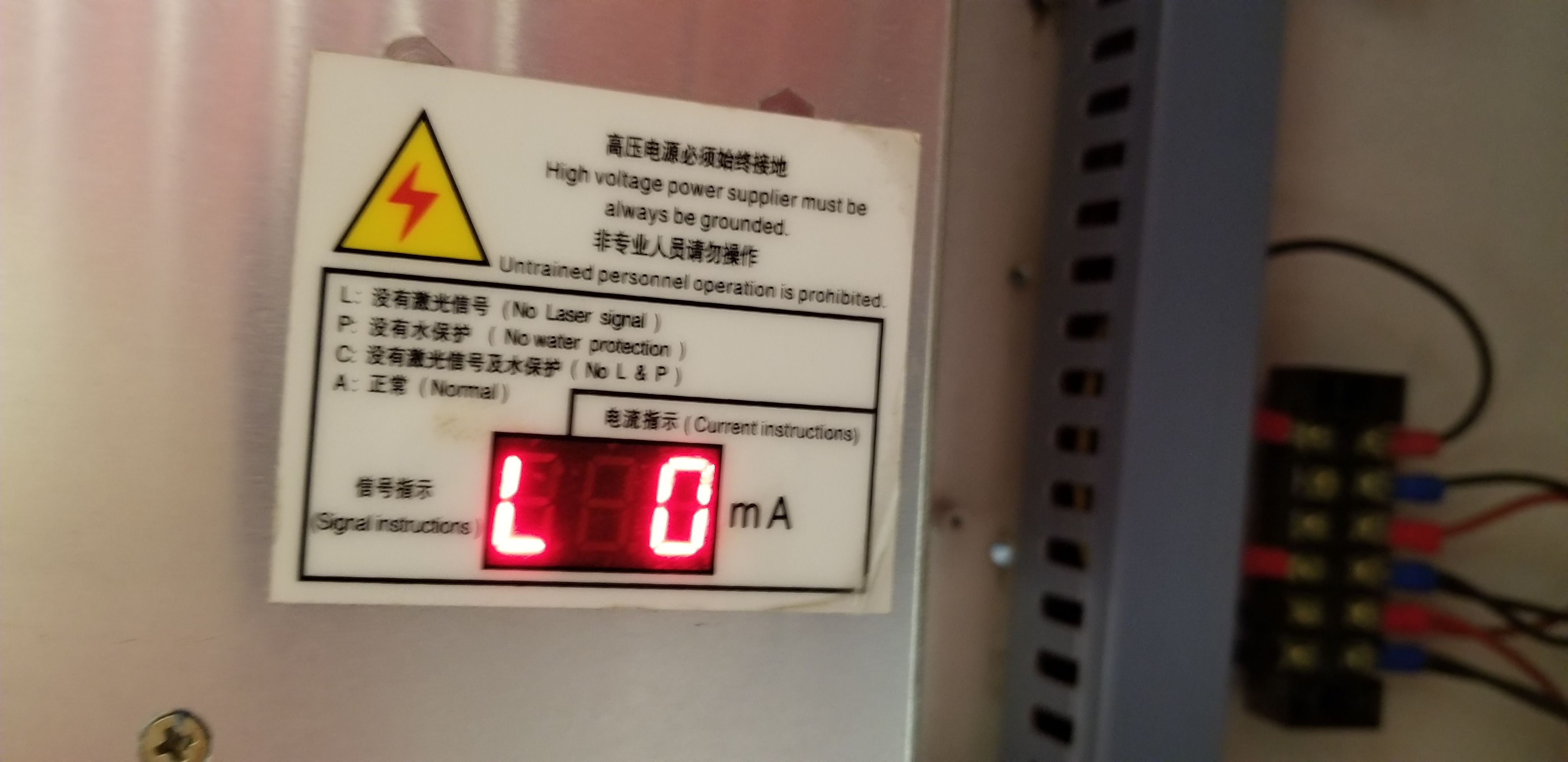

The PSU message states “L” which says L= No Laser Signal

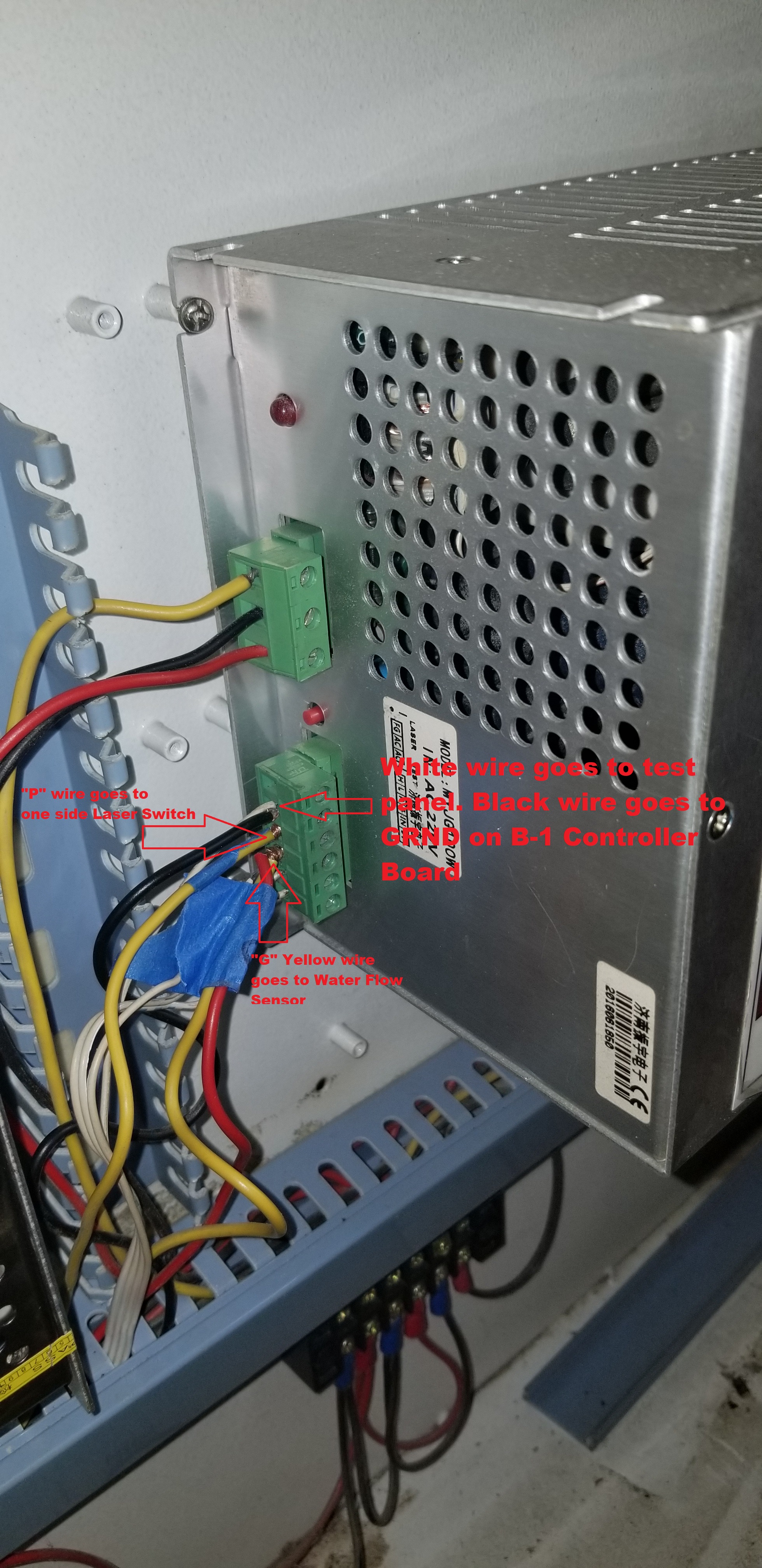

3. What make/model of LPS are you using?
Please post a picture of your LPS showing the connectors and display

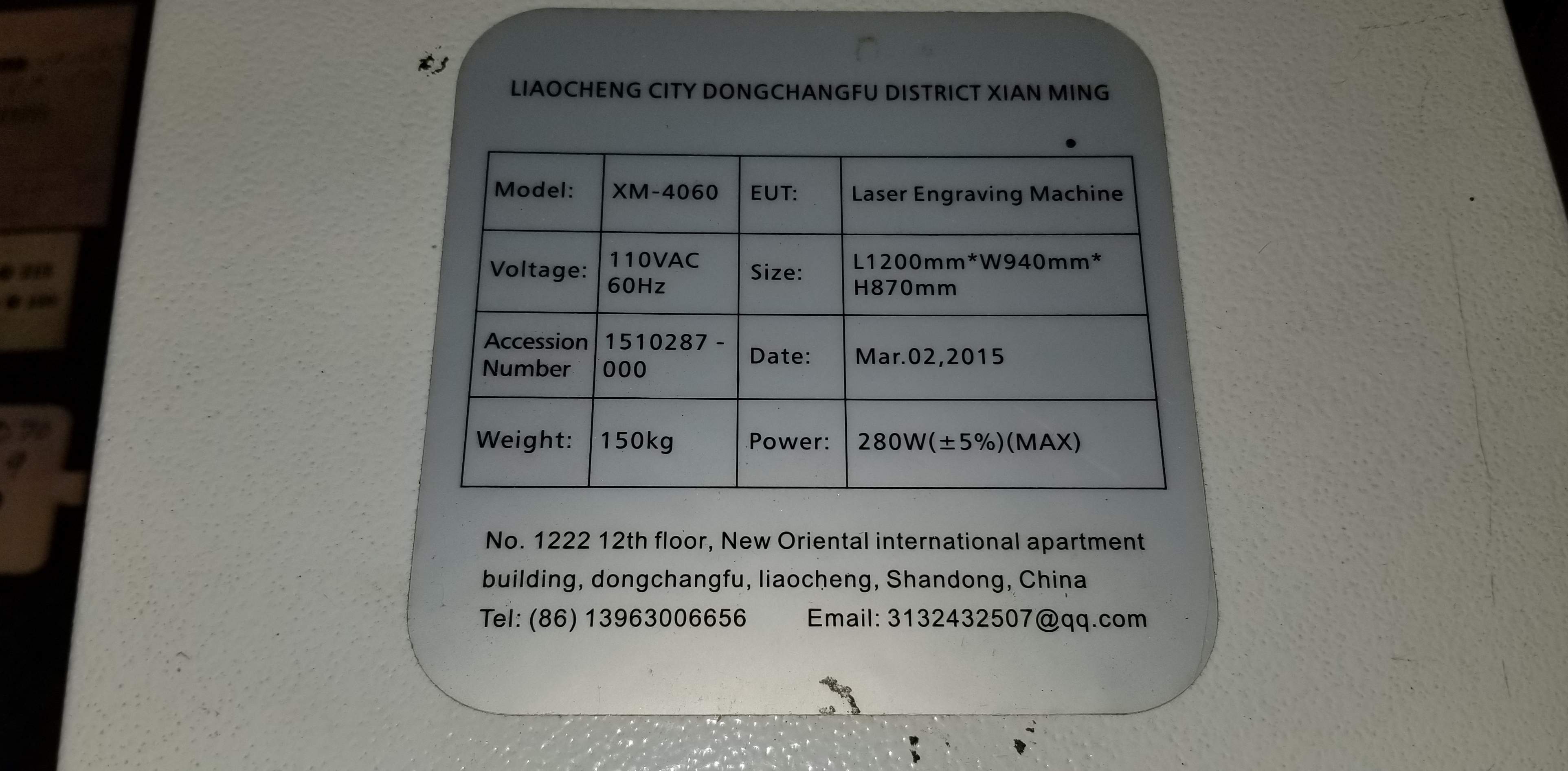

  1. Its a 100W XM-4060 large production laser cutter. Large K40 type.
  2. The message “L” is posted on the Power Supply Unit (PSU) It has a diagram that states this message means: “No Laser Signal”. It does have the ability to give me an error code for Water protection… But at the moment, im not getting that… Just “L” no laser signal.
  3. Laser Power Supply is stock, its model: MYJG100W

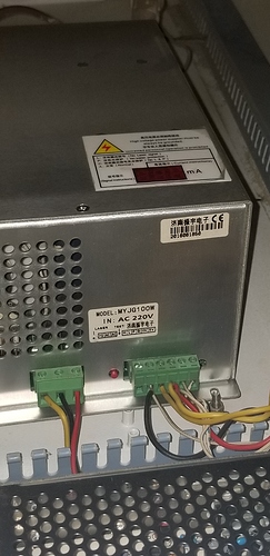

LPS wiring questions:
On the L pin [2cnd from the left] there is a black and wht/blk wire connected.
3. Where do they connect, I would expect only one wire on that pin.
On the P & G pin there is a yellow wire. This is likely the interlock loop. However, the water flow switch has black wires??
4. Can you trace the yellow wires and tell me where they go?
5. Can you trace the water flow switches black wires and tell me where they go?

Pictures posted. Test button on main outter panel as well as the LPS red button.
The White cable goes to the Outter control panel that has the test button on it. The black cable goes to GRND on the B-1 Controller board inside the laser cutter
You are correct. after tracing the wires the Waterflow sensor wires start off black and then turn yellow.
One water flow wire “yellow” goes straight to “G”. The other Water flow sensor wire “yellow” goes one side of a “Laser Switch” I have on the front of the laser cutter. The Yellow wire in the “P” goes to the other side of that “Laser Switch” (opposite side of the Yellow Water flow sensor wire)

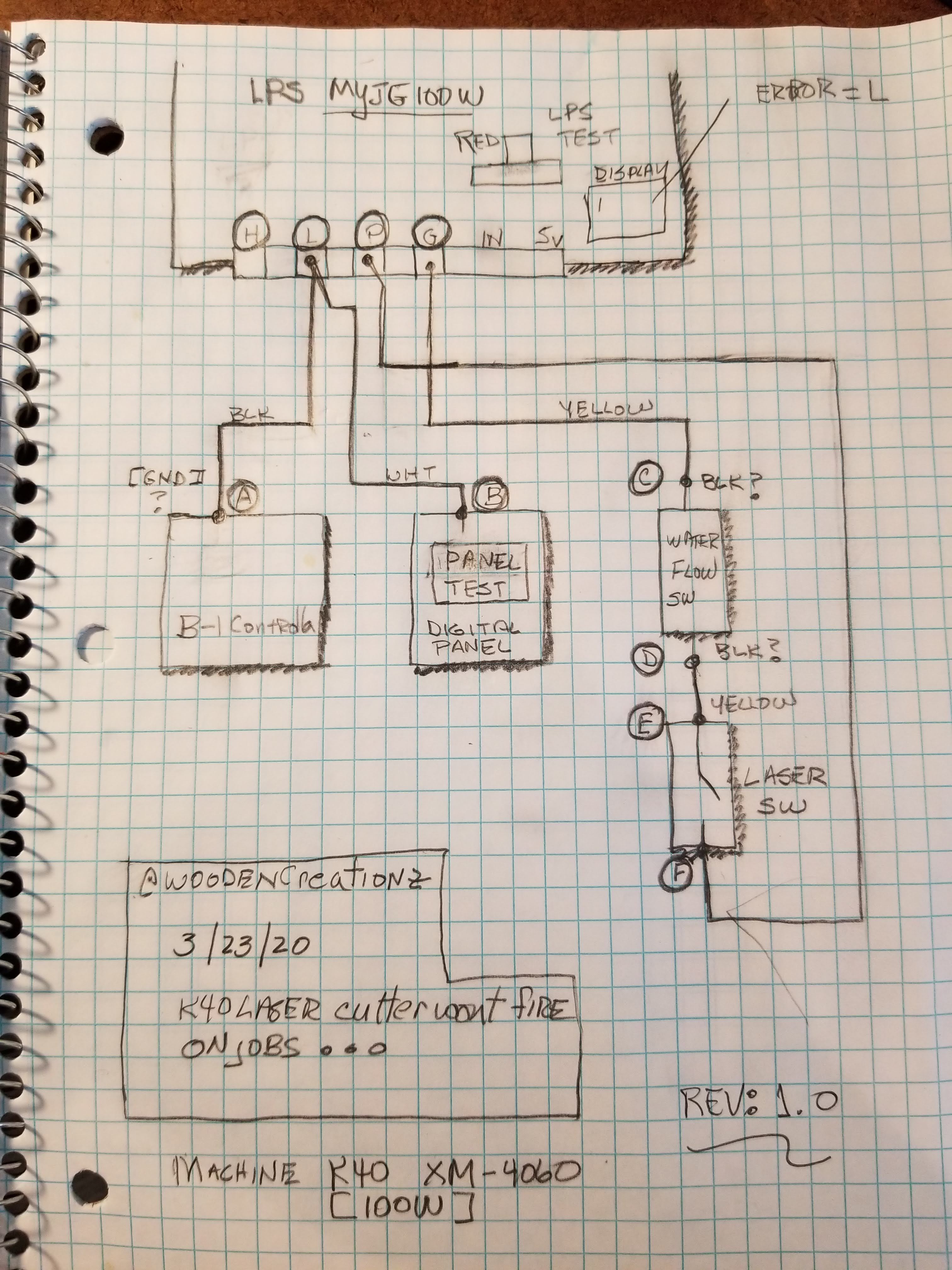

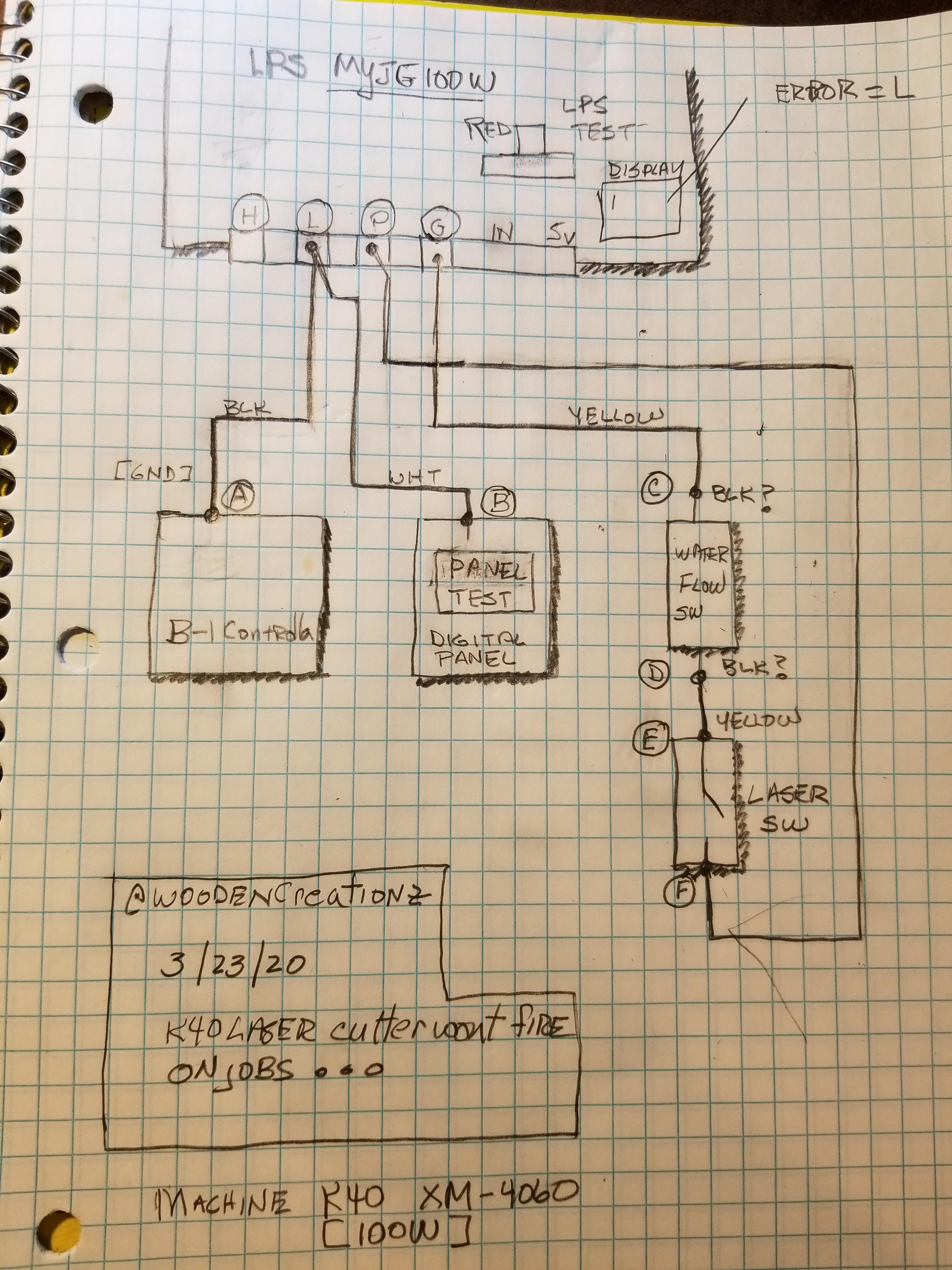

I created this drawing to help us stay in sync and have clear set of reference points for the troubleshooting.
Do you think this diagram captures your machine correctly?
In the next post I will summarize what I think the tests are telling us and what to do next.
BTW: when you are answering a question and have the edit window open you can mouse out of the edit window and highlight the question at its source. A small dialog will open above it with the words ["Quote] in it. Click on that box and the system will insert that question into your edit screen. This will save retyping :wink:
With the diagram below let me first summarize how I think this machine should work and then we can continue troubleshooting. This will help us troubleshoot in sync.
The drawing has circled letters that designate locations in the circuit.
How it works:
L-A: this is the PWM signal coming from the controller. It is a low going signal that has the 1-0"s intelligence that control the laser on-off during cutting in a job. This should normally be high (5V) when nothing is happening or the Panel Test button is not pushed. L-A cannot turn on the laser if the P connection is not at ground.
L-BL: this is the panel test button by providing a ground it simulates the L-A function being ALWAYA ON when pushed. [it’s strange that pushing the panel test allows a job to run correctly it should just keep the laser on?]
P-G: this is the interlock circuit. When P is not at ground the laser will not fire. This means that the water flow switch and the Laser switch need to be shorted (0 ohms) for the laser to fire. When either the water flow switch or the laser switch is open P should be high (5v?).
G: is the ground reference for the LPS control circuitry.
IN: is the power level control and it should vary from 0-5 V as controlled from the digital panels power % functions.
5V: this is the supplies control voltage and should be a constant 5V when the machine’s power is on.
Anything sound or look wrong?
With this level set, in the next post I will continue the troubleshooting discussion.

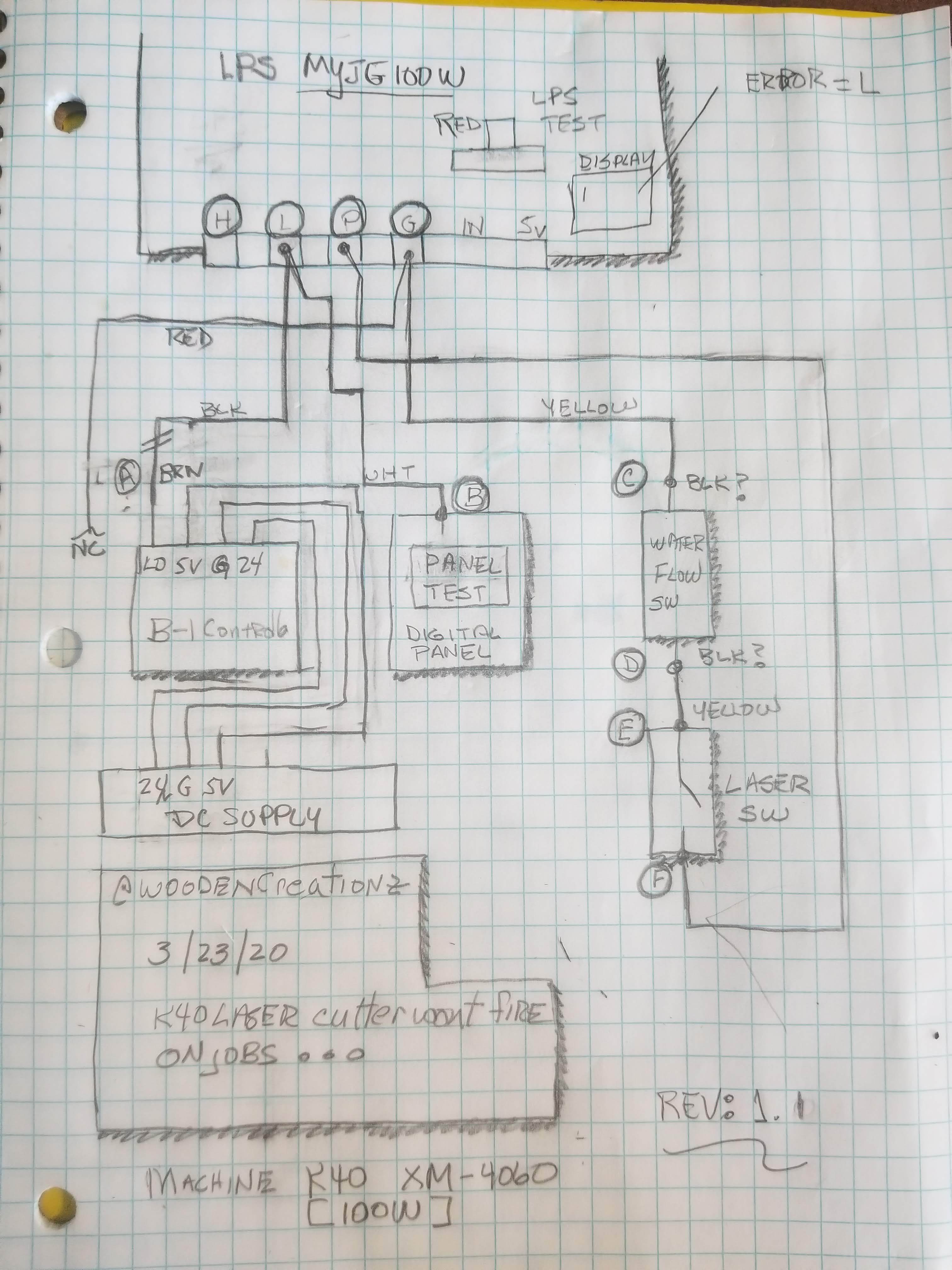

Don,
This diagram is exact to my system. Thank you for taking the time to make it so we all better understand. Give be a few minutes here and I will get you the results from testing the laser again correctly with the multimeter. I too questioned why the black cable goes to grnd on the controller board. I belive that to be a wrong statement as it is going to 5v. The wad of cables is in Cable wrap. And it’s that plug that the black cable is in. I have added the picture of its setup. Test coming very quickly of the water flow sensor.

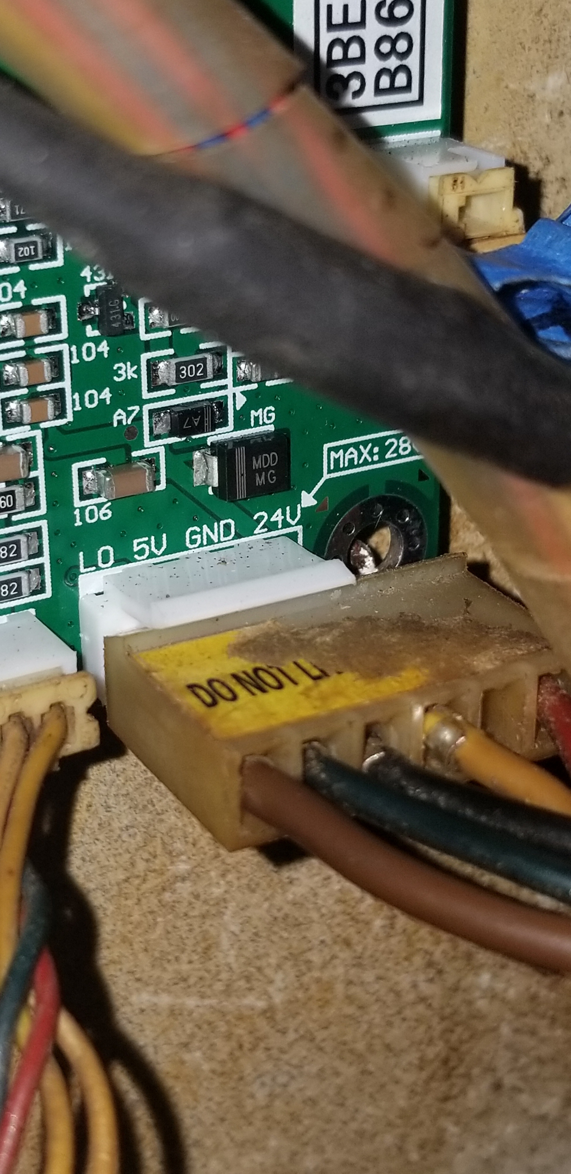

I assume with this picture I am looking at the controller connections.
  1. Previously we said that the L-A wire was black. The LO wire (which should be A) on that controller picture is Brown???
  2. That connector looks strange in that it has more pins than the controller. There appears to be a red wire not connected to anything. What is it?
  3. Where is the 24 v coming from as the LPS does not have 24V?
  4. What is the history of the machine has it been modified from stock?

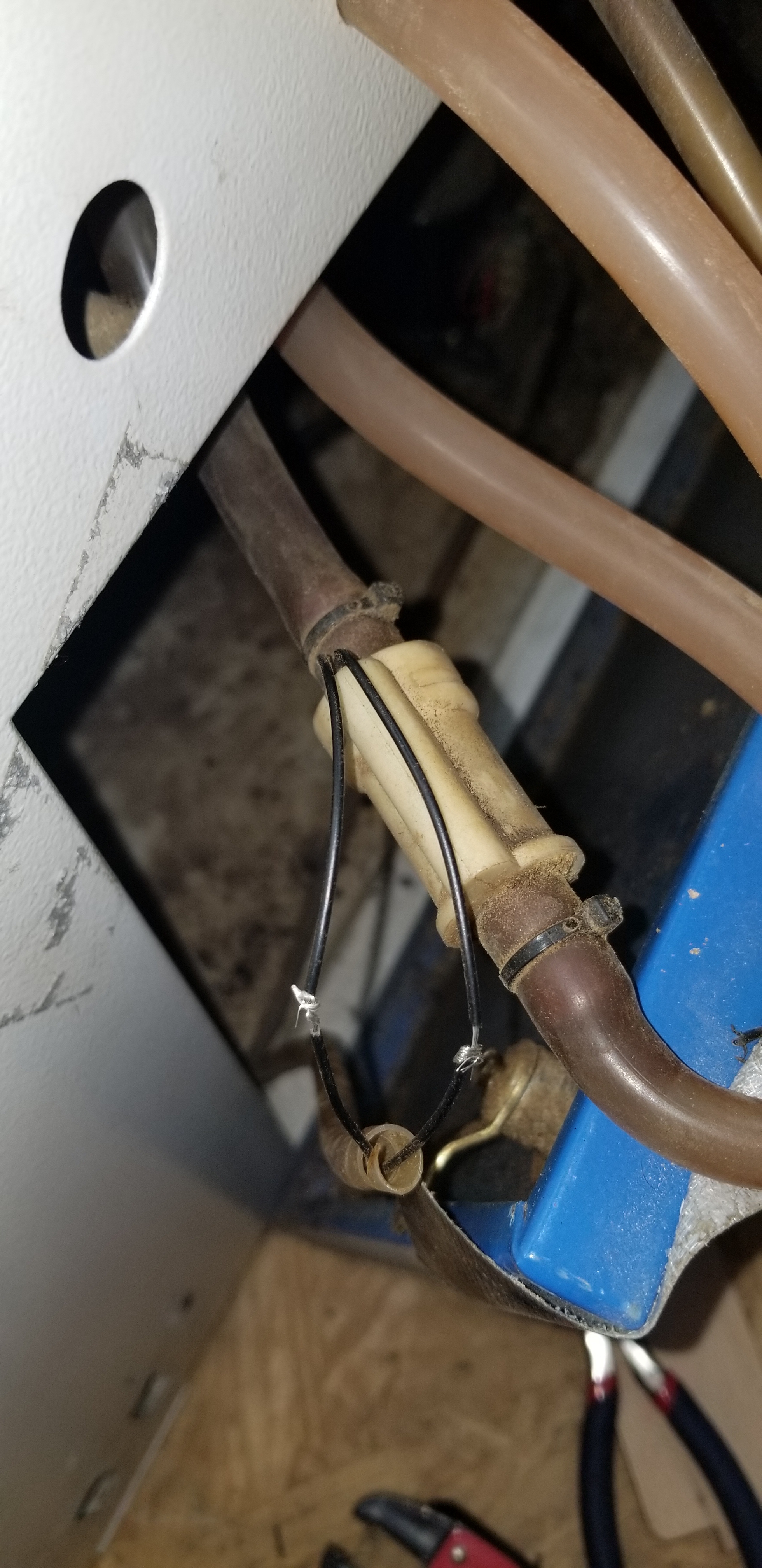

Also I have tested the Water Flow meter by cutting both black cables and testing with the Multimeter. When water flows it does provide feed back in the multimeter (Numbers change)
Video proof of this. But now when I soldered the wires back on… the Chiller still reads LL. As if its not seeing it, because it was giving me a degrees of the water temp. I have reversed the cable ends and soldered them back opposite… Still shows LL on the chiller… It is pumping water, it is NOT setting off the alarm and the Normal light is lit up green. I have ordered a new water sensor and will be delivered Tuesday so I look forward to replacing it defective or not im ready to get past this “L” error
Please refer to the picture. I have all the cables labled from the controller to the LSU to the metal box. Again all cables were unwrapped and followed one by one to be sure.
No clue why they connector is longer than the pins given. Thinking a larger board must have been on it at an earlier time. The RED cable goes to G (Ground) on the LSU. Again its been like that for 2 years no issues.
Please refer to the picture. The 24v cable goes to a metal box in my laser cutter along with the Blue and Black cable. You would likely know more about this box than I would. And could this possibly be the part that bad? I have not seen any numbers on it so I can research it more.

Here is the drawing with the wiring info you provided added.

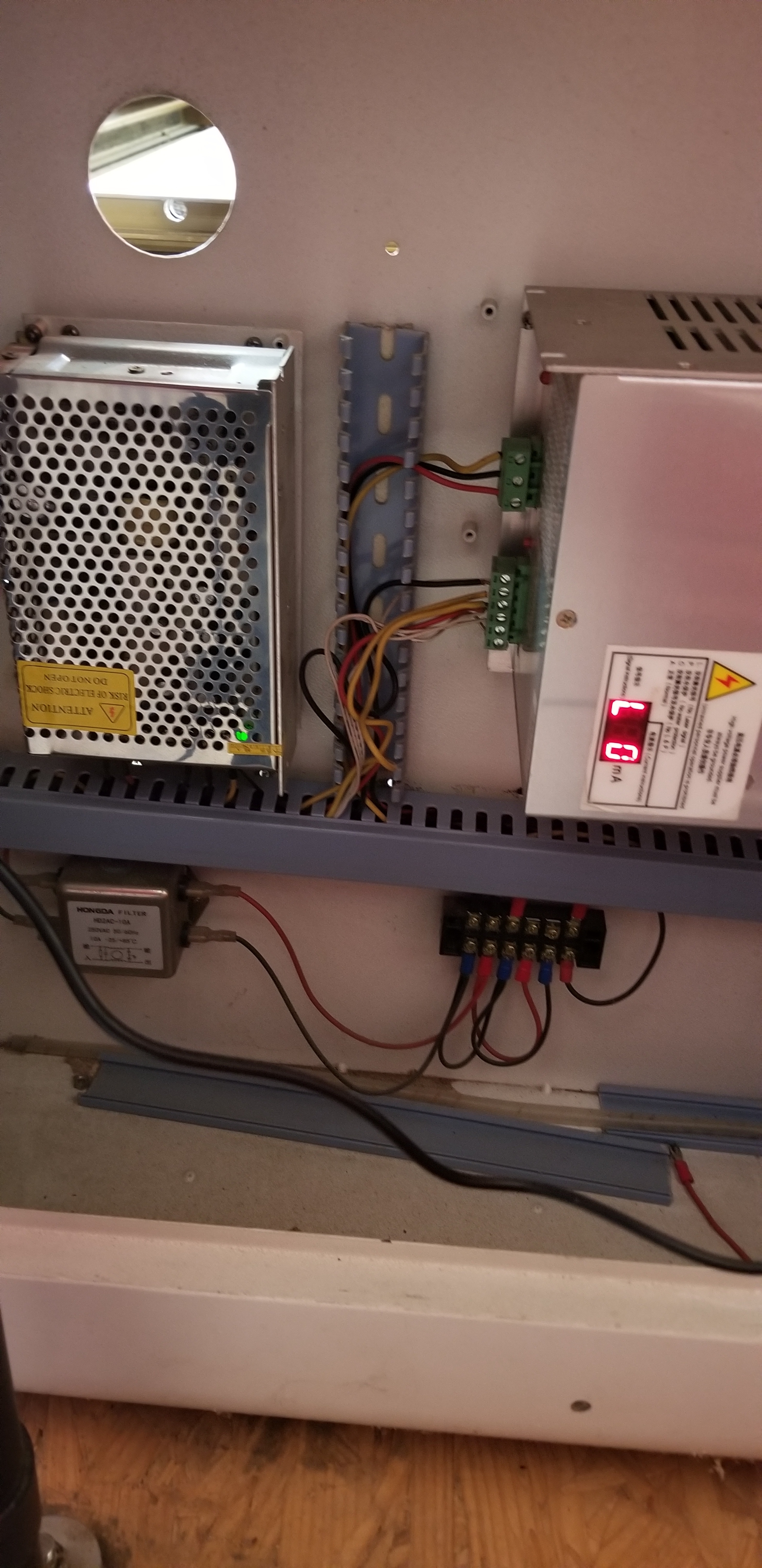

That is the DC supply providing DC power to the machine. If it was bad nothing would be working.
We can verify that by measuring:
  1. the Voltage with a DVM on the 24v pin and ground.
  2. the Voltage with a DVM and 5v pin and ground.
I still think your problem is related to the L input on the LPS and I am still doing some research on that connection… stand by.
This notion just dawned on me while I was looking at the LPS input circuits:
Up until now, you have reported that the machine will CUT with the panels’ TEST button pushed.
We learned from the wiring diagram that the TEST buttons function connects to the L of the LPS as does the job signal from the controller.
If the TEST button is held asserted that holds the L pin low (on). Would the machine cut correctly since the laser is on and the carriage is moving??? Cutting might work but every other type of job would not?
We can test this by running a non-cutting job and see if it works correctly with the test button pushed.
1. Try doing an engraving while holding the TEST button-down.

I have received and replaced the Waterflow Sensor. Its been rewired and the chiller now sees a temp again. Next, I received and rewired a strand of wires that go to the controller board that control X and Y… Every wire literally fell out of the cable connection from all the testing… Thursday I have a new cable end coming to rewire the L signal wire. The female “L” signal wire is worn out and wants to pull out of the cable end and the other wires in this cable end are bent from all the testing… I am totally with you on getting this dude up and running… Give me a few more days to have a this connection fixed and see if the new cable or the new water flow sensor has resolved anything. I have a new power supply on order from aliexpress. I requested 5 day shipping but its looking delayed and I cant get one here any faster. Again the power supply may not be the issue. But give me a couple days here to give you accurate results with new cabling and a new water flow sensor.
I have added the last thing I was able to laser as it slowly died (Before I reached out to you). Ignore the top left corner. I was test firing (As test firing still works on test panel and LSU test button)… But you will notice the laser lost more and more power until it stopped cutting all together.
Again, adding some picture of the cable ends that are falling apart. New wiring is the new connection replaced, chiller now reads temps again after waterflow sensor, new waterflow sensor installed, and pic of last thing I was cutting when it died.
