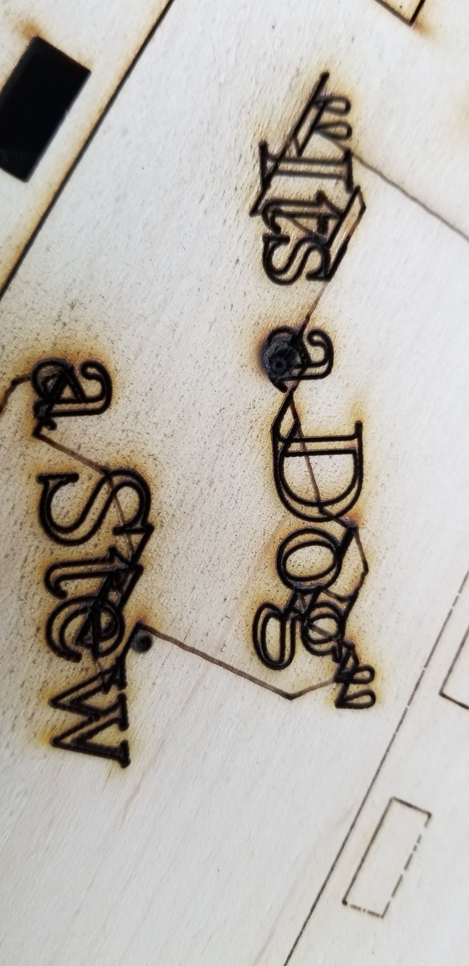

You had asked what happens if I tried to engrave instead of cut. You had instructed me to hold the test button down as it moved around. Well it engraved… It also drags the firing laser everywhere… It doesnt shut off when it crosses words… But it will engrave and it will cut with no issue on either test button.

Since it cuts and engraves properly (except the lines between moves) with the test button pushed these subsystems must be working. Otherwise, you would not get these results.

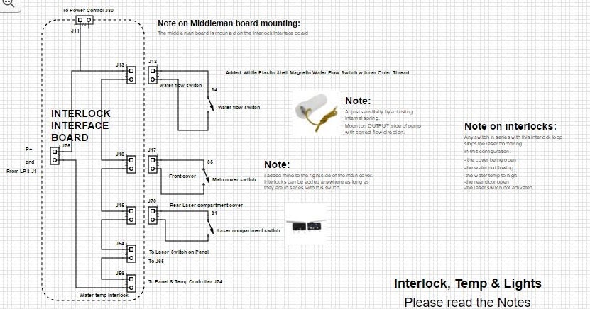

  1. Does the Rev1.1 schematic (post above) still reflect how the machine is now wired?
  2. The test switch connection to the LPS-L comes from the digital panel correct?
  3. What pin on the digital panel does the wire connected to LPS-L come from? Please provide a picture of that connection.

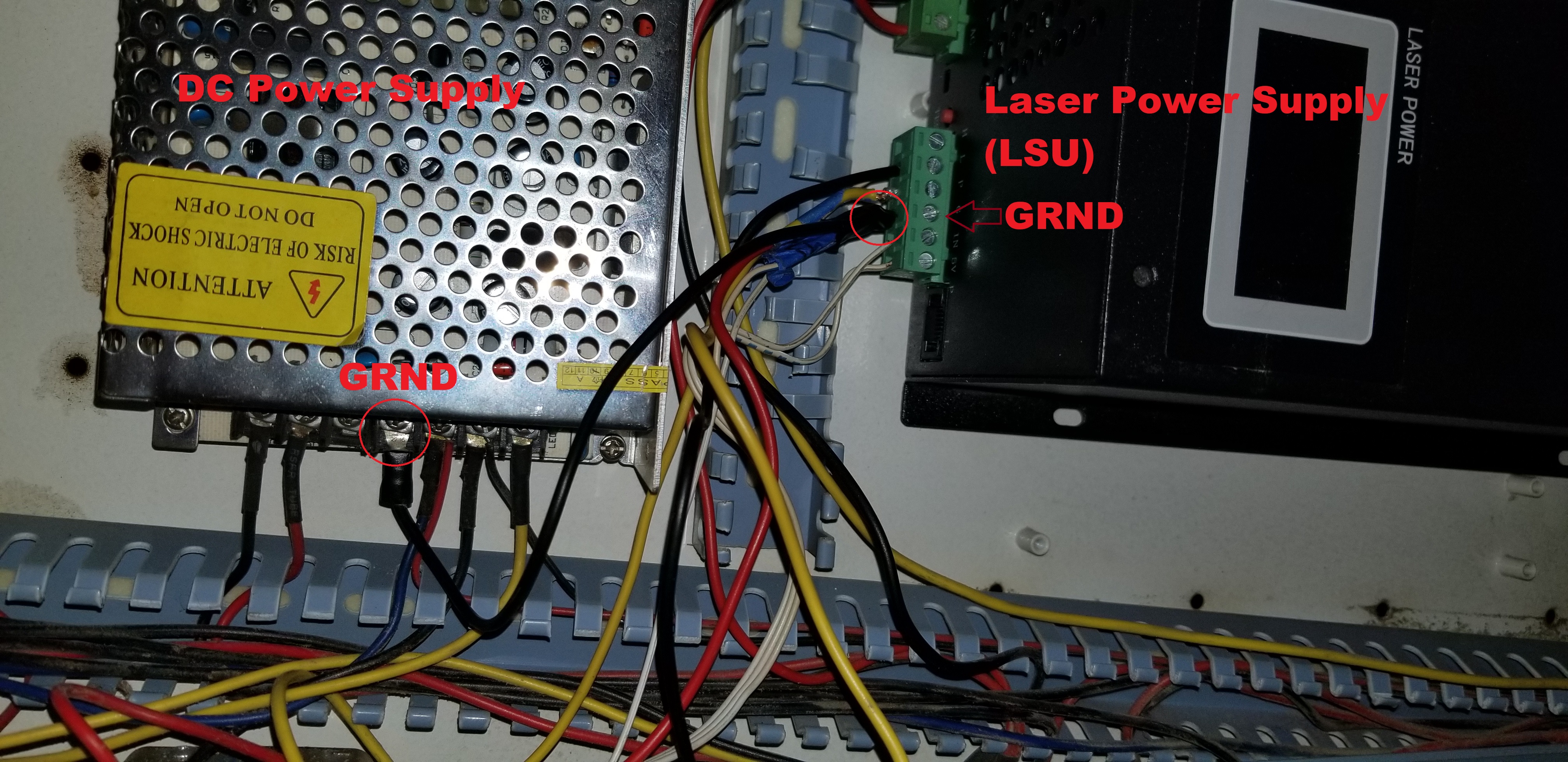

Don, Happy Easter!!! And the laser cutter is now fixed. It was a grounding issue. I would love to take credit for solving it, but my buddy Scorch_works and I worked through your tests and he determined it wasn’t properly grounding.
The issue: Grounding (How did I test for this.)
Using the voltage meter Red Positive Tester (+) to LSU GRND. (-) to Metal Laser Housing Result = .00
Using the voltage meter testing (+) to DC Power Supply GRND. (-) to Metal Laser Housing Result = .95
The (LSU) Laser Power supply was not getting a good ground and gave a read out of .00. I powered off the laser, unplugged it. Then connected a scrap wire from LSU Grnd to DC Power Supply Grnd. Plugged it in, powered it on. The laser now Cuts, Engraves with zero issues, just like brand new. 100% functional again. All jobs fire the laser correctly now.
Things to note… for people in the future having the same issue and reading this. I did use a dremel to grind off all the paint on the inside Metal Laser Housing Grnd terminal (screw) which is located in the back of the Laser cutter. I also made sure the ground wire had a solid metal connection to that bare metal. With that said… I had read laser cutters having grounding issues on past forums thus why I tried this. But you may run into what I did and find a Power supply not getting a good ground. Which is kinda crazy because the 220v outlet has a 3 prong with ground so you would have thought it gets a ground there. Again if your having it test fire perfectly but wont fire on jobs. Test the Grnd on both power supplys to the metal housing case and you should get a read out of .95. If not, you dont have a ground to that power supply.
Don… Being its solved… There is little point in rattling off voltages of all the pins. But you may stumble over them in the future and this may be helpful for someone else. These are the readings before the system was properly grounded and fixed.

Then it was determined it was a Grnd issue at this point: (Note I had to scratch off the paint to do this test. You have to hit bare metal on your laser case to ground)
Voltage meter on LSU GRND to Bare Metal laser housing while running a cutting job = .00
Voltage meter on DC POWER SUPPLY GRND to Bare Metal laser housing while running a cutting job = .95
At that point it was determined both grounds were not equal and both be .95 and LSU was not grounding. So a wire was connected from LSU Grnd to DC power supply Grnd. Then everything worked.
Don, I want to thank you for you weeks of work and patience. Man I greatly appreciate it and would like to donate money to your beer fund. Just let me know how I can do that. Paypal, Patreon, Raking Leaves, washing cars… :slight_smile: I attend a lot of wood working conventions and get together’s and would like to shake your hand one day… or maybe foot bump since we cant do that any more. lol Be safe and thank you. I hope you have a wonderful easter and I hope this was a good egg to find. And straight up thanks to Scorch_Works… That dude helps a lot of people on here as well. Thank you both for helping get my company get back on its feet and i am for sure indebted to you both. Thanks -Brian
Picture of spare wire I added to fix my machine from DC Power Supply GRND to LSU GRND.

…to be clear this problem was solved by adding a wire between the DC supply and the LPS grounds. This is not a safety ground issue but a logic power grounding one.
This means that the LPS and controller power were not both at the same ground reference making the L signal have a “wonky” [technical term?] ground reference. Likely the “test” button was indirectly providing a better reference when pushed.
@WoodenCreationz just for grounding hygiene I would ensure that your controllers ground is connected directly to the DC supplies ground.

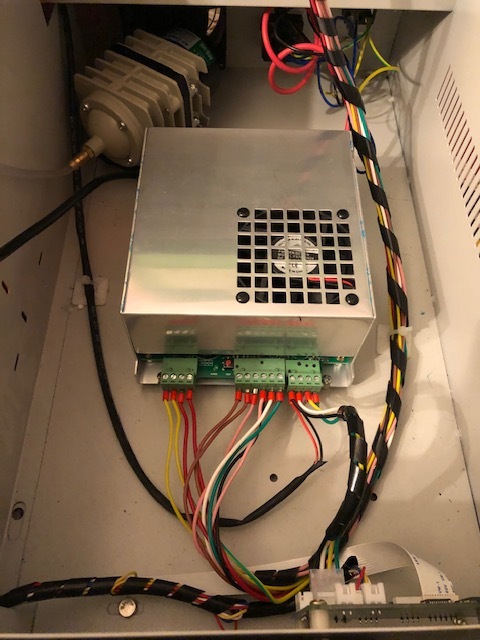

Hi guys. I appreciate all the time and effort put into this very informative thread, and thus the knowledge created to provide solutions. I’ve been stuck for over a month with the exact same problem with my first K40 and have followed this thread step by step with my multimeter.
Upon my consideration of trying the official solution, I noticed that my K40 doesn’t appear to have a DC supply.
This could be as my K40 is a version with a nob to alter the power rather than buttons and digital display like in this case - would this potentially mean a different solution, or is it still likely to be the LPS and controller power at different ground references?
I’ve attached images of the wiring/ hardware components, and the exterior controls. (Just 1 image now as I’m a new user).
Any comment/ word of advice would be much appreciated (novice when it comes to electronics).
Chris
Exactly what is your problem?
That supply should have a 12v and 24v DC output.

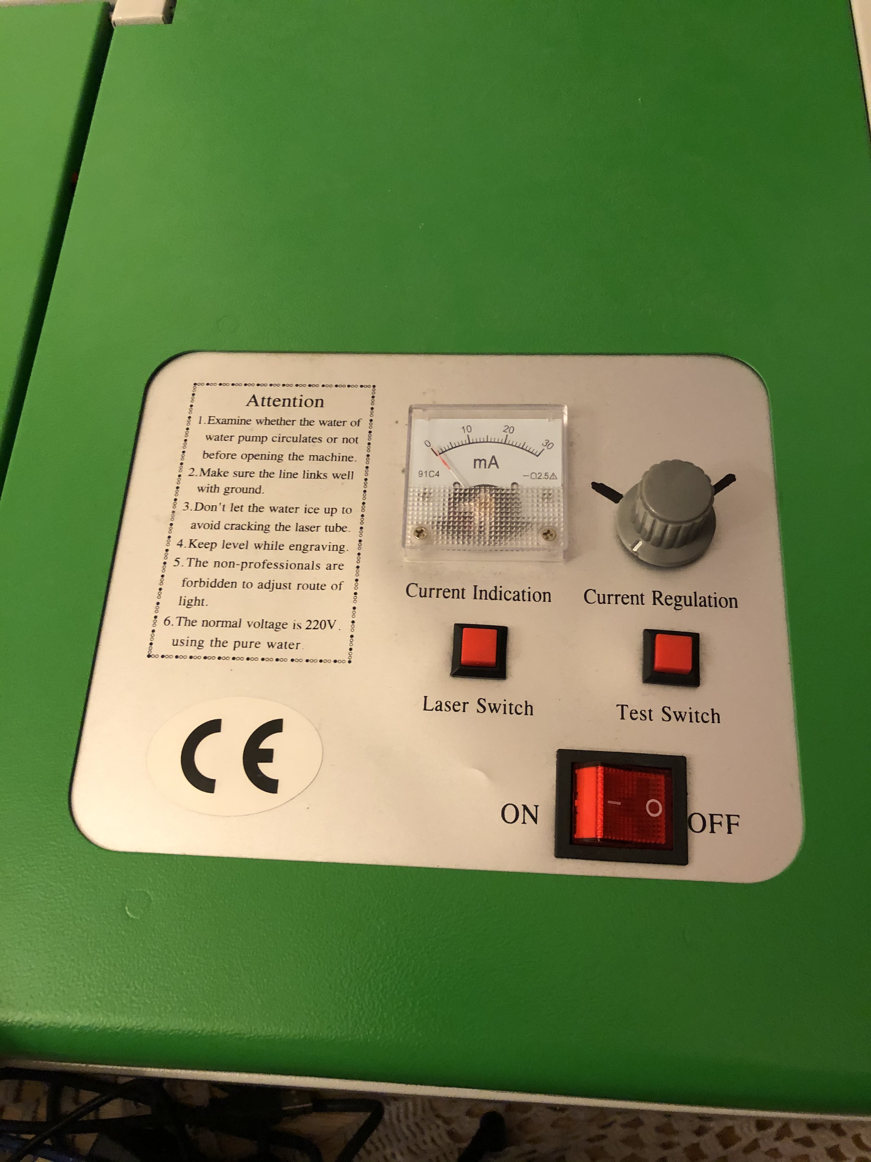

I assume you have the “Laser Switch” enabled/On when you run the job?
Does your machine have interlocks, water flow sensor etc?
Please post a picture of your control panel.
Yes, the Laser Switch enable is on when I run a job.
It doesn’t have interlocks nor a water sensor.

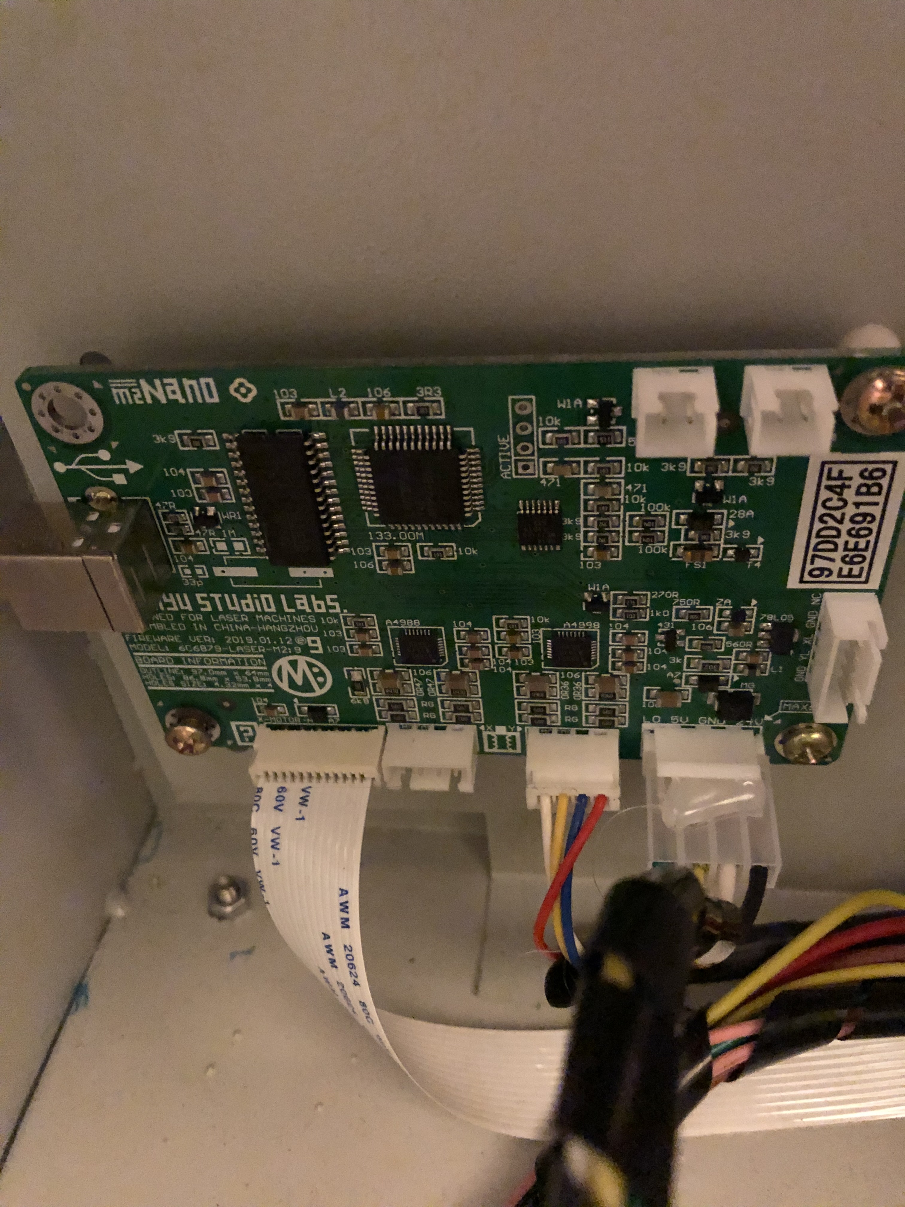

What controller is in the machine?
Try this;
Power off
  • Disconnect what is on L (the rightmost connector). Should be coming from the controller.
  • Connect a jumper to L that you can touch (short) to ground
Put Laser glasses on
Power ON
  • Laser Switch to ON
  • Touch the jumper on L to ground.
    Caution: THE LASER SHOULD FIRE!
Here’s a picture of the controller:
