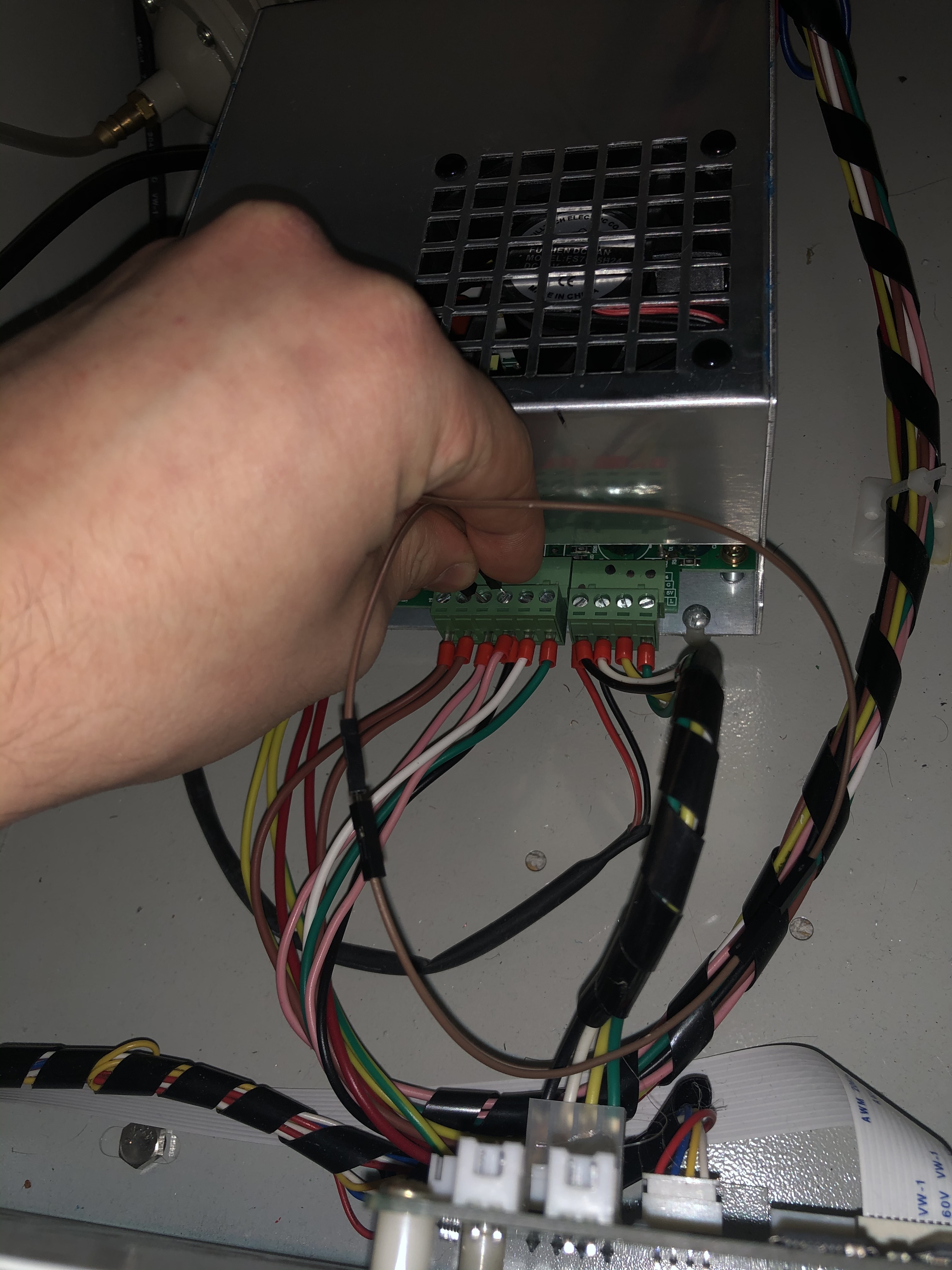

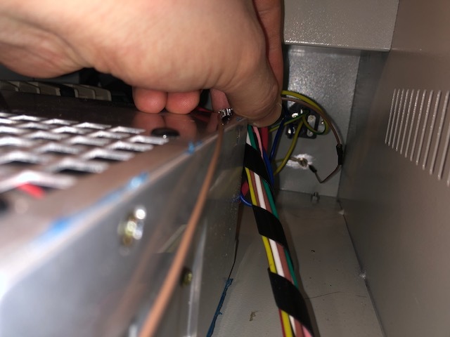

  • with the other end of the new jumper in L, I touched ground at 3 locations with the power & laser switch on:
    IMG_4704
  • I tested the new jumper for continuity and this was fine so I suspect it isn’t this?

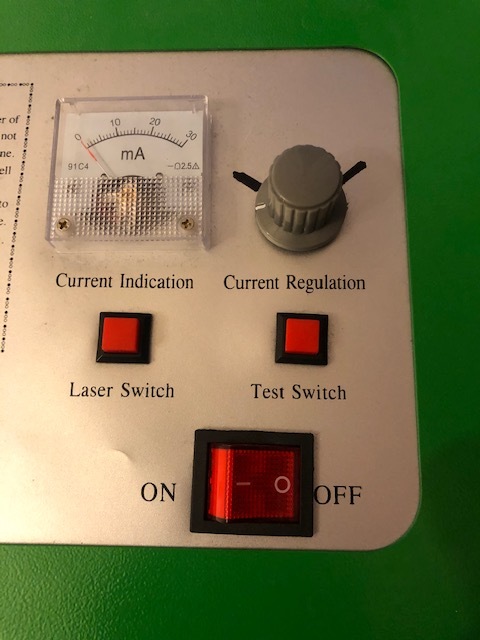

Also I just noticed in your panel picture the POT was at its minimal position.
Has it been in that position for these tests?

The marker pen is just to show min and max power for the POT.

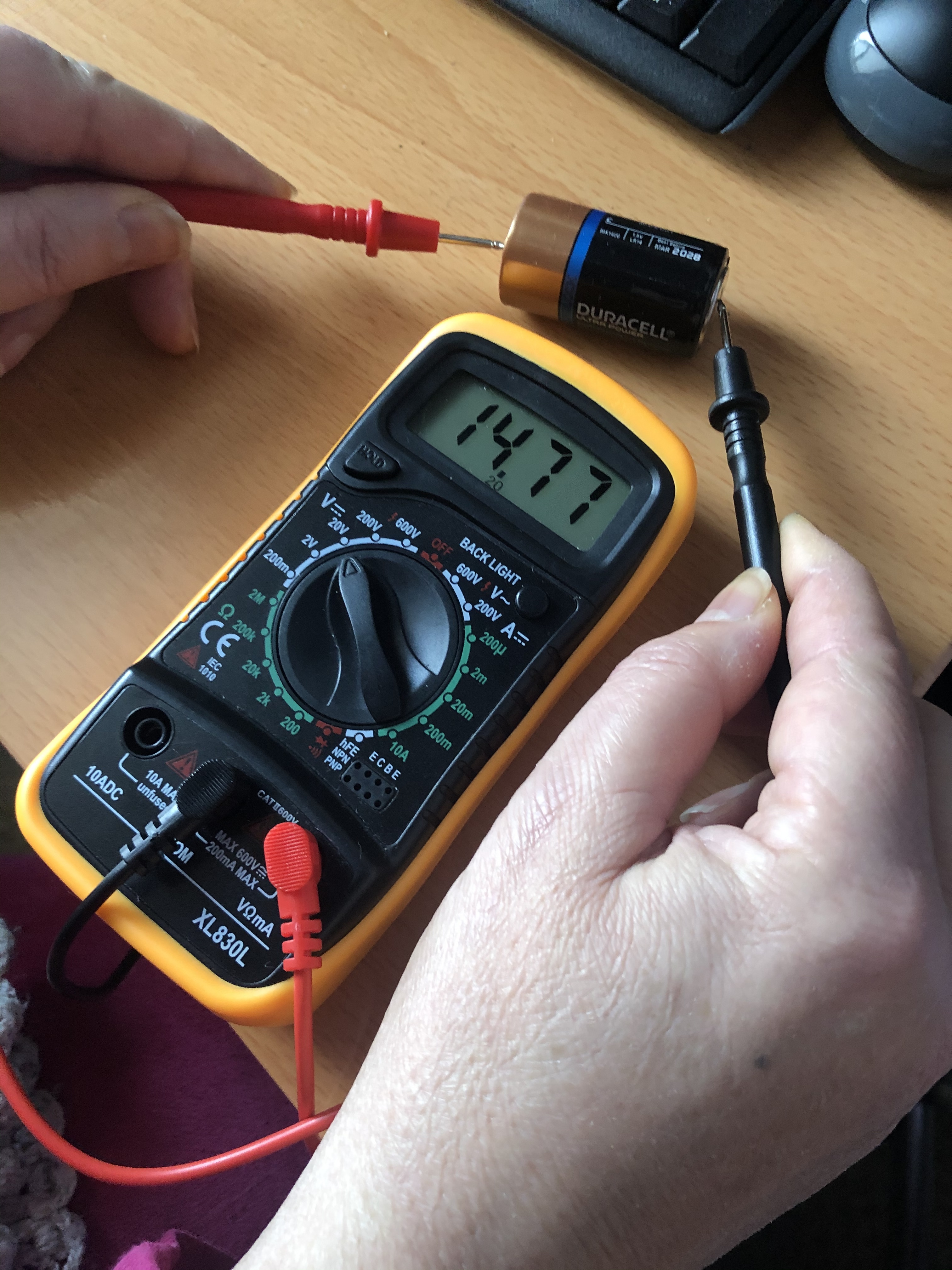

Can you measure a 1.5 volt battery with that meter?
Turn your POT to max and then see if the laser fires with the Laser Switch = ON and the Test Switch button.
Sorry, just realized I was using the ground on p3 & you said not to bother with as its AC. Should I use the ground on P1 or P2?
  • Yes:
    It maxes out and shows “1” when I put the DVM down to 2V.
  • Just turned the POT to max and noticed something strange, it doesn’t seem to fire at all at max, seems fine from 0%-50%, but then the strength of the laser seems to decline from 50%-100% where is doesn’t seem to fire (was making dots on some wood to judge this). I tried to attach a video but it was too large - the mA dial moving all the way from left to right at lower power from the POT, but moving less as I increase the power - seems things could be the wrong way round here?

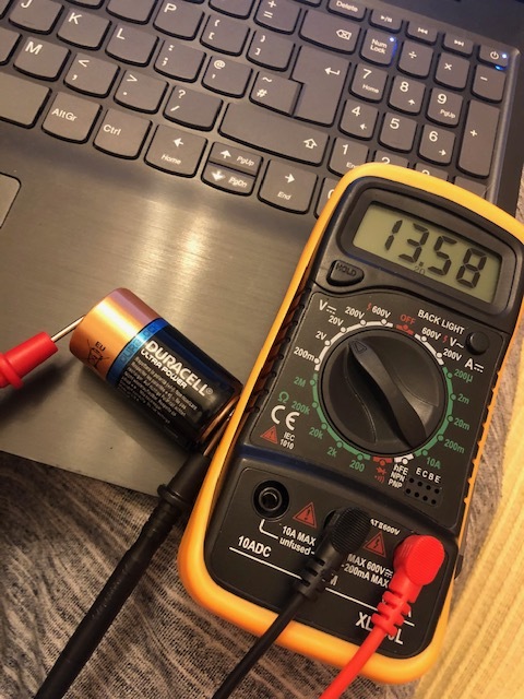

Something still wacky with the meter readings:
  • Across the battery and on 20V scale the voltage reads 13.58 volts. Perhaps the battery is 1.38V and we have some scaling problem?
  • Across the battery and on 2V scale the voltage reads 1 (which usually means overrange and voltage is >2V vs 1.5V ???)
I looked at the manual for that meter and nothing seemed weird!
We need to get good readings on the battery with that meter before we can trust the next tests.

I suspected a scaling problem, as 2 other equivalent batteries read 13.98 & 14.21 … maybe the decimal point should go left 1.
Yes the voltage reads 1 across the battery on and on 2v scale, strange I know, when I push it up to through the scales the assortment of numbers stay similar while decimal point moves right, so maybe just weird scaling?

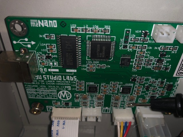

Usually when something is this wacky I start looking for ground problems.
Check this:
Is the ground in the LPS connected to the ground on the controller. (i.e. 0 ohms)?
Make sure you measure from a G pin on the LPS to a ground point on the actual controller PCB. Do not trust the PCB connectors.
No worries I appreciate your help!
All correct
Right, I get the logic. Strange how connecting P1-1 to ground doesn’t fire the laser when it does go to ground.
I measured from both P2-3 and P1-3 to what I think were ground points on the PCB … are these the small metal bumpy bits? My DVM showed 0 ohms. (see pic) IMG_4734
Hard for me to tell if those are ground. The metal case for the USB connector and the metal rings under the mounting screws should be.
We need to go back and figure out why your meter is not working properly.
We must have some wrong assumption somewhere.
Understood, I measured for resistance touching the metal USB casing & it came back with 0 ohms
It is strange I’ll show you the readings for the battery as the scale increases:
  • all I could see online were some people’s DC readings showing double, I flicked around with the different settings for my DVM and the readings are still weird for batteries, I could order a more expensive one on prime for next day delivery (although the relatively cheap one I have has thousands of good reviews)
  • I’ll go back and check through the steps again to see if there’s a wrong assumption somewhere
Wow, that looks amazingly defective. It’s really disappointing when you so manifestly can’t trust the testing device. :sob:
I hope that’s still under return or at least warranty.
Doesn’t look good :frowning:
I have a few pretty inexpensive ones and I am very happy with them.
