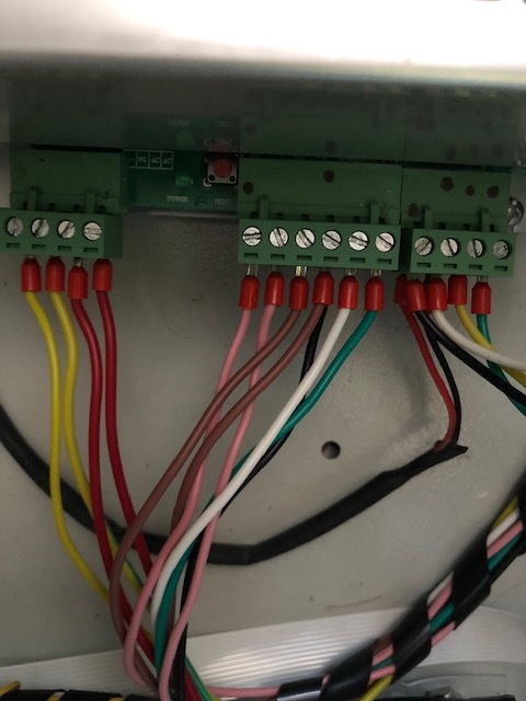

Having a hectic few days so just been able to get back to this, thanks so much for the continued support.
- The jumper did not cause the laser to fire, it’s a decent size about 10 inches.
- The wires actually go to the laser enable switch
- Also the new DVM seems to work fine (see 2nd pic)

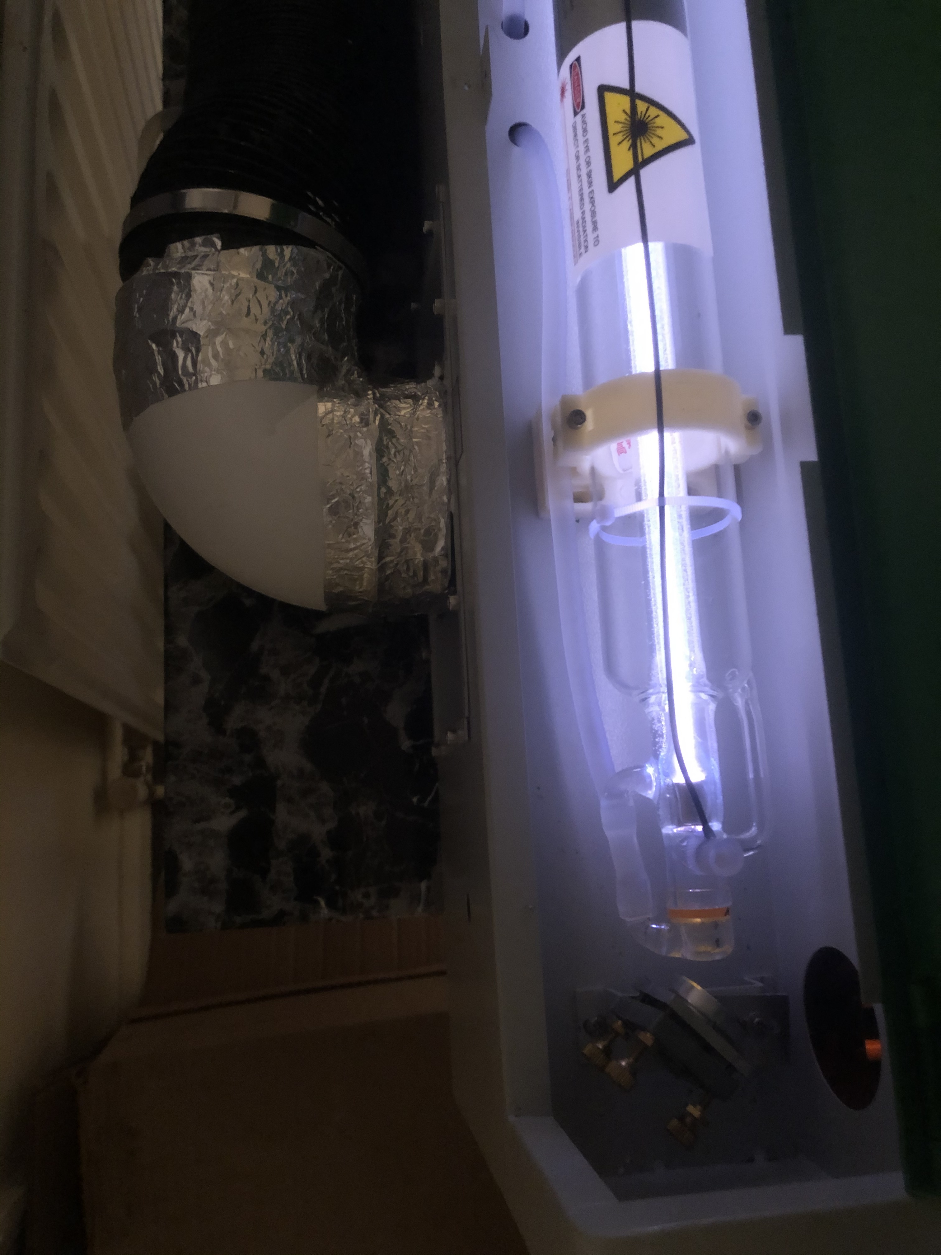

- I’ve just tested your 2nd situation from your latest reply, it was true. Ran a job with Laser Switch ON … I pushed the Laser Test during, and the laser fired only when I pressed it … It didn’t seem to leave any black lines though, I knew it was firing as per the tube area & top right corner lighting up when I pressed the “Test Button”. Strange, as the laser makes dots anywhere in the cutting area while static.

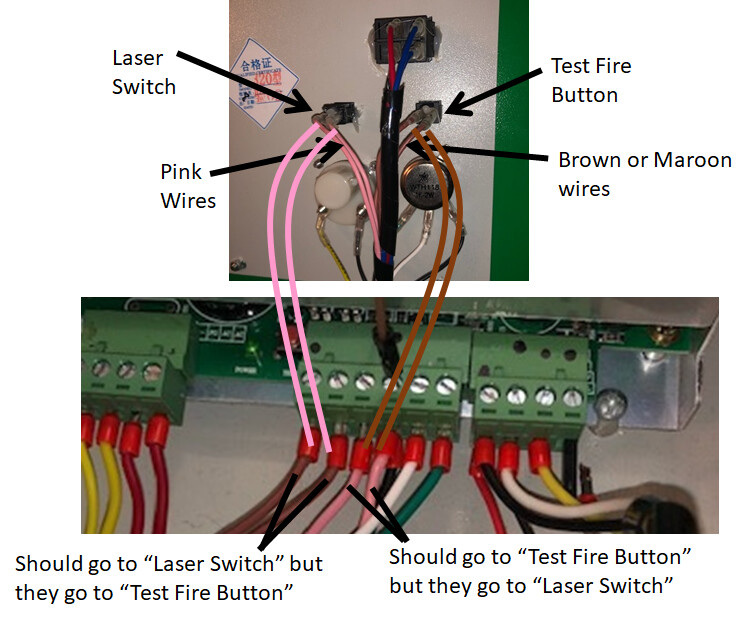

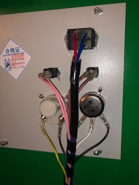

@crowland186 It does look like your wires for the “laser Enable Switch” and “Test Button” are going to the wrong switches respectively. I believe switching the pink and brown (not sure of the actual color) wires will fix the issue you are having with your laser. Pics below
A potential fun experiment you can do before you changing the wiring:
It would be interesting to have you turn the “Laser Enable Switch” OFF and hold the “Test Button” down when you run a job. The laser should fire under control of the controller board if you do that.
Below are your pictures with some wiring annotations.
Finally the next image is a version of Don’s wiring picture from above with the relevant items boxed as a cross check.
Bang you got it! Nice eye @Scorch!
Wow! did we get dizzy…
This suggested to me they were wired backward …
I interpreted this as “it’s wired correctly” and in sequence, it clearly says they aren’t!
This is why we should always ## the questions and answers :).
@crowland186 I would swap the wires and I’ll bet we are done.

- I’m wondering whether as the head moves, the alignment could become slightly ‘off’? I examined the inside of the laser head and couldn’t see any obvious etch marks.
- The laser now DOES fire on a job (see the vid), but without seeming to leave any mark.
- The POT still seems to work backwards, with the mA dial moving less and less as I increase the power, while at 100% power the laser doesn’t seem to make a mark at all.

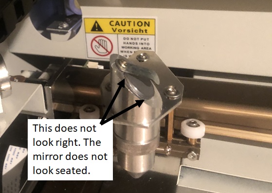

If it doesn’t exit the nozzle during movement I have to wonder whether something is loose.
Is the spring holding the mirror onto the laser head secure? It’s not obvious to me from the picture whether the mirror can move.

@mcdanlj I think you are on to something, that mirror looks like an Instagram star on a cliff (about to fall off).
