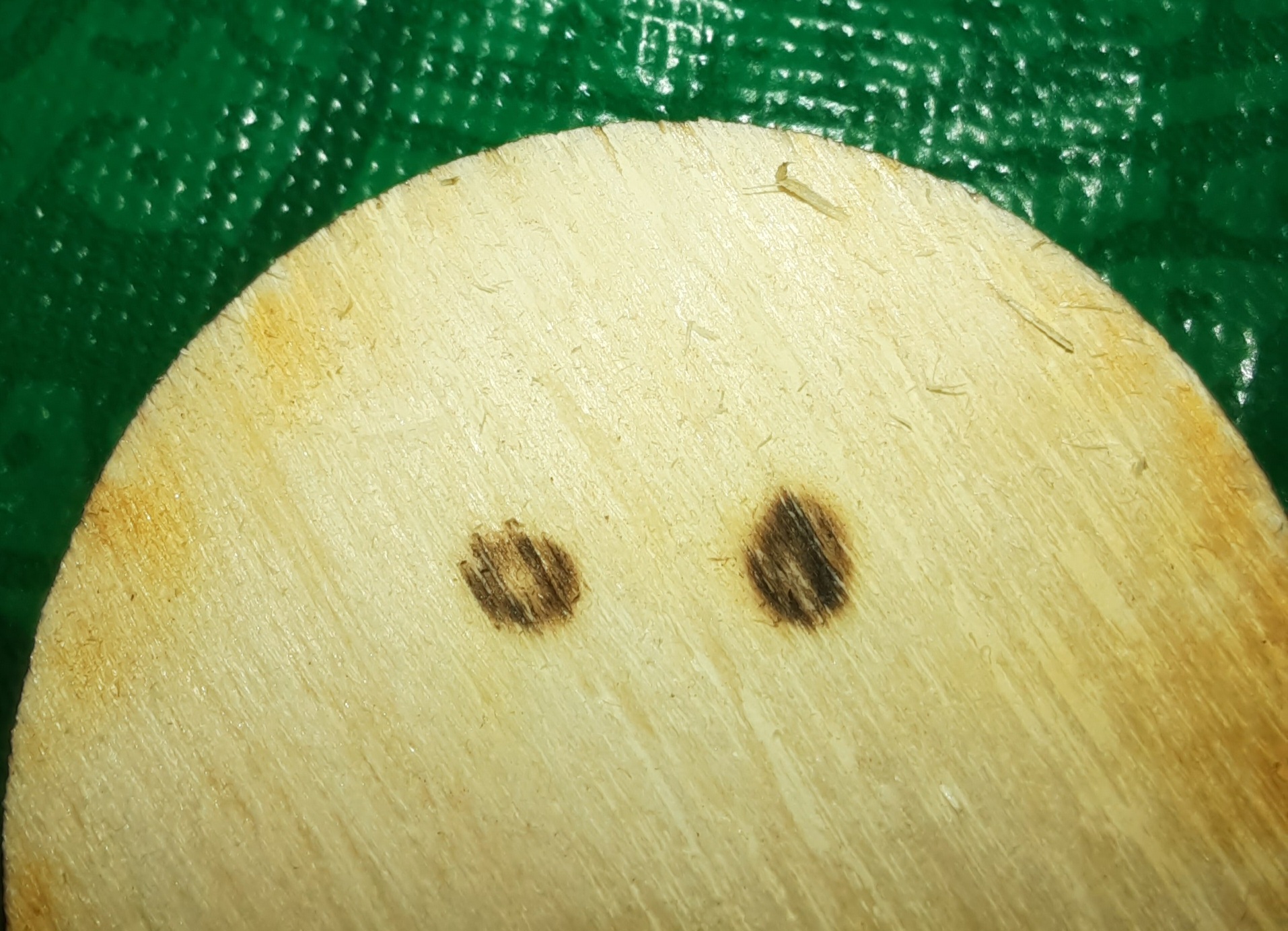

Put a card or tape in front of your first mirror (but don’t have it touch the mirror!) and test first just enough to scorch it.
Then take a picture of the card and post it here.
To see other examples, you can do a search using the magnifying glass icon at the upper right for “tem01” — TEM01* (donut mode) and TEM01 are the two most common degraded modes for a damaged tube.

The laser won’t fire until 6% so it kind of cooked it. There is the o shaped mark.
OK, the O-shaped mark does look like TEM01* (donut mode). Sadly, this means that the tube has been irreversibly damaged. The K40 Intro that @dougl linked to has lots of information on how to extend tube life as well as sources of replacement tubs.

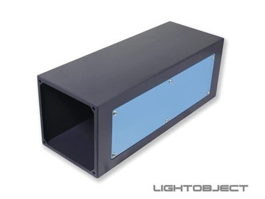

LightObject has a metal extension. You definitely want a (grounded) metal extension around the tube.
