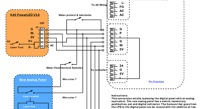

I don’t know whether you know this already but either in case you don’t¸ or someone else shows up with an interest in this topic after a web search for “k40 laser engraving slate” and reads this — Please be aware, if you aren’t already, that full power can wreck your tube quickly.
Do not rely on the digital display as an indicator of laser power. The digital display values are not accurate. Most machines reach the maximum recommended tube current (15-18mA for a K40; 20,000V * 15-18mA = 30-36W) at a maximum 40-50% setting. If you use more power, the tube will degrade very quickly. (New to K40: Start Here - Getting Started with CO2 Lasers - Maker Forums)
An analog ammeter is inexpensive and easy to add and will more than pay back its purchase price in tube longevity.

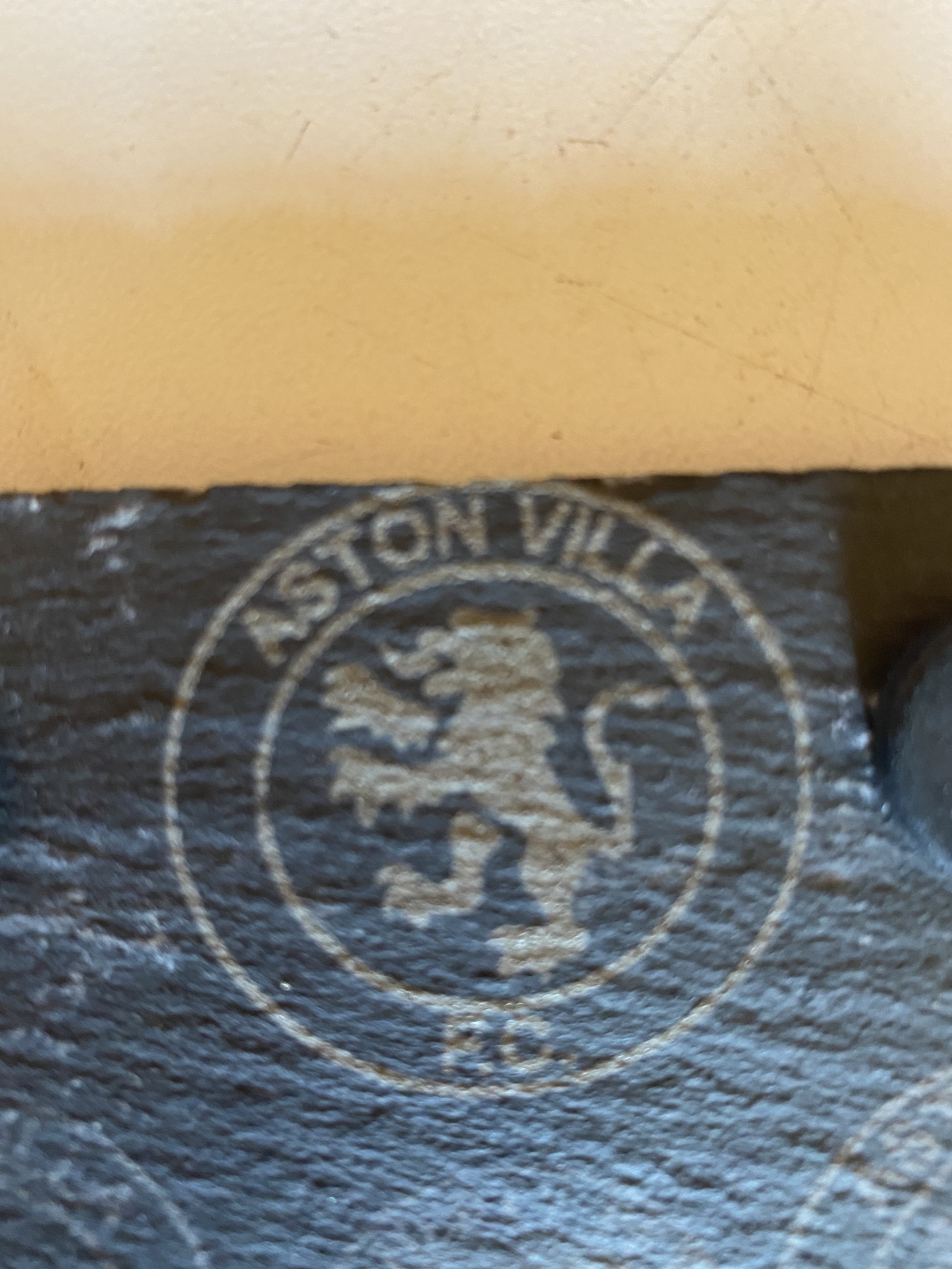

Thanks guys for all the assistance and replies so far. I got a B&W logo and tested it with a 35mm x 35mm engrave on the back of a slate coaster at 45% and speed 50mm/s and got this.
That looks better ! Although 45% still seems high to me. I max at 40, which is pushing 15ma on my K40.
