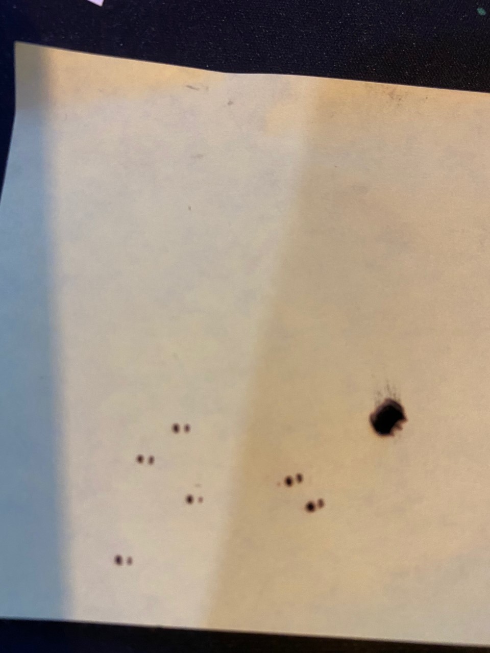

Hi ,first time posting here & I was trying to align the mirrors in my K-40 as it takes many cuts to do the same work as it use to (I’ve owned this thing for a few years now ) , but I noticed when i put a piece of paper next to the laser tube & between the first mirror & fire the laser i get 3 individual burns instead of one round hole . would this mean my laser tube needs to be replaced ? or any way to fix it ?
Hi and welcome to the forum. If you are getting a distorted or multiple spots that usually means the TEM mode of the tube has shifted to a higher mode. If that’s the case then you will need a new tube. If you can provide a picture of the test fire we can confirm.
This a few test fires between the tube & the 1st mirror .
Looks like a bad tube… @NedMan what do you think?
TEM-01
@copperhead did you have any kind of overheat event??
What coolant are you using?
How old is tube and how hard do you run it?
Yep, looks like you have shifted to TEM-01 like Don said. Common type of tube failure as your tube ages. I had to replace my stock tube after a couple of years because of this. Higher tube temps can lead to TEM failures.

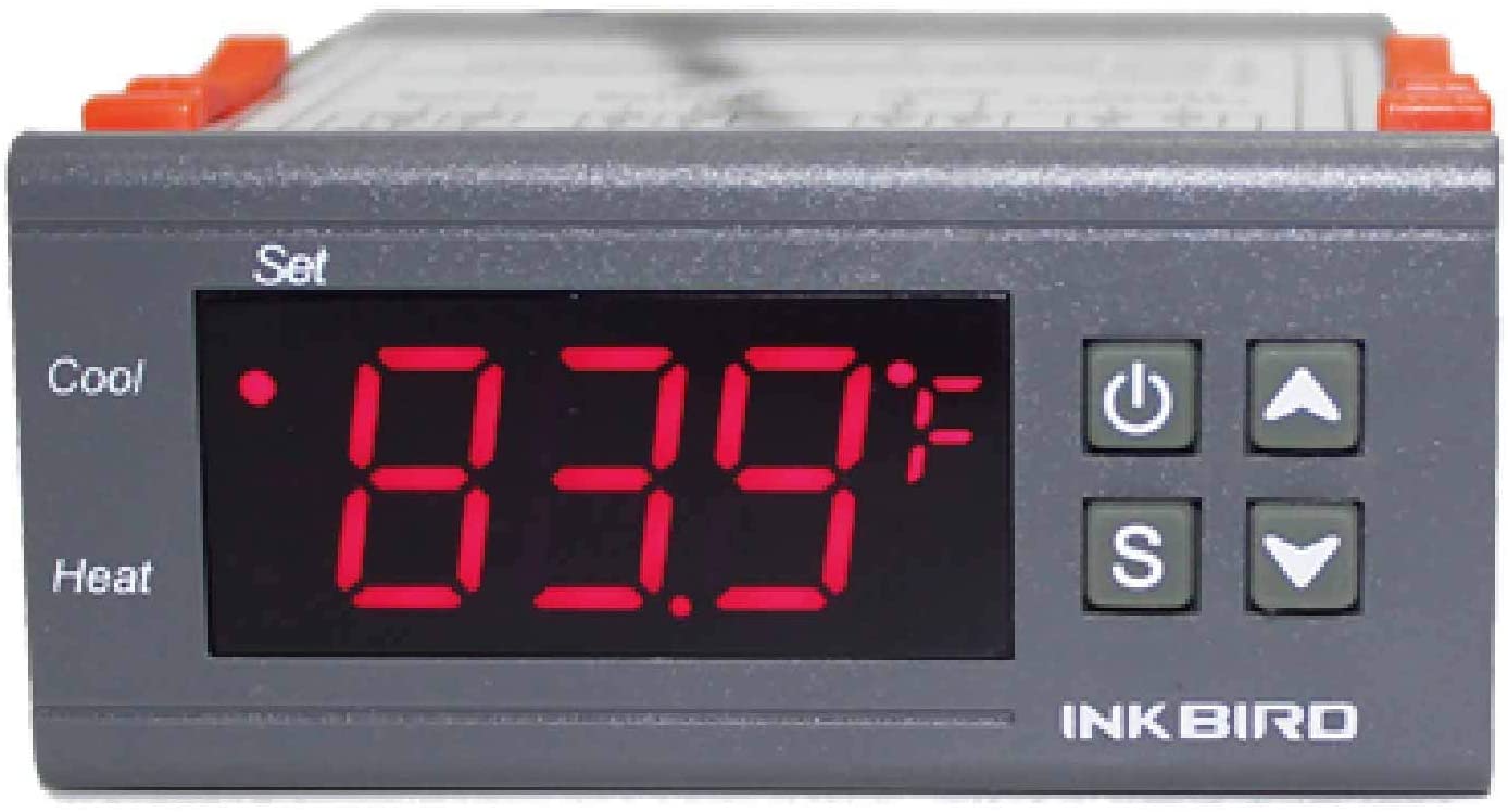

I suggest a water temp controller that will stop your laser when the set temp is exceeded.
I use this one and wire it into the water flow sensor circuit.
