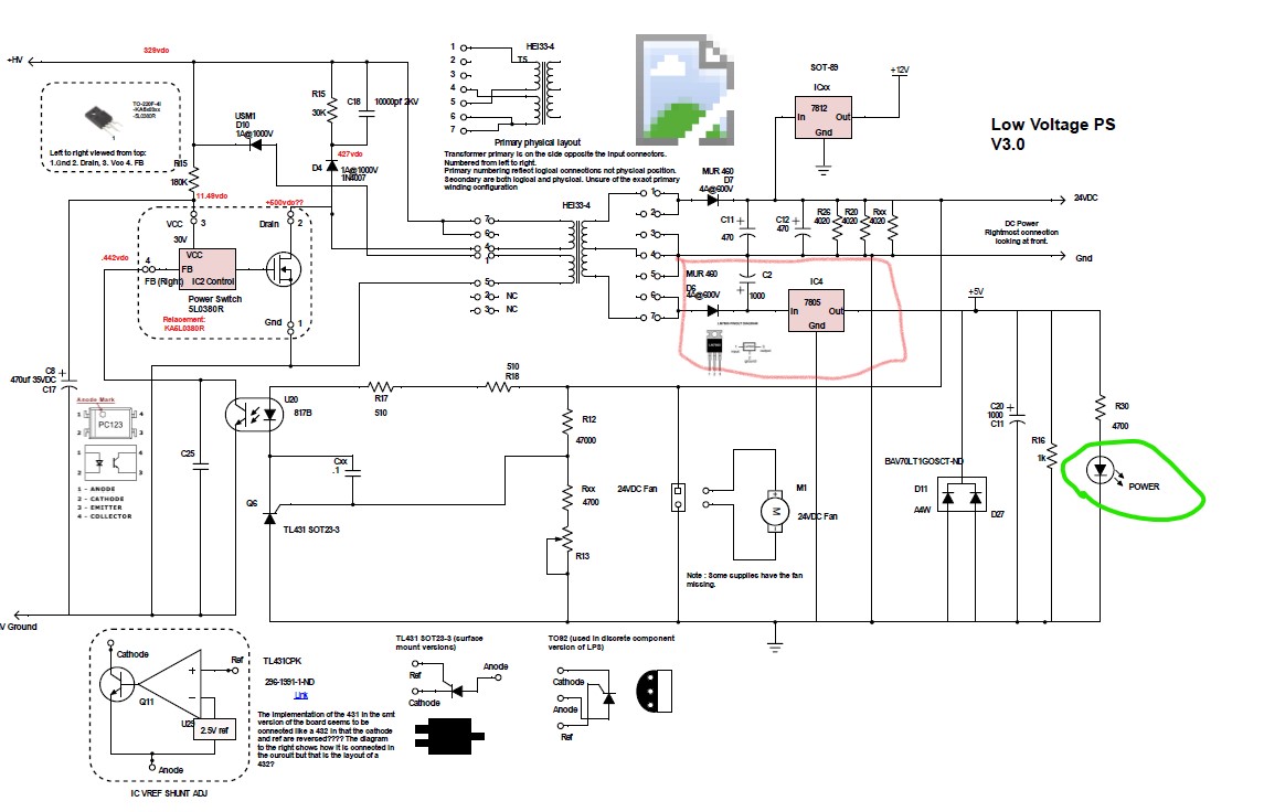

Note the power light is actually driven from the 5V supply, not the incoming AC, suggesting you have a bad 5V regulator
@meberhardt,
See the attached schematic page.
Note that:
-the 5V supply is driven off the 24V supply (Red circle)
-the 5V when present illuminates the “Power” LED (green circle)
My best guess at this point is that the 7805 is bad.
What do you have connected to the 5V output?
Try disconnecting it and see if the5V returns.

According to the schematic above I also have no good idea what else may be wrong…

Can you trace the connection from the 24V output to the fan connector?
Perhaps my schematic is wrong.
You could measure continuity from the 24V output to the fan connector.

You can pull out the PCB and visually trace the fan circuit.
It’s not clear to me what the fan voltage missing has to do with the 5V being missing?
Yes, Germany.
I will do that tomorrow and also get some pictures…
On my LAPS the 24V buss is connected through a jumper to the fan.
I wonder if that jumper is missing.
However if that jumper was not there the 12V would also not be working and 12V is used for the HV driver??
The fan and the 5V might be two separate problems.
No Jumper on my PCB.
So did you measure no continuity between those pads?
If they are not connected that is why you have no Fan voltage.
