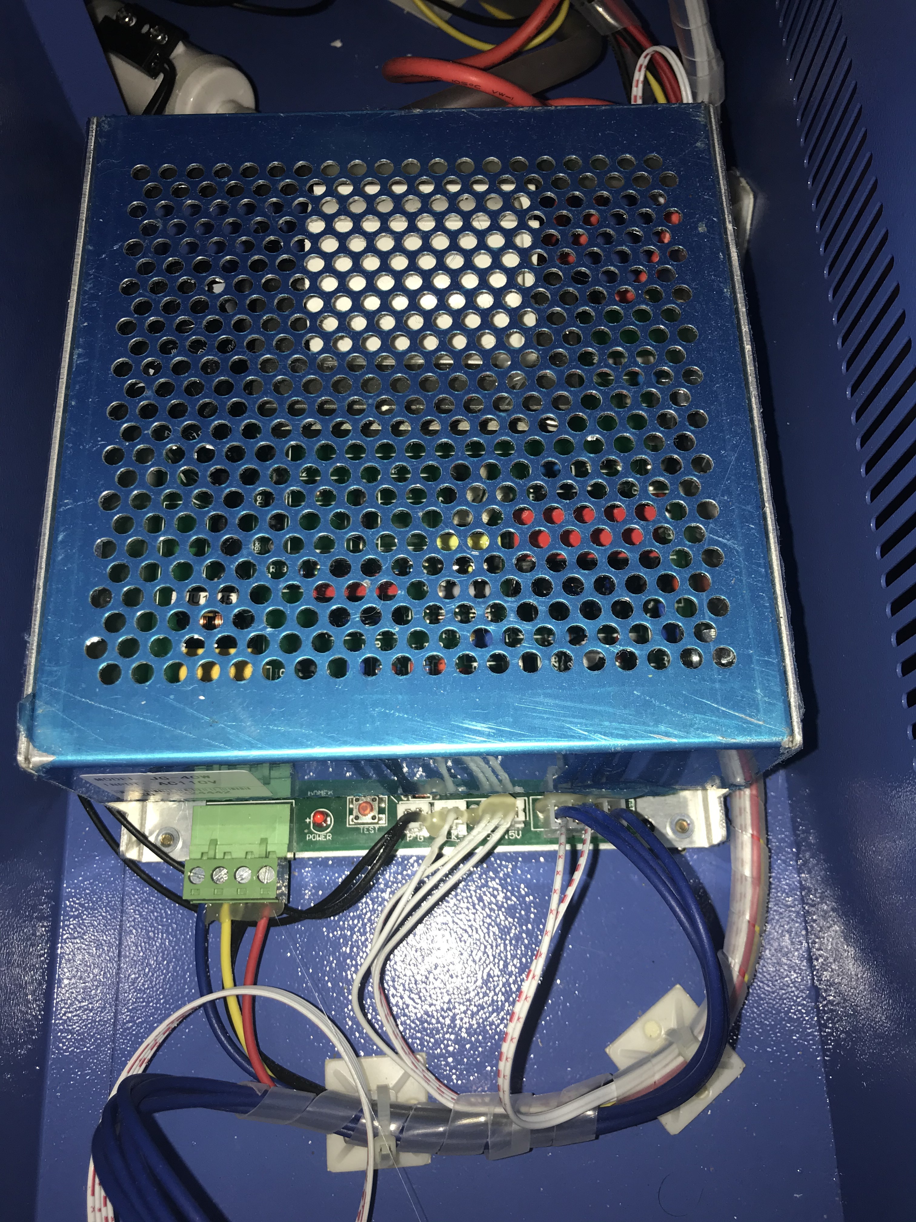

I plan on using an external power strip for the vent fan, air assist pump, and water pump and I have also planned on converting the Flowmeter and temp gauge to USB and connecting them to the external power strip (which includes 4 USB ports). But I also want to connect an 80mm fan for smoke assist, a red dot indicator, and LED lights to backlight the flowmeter. Can I connect them to the existing PS? If so, does anyone have a schematic? From what I understand I have the 2nd type of PS. The one that has the test button on it. I included a picture of it so you have a better idea of what PS I am using.

Typical advice on the power supplies has been that they don’t do well with adding much load. K40 enhancements and modifications - Getting Started with CO2 Lasers - Maker Forums says
The K40’s stock power supply is adequate, just barely, for K40 operations. If you add stuff on (like LED strips for viewing the lasing through the window while engraving, or for better visibility to set up stock to work on) it may cause issues because the power supply is just barely able to put out the power.
