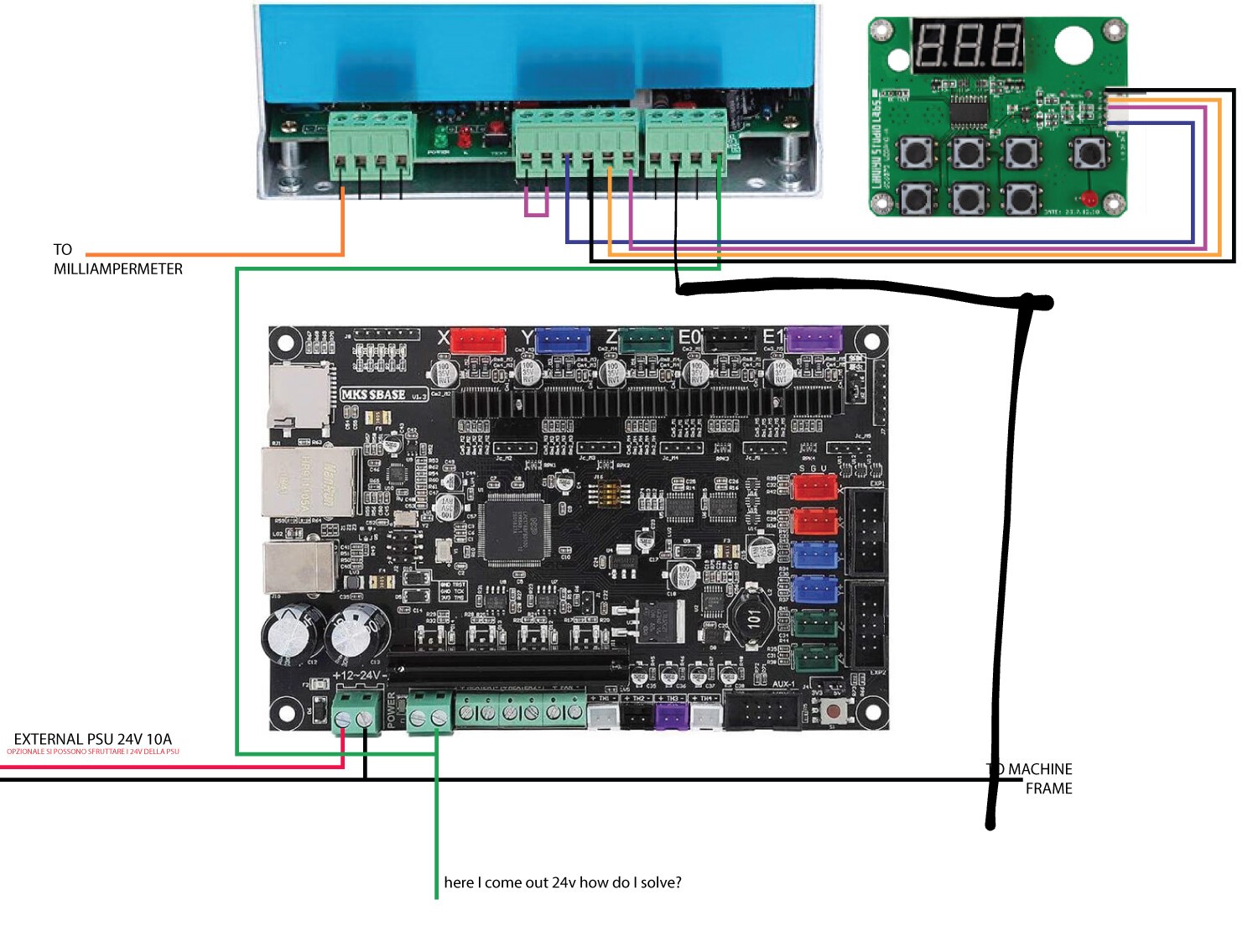

hi to all I have connected the mks s base to the psu of my laser everything works I only have a doubt the pwm on 1.23 delivers maximum 3.3v while the psu accepts maximum 5v in fact the output milliamps stop at 17 now I wanted to know if and It is possible to increase the pwm of 1.23 to 5v or connect it to another output to have the 5v.
attached my wiring

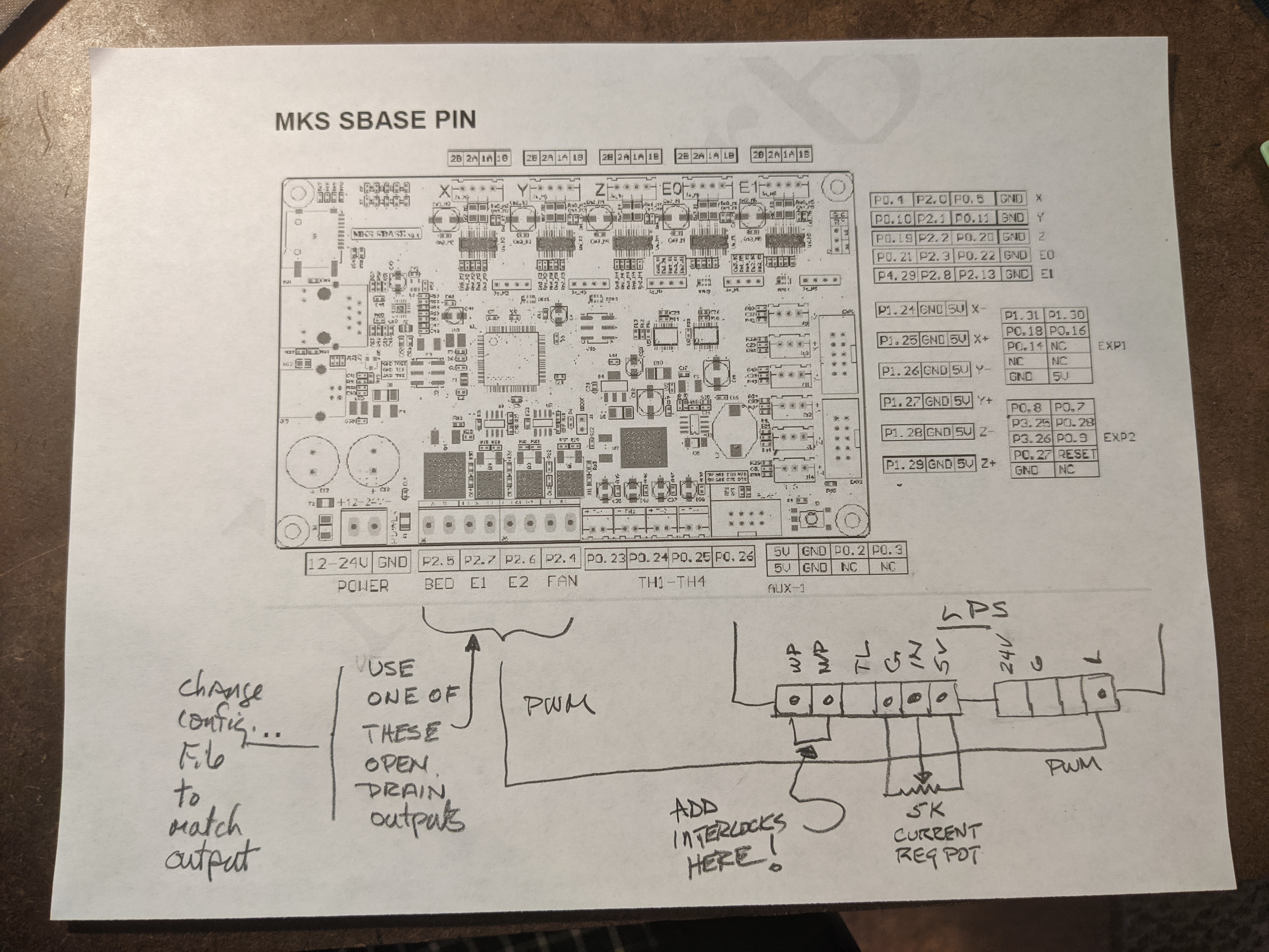

We recommend hooking up the wiper (middle pin) of the potentiometer to the IN 0-5V line to set the maximum power, and using PWM on the L line (using open drain configuration, of course) to control power when running. This way a software bug or misconfiguration can’t accidentally send too much power to your tube and quickly destroy the tube.
You can test fire and set the milliammeter to the maximum power that you might want to use, and then you have the full PWM range available using PWM on the L pin.
I beg your pardon but I did not understand could you illustrate me with signs on my diagram?
You cannot reliably drive the LPS from the J8 connectors as those are 3.3V logic signals.
To drive the LPS inputs: ground true signal are required on most inputs.
The simplest way to drive the LPS is shown in the diagram below.
I would recommend these changes:
  • For programmatic power control, drive the L pin with an open-drain output. Typically I have seen the BED or FAN output used. Setup the config file to match what you chose.
  • Add a pot to the LPS-IN pin. This sets the power limits of the tube.
  • Ensure that the controllers ground is connected to the LPS ground
  • Add safety and water flow interlocks into the WP circuit
  • Add a 30ma meter into the cathode circuit of the tube so you can see what current the tube is drawing.

the output voltage from bed or fan is 24v how can i decrease it?
There will be no 24V if you connect it correctly.

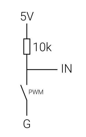

If you can invert the PWM signal in software, you could also connect IN to 5 V and the negative pin of e.g. the bed. [The PWM switching happens on the negative (drain) side. The 24 V pin is always on.]
Then IN is at 5 V and the PWM signal changes how frequently it is pulled to ground. That should also work, I think.
Edit: This needs a resistor.

don if i measure on the pin - of 2.5 and gnd of the board come out 24v this is a problem? the input line of the psu how many volts can it support I would not want to break the psu
at this point, as you say, I could also leave the digital potentiometer of the k40 instead of installing a simple potentiometer or am I wrong? @cprezzi can you help me I can not manage I do not understand why from 2.5 I am 24v :sob:

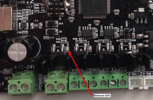

@donkjr turning in the forum I found this article but I did not understand how to unsolder the led diode d14 to solve the problem of the voltage of 24v on the mosfet?
Do not follow this post! It’s too complicated and doesn’t fit your case.

Ah! The led diode (D14’s) anode [see schematic above] is connected to 24V.
Therefore when Q4 is off its drain will read close to the 24V bus.
This LED just shows the on-off state of the Q4 switch.
It should have no effect on the connection to the LPS.
If you are concerned about it unsolder one leg of D14 or remove it.
