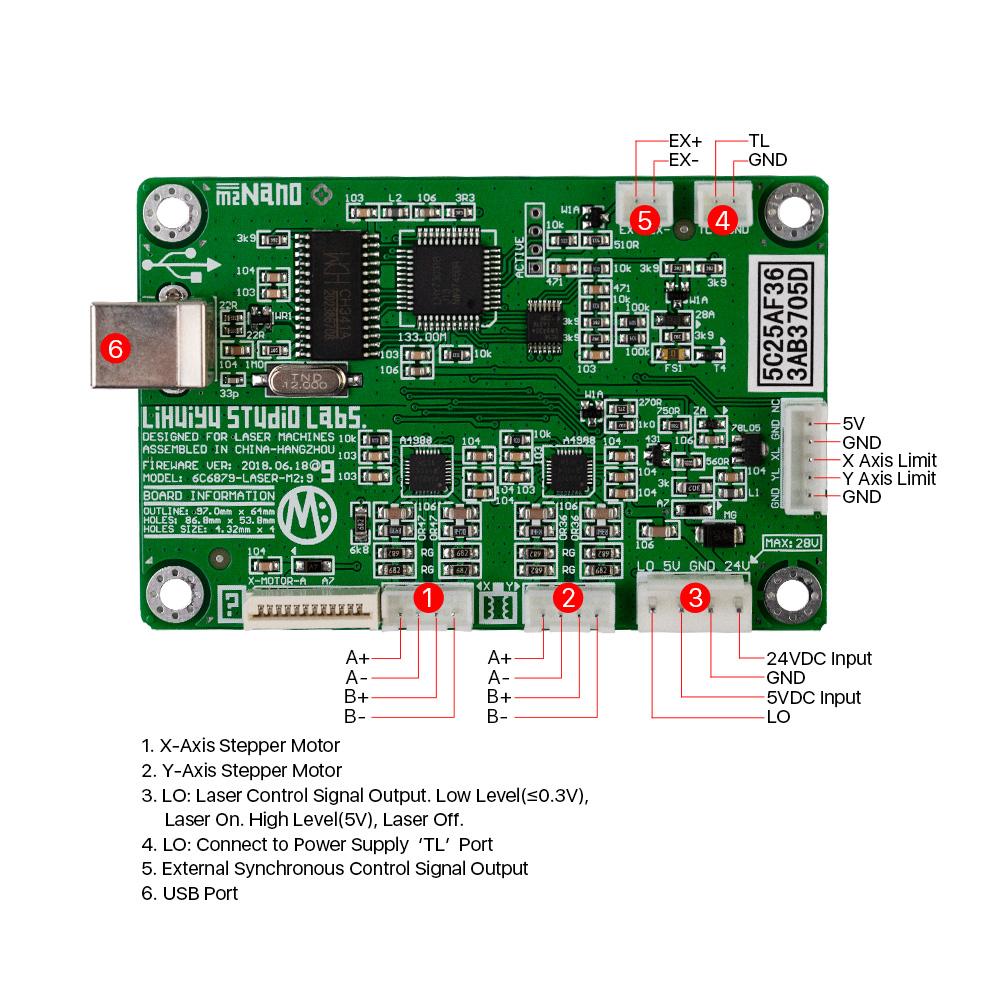

I can’t help with the wiring diagram, but sharing one other piece of information that is relatively new… If you are interested in exploring other software options as well, you might want to play with Meerk40t, which can also work with the m2nano controller. See the latest release at MeerK40t 0.6.0 released! or browse the whole MeerK40t category

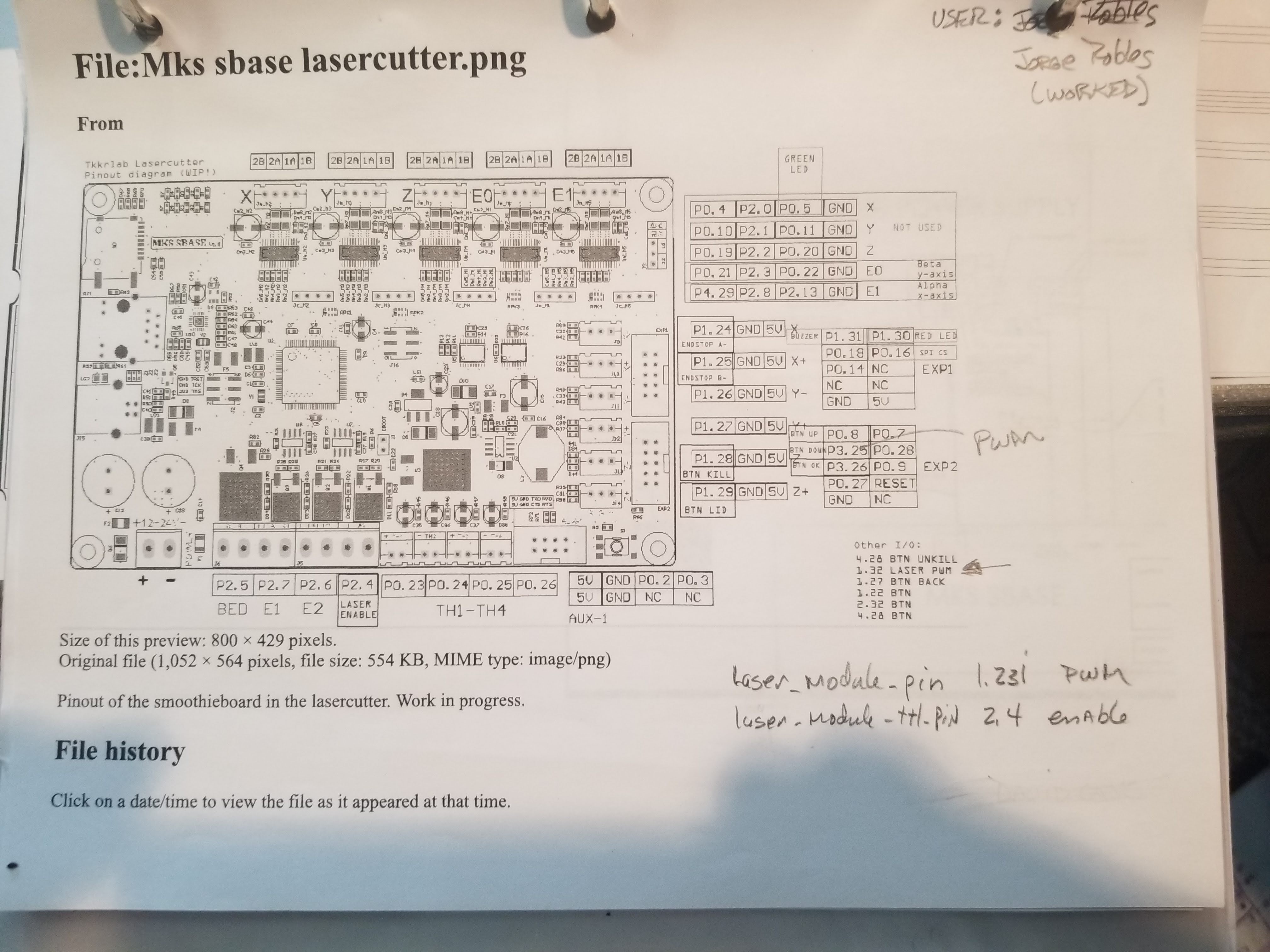

I helped someone a long time ago with an Sbase. Here is a link and my notes page.
These are for an older version but it can get you started.
https://tkkrlab.nl/wiki/MKS_SBASE_Smoothie

I e read just about everything I can, I’ve a sbase 1.3 with smoothie setup for laser, I build 3d printers so getting it moving right was easy, but… This laser beam stuff​:grin::grin:, do I just need 2 wires from the sbase to the laser power supply, one for laser enable, pin negative from hotend (heatbed MOSFET let out the magic smoke), and a pwm from the fan ?? I assume the negative again, and just let the config file know which pin is which
I’m new to invisible death ray laser eye burny stuff
I’ve left the digital panel installed, and I have a amp meter already installed and reading correctly
It’s ok, found the answer, pin 2.4! Negative to lps-l and pwm frequency to 400 so no noisy squeaky screeching, now to play some more later and tidy the wires up, thanks for all the posts on this forum, you guys have all the knowledge
