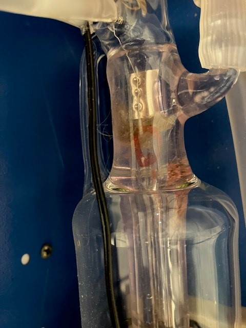

Although I am not a newbie in that I do 3D printing and CNC machining and laser etching using a 3018 , I decided to concentrate on laser and in particular cutting and so researched heavily the K40 laser. I bought a used machine because I knew I might need to change everything (apart from the box and tub) and indeed the one I bought seemed to work fine cutting through 2.5mm birch ply as an initial test but I wanted to do all the changes and setting up before starting properly and I only got the air assist in last week. I now find that I cannot cut through 3mm MDF and when I checked the internet, I came across your site where you have dealt with this issue numerous times. Although I can confirm the changes and setting up, I have done, I think I have covered everything you have recommended in the past. In trying to determine my problem, I found the site most useful I have come across for the newbie with a K40, so I wanted to reassure you that I think I have tried everything you have suggested in the past. This morning I think I may have found the problem in that I think there are some fibres in the lasing neck end of the tube. I cannot work out how this debris has got in as I was so careful in setting up the cooling system. Anyway, I hope you can see this in the pic. If you agree that I do need to clean this out, it does seem to be stuck at the lasing end of the tube so and I cannot remove by tilting the machine so it is unlikely I can remove it without flushing it out in some way. Do you think I might I be able to reverse flush it in situ using water from the tap which I could at least connect to the outlet hose? Would I need to limit the tap pressure? or do you think I will need to remove the tube which I would prefer not to do? If you think I should remove the tube, do you have a process for this? Going forward can you recommend an inline filter ensuring that debris does not get into the tube again presumably at the inlet end.

I doubt the debris is your problem. The cooling jacket contents surround the light path and do not interpose it. You probably have algae in the water jacket. You should flush it out but I do not think that is why your power is down.
If you have properly done the alignment then there may be a problem with the Laser power supply.
Yes, I would suggest flushing the tube from one or the other end. Normal house pressure should be ok. Obviously do not pressurize the tube, i.e. close one end. Once we determine what the debris is we can entertain an additive to kill and/or loosen it.
I think it is too early to think about removing the tube.

Will do. Thanks so far. I seem to be able to send a pic which is what I intended to sent this morning showing the debris. I appreciate this is not the problem but I will get around to fixing in the next few days.
As it seems I can now send photos I will respond to those requested in other posts and will add a pic of my head setup
That looks like brown algae.
I think you can remove it with a dilute solution of vinegar and distilled water.
@NedMan (our resident chemist :slight_smile:) can confirm.
