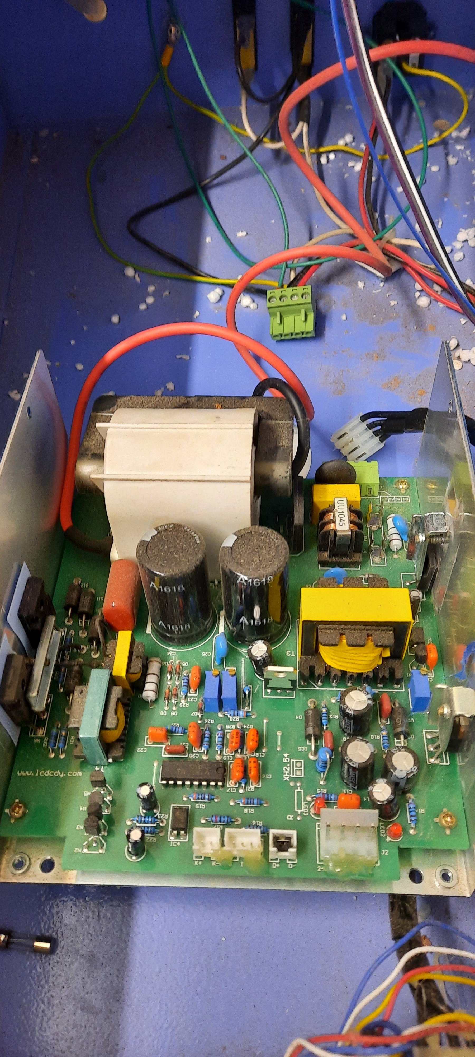

now added the pics sorry
now added the pics and software sorry
Your LPS is a very old vintage and no longer available. Note the D+,D- connections.

To be sure I will need to see each of the LPS connectors up close so I can read the labels.
  • Clean off the glue so the labels on the PCB are visible
  • Then take close up photos.

Here are the images , as for I think its LPS im not sure ,I bought a new tube and that doesn’t fire either , everything else works , as in it all lights up, gantries move, fan etc … but laser doesn’t fire

I notice in your pictures that everything is unplugged and the fuse is removed? Is that because you are getting ready to replace it?
I cannot see how the machine is wired with everything unplugged.
