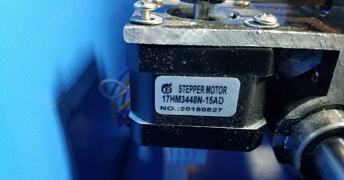

You’ll want a motor with a similar specification to the Y motor in your K40 if you are using the Y controller on the control board. This is because the current limiting will be set by a resistor that is soldered to the board. If you have trouble figuring out the specification for your existing Y motor, feel free to post a picture of the back side of it with the writing visible and readable.

gonna get a picture of one of the existing steppers. more to follow
so much for that. jammed my camera in there every which way and I can’t see any sign of a label on any face of either motor. between the two of them I think I saw every face, so I’m not going to go so far as to remove one

@donkjr found that his Y motor was a 1A motor:
That makes it reasonably likely that another 1A motor is reasonable for your A motor hooked up in place of your Y motor.
