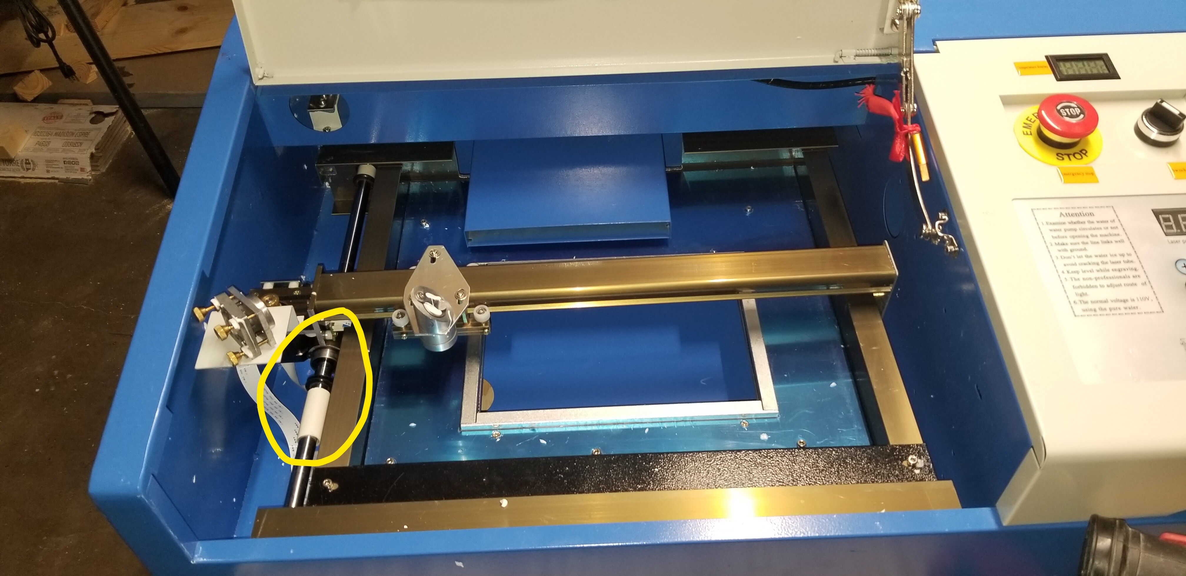

I bought this Ridgeway laser, its a K40 laser. It came in quickly but it has a major problem with a one of the axis, it will not slide smoothly back and forth. It appears that a type of bearing came apart. Where can i find this part?

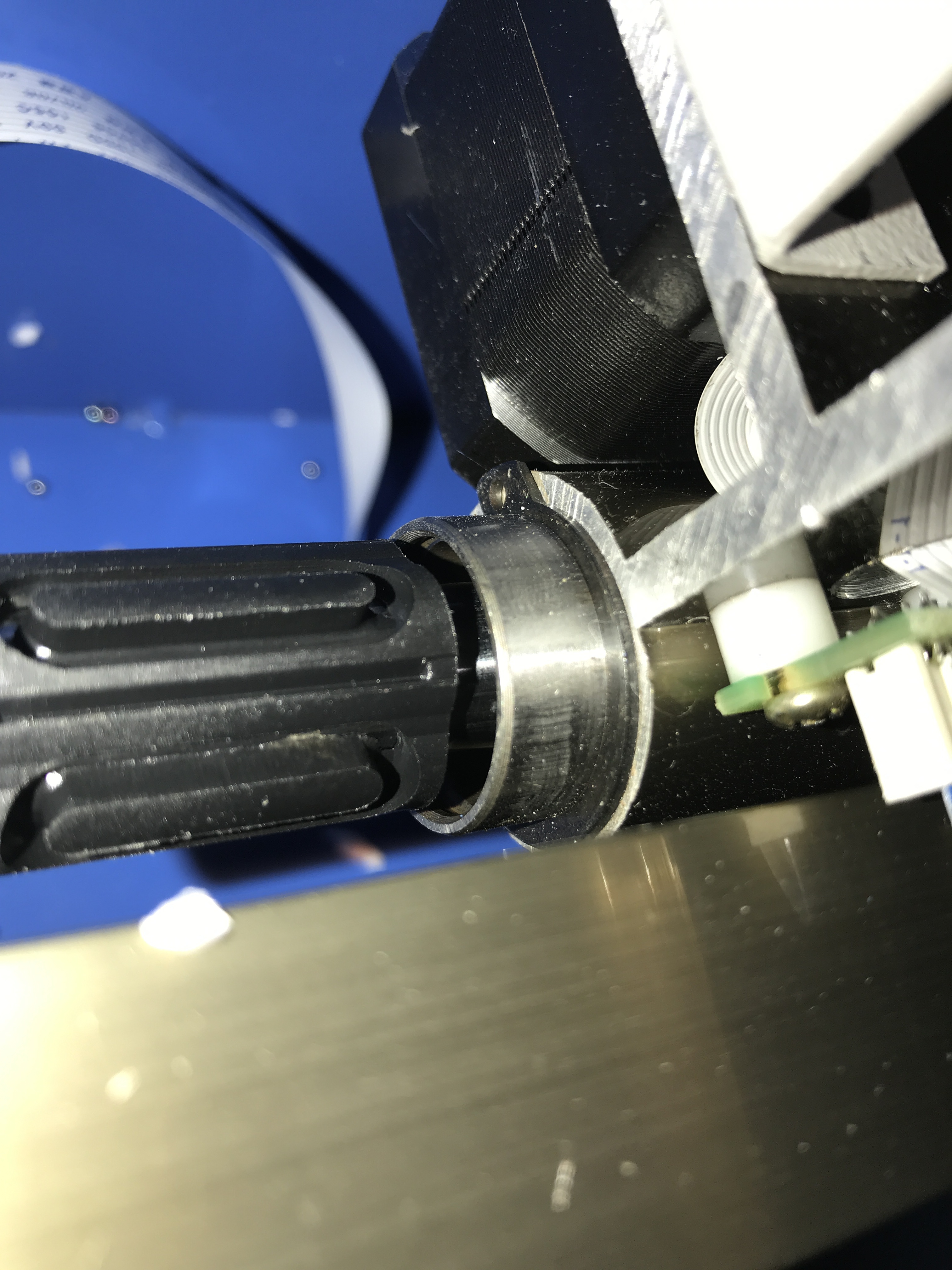

It’s a little difficult to see, but will it not screw back in?
Thank for your help.

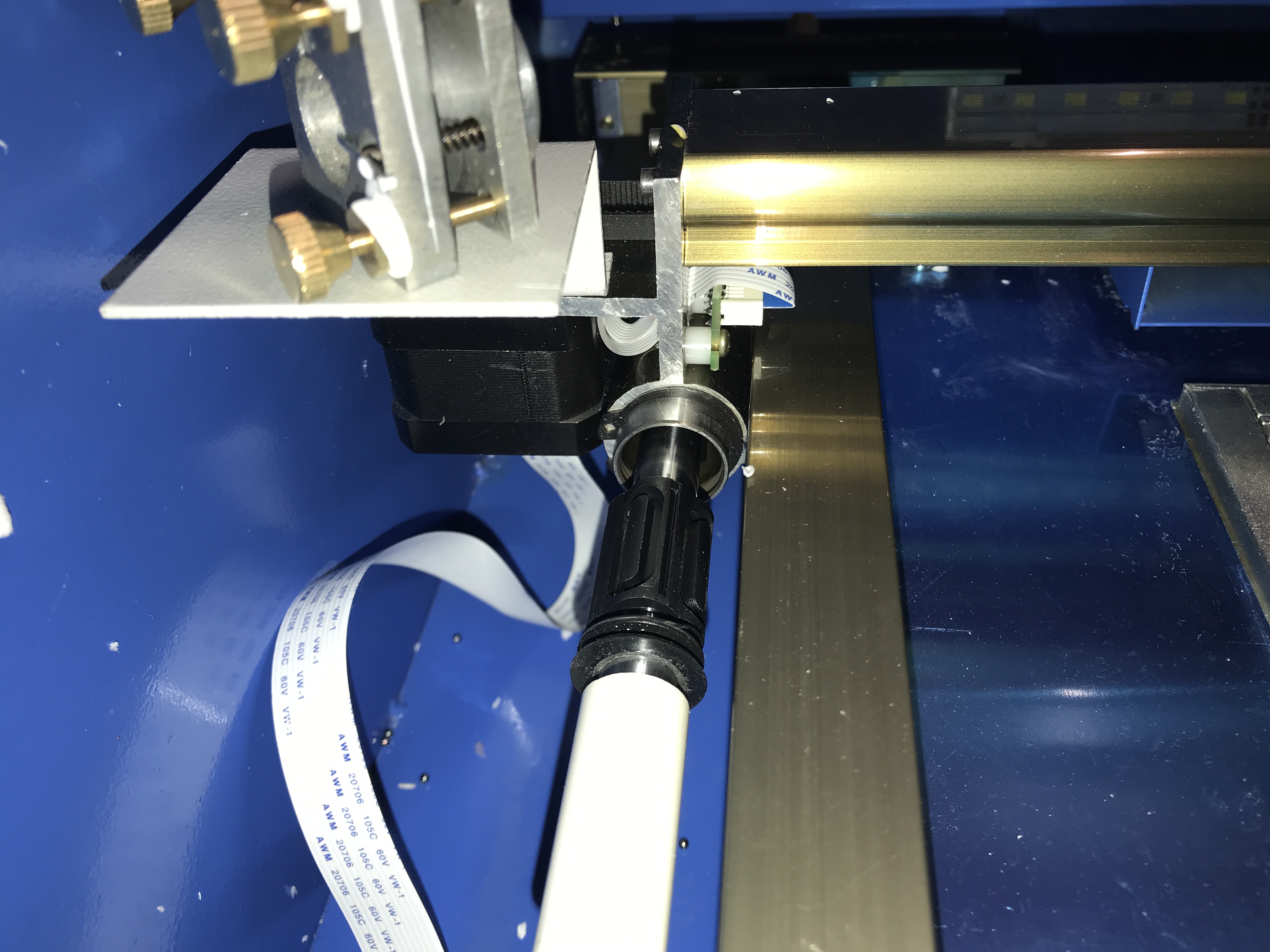

you can see all the little ball bearings simply fell out and i am not sure how many might be missing. I tried pushing it back in but without the missing pieces, its uselss to even try. I just wonder if that part is even available.
Ah, that’s annoying !
Looks like it’s held in with a spring clip.
If you can remove it, it maybe easier to identify. It will be a “linear bearing” - perhaps you could take some internal and external measurements and start to search …
I’m not aware of a spares seller - but someone else may on this forum :+1:

Oh, I didn’t understand what I was looking at until I saw the other angles!
Yeah, linear bearings like that are cheap and readily available. If the vendor comes through with replacement parts that’s best; if they don’t, we can help. Repacking is a pain even if you could find all the bearings that fell out. But I suggest waiting to find out whether the vendor will make this good before we start helping with a fix.
Removing the “circlip” is a lot easier with circlip pliers. I bought an inexpensive set of four; angled and straight; opening and closing. It’s possible without but fiddly.
If you disassemble it, keep all the parts in a ziploc or something so that you can measure them. Do you have calipers for precise measurements?

The calipers will be useful for measuring the rod that the linear bearing slides on, to get the right size of linear bearing. :slight_smile:
“circlip” is also c-clip and I don’t know how many other names. It’s the circle clip that stretches to fit a groove, and has little holes to stretch it.
General advice is to take lots of pictures as you disassemble. :slight_smile:
