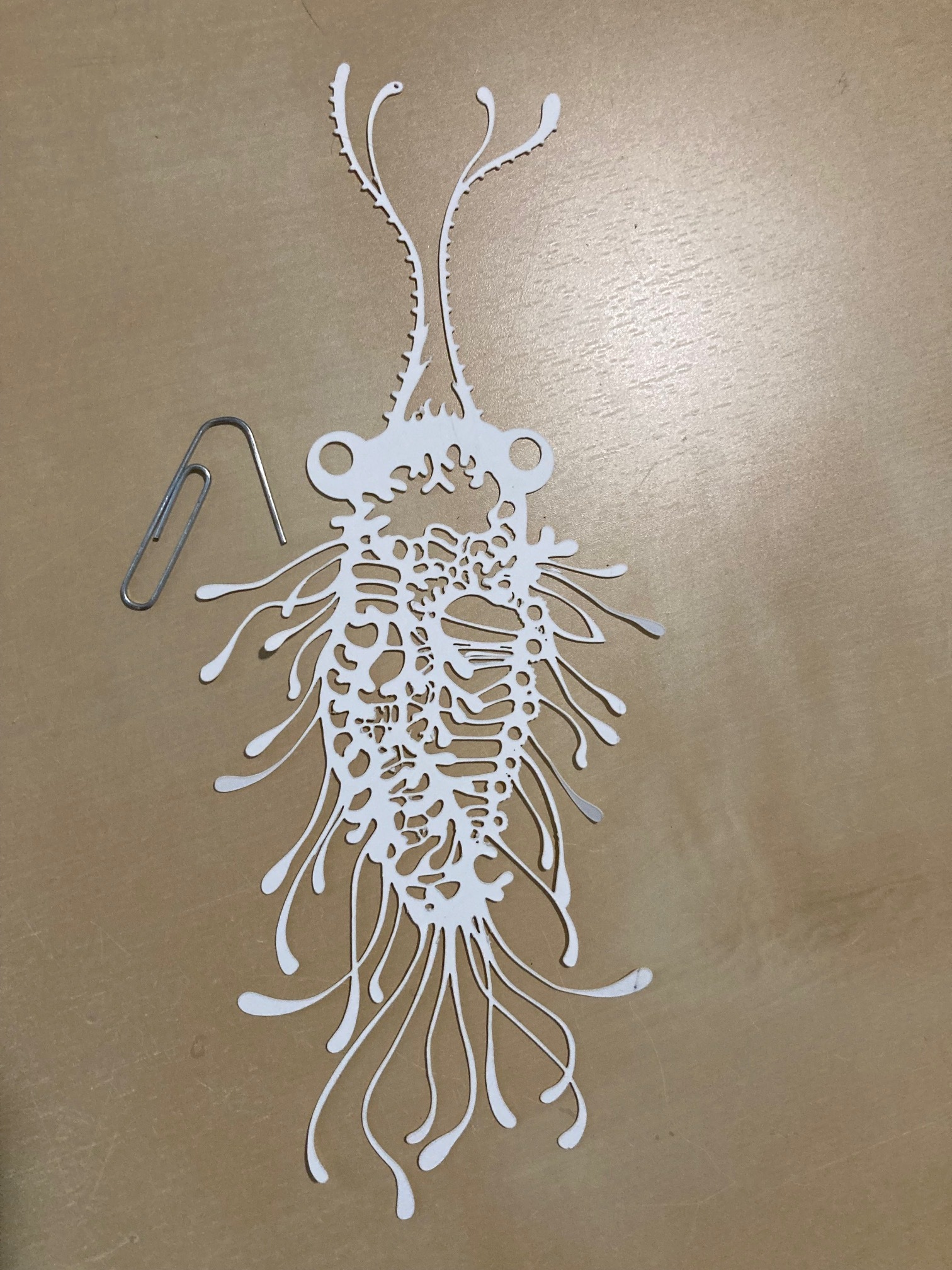

In the meantime, here is what I am making. The box and all packaging is made entirely with the laser and a vinyl cutter.
Photos & Video of Art
Thanks again for your expertise.

The substrate I use may have something to do with it as well. Since it melts and doesn’t burn, the material isn’t eliminated… it’s more or less pushed to the sides. Areas where it has to make an acute turn is an issue. For instance, you can not make a sharp point with this type of polyester paper whereas with cardstock you can. In order to create a sharp-ish point, I find you have to turn down the heat as much as possible and run it at a slower speed or the tip will turn into a blob since the paper is still hot. I only have one design so far where this is a major issue so I may just have to compromise. The benefit of using this paper however far outweighs this inconvenience; you can achieve hairline cuts in places it it will not tear, crimp or fall apart… even if you use all your strength to tear it.
I will look into this as a possible solution. Thank you!
