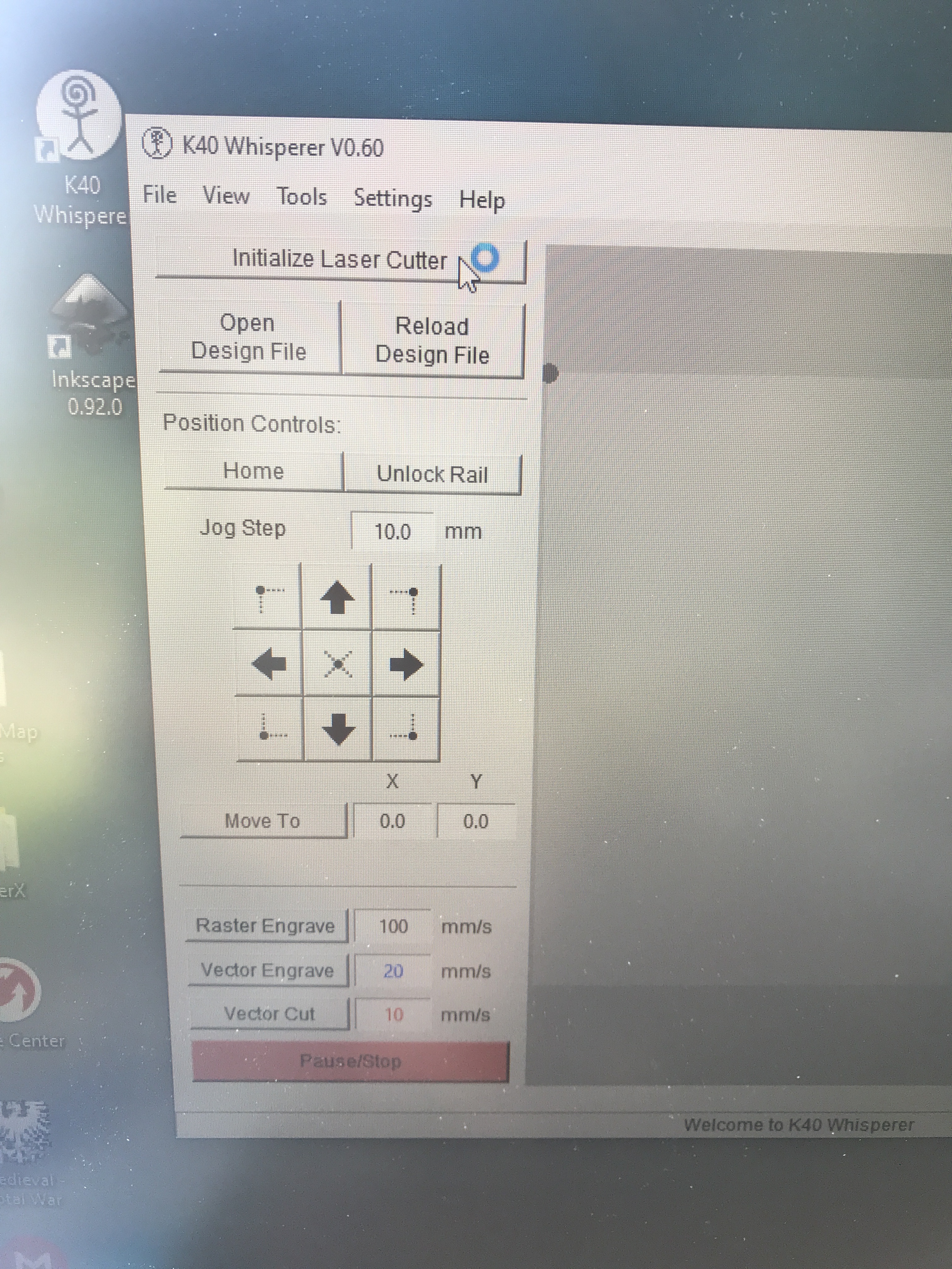

K40 Whisperer crashes computer when I press "initialize laser cutter"
Hi, so I just bought a k40 and after a little while managed to get it up and running. Did a few test cuts I made on Inkscape, and everything was running smoothly. Didn’t touch it for a week, as work keeps me busy. But I just hooked my computer up to it as usual, loaded a new cut file in k40 whisper, but when I hit “initialize laser cutter” my computer crashes and is forced to restart, saying it needs to collect data on the crash.
I don’t know what’s going on with it, so I tried it a few times, shut it off, deleted the only software and downloaded it again, but it still crashes.
What can I do to fix it? Even pressing “initialize laser cutter” without a project loaded causes it to crash.
