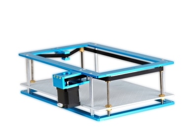

I wonder how much their Z axis adjustable bed mechanism costs, seems like it would be easy to make
Take a look at the lightobject variant:
Thanks, ive seen this one, it is a sleek one but im actually looking for diy option.
Seems like a fun project to do, if componenets could be sourced for less than 50eur.
Im just starting out, so the cost of such adjustable bed is too high
Less than €50 seems difficult.
I suggest single-start lead screws so that they don’t back-drive. These are available for 3D printers. And you don’t need very much travel. You don’t need anti-backlash nuts because of gravity. You’ll have to decide what kind of bushings/bearings to use. gt2 closed-loop belts are available in lengths appropriate for this work. But when you add up all the belts, pulleys, screws, bearings, bushings, rods, stepper motor, and frame parts, I really doubt you spend less than €50 unless you have access to spare parts. But… good luck! :slight_smile:
I use the LO table.
I designed a DIY one and its projected cost was more than the LO one and getting these to move smoothly is a chore. I moved on to more rewarding projects.

Yes, I suspect threaded rods, rollers, pulleys + motor/belt might add up fast and not saying it is easy to ‘calibrate’ the setup but I guess I would love to try such mechanical design challenge some time in the future.
Actually I had some idea whenever old disk drive thread rods could be used, or the ones from diskette drives.
Travel doesnt need to be very long and they support ~4cm of travel I think.
On a side note - isnt it easier just to get adjustable laser head and move the distance from there? What are the cons of such method?
