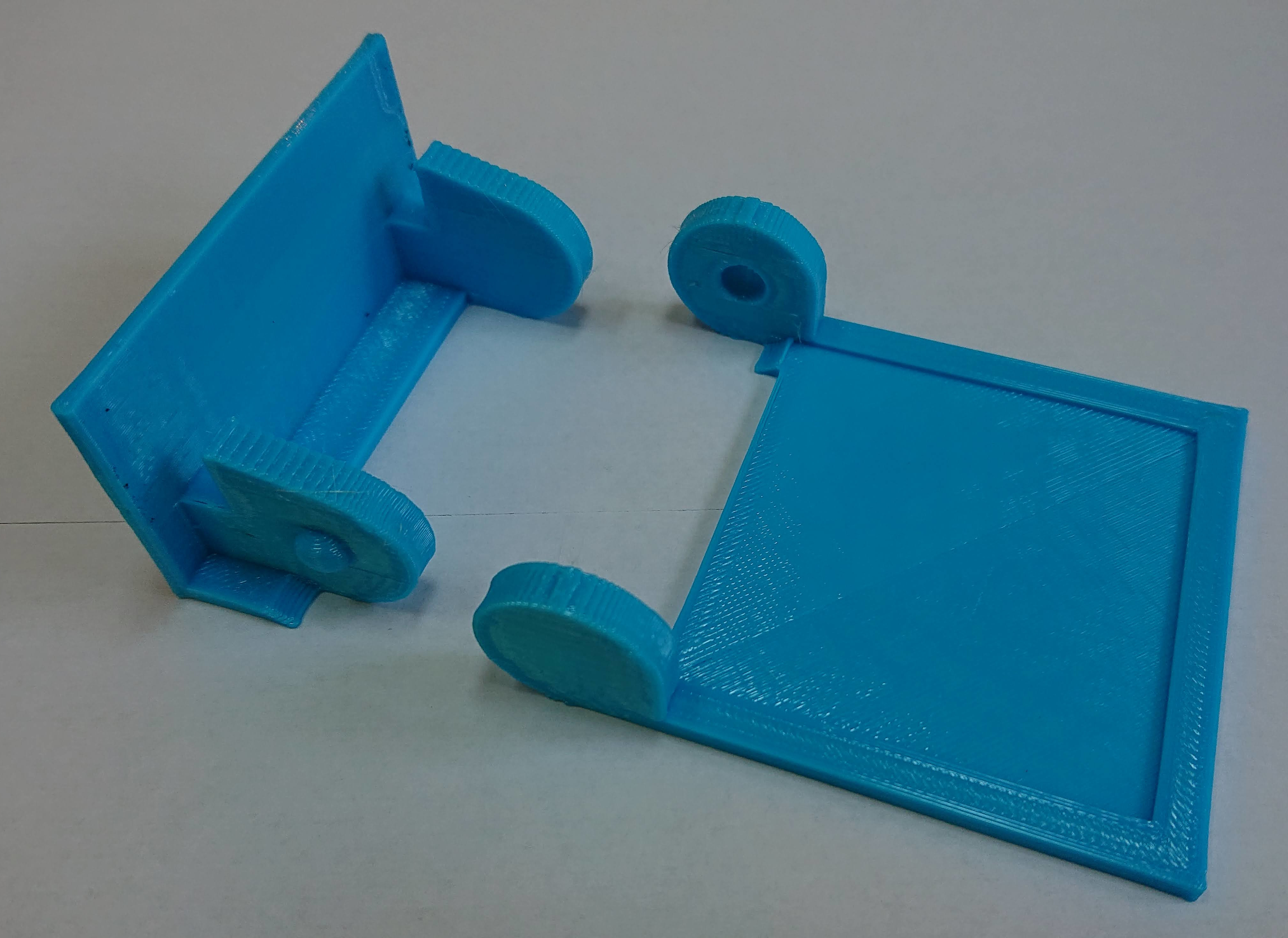

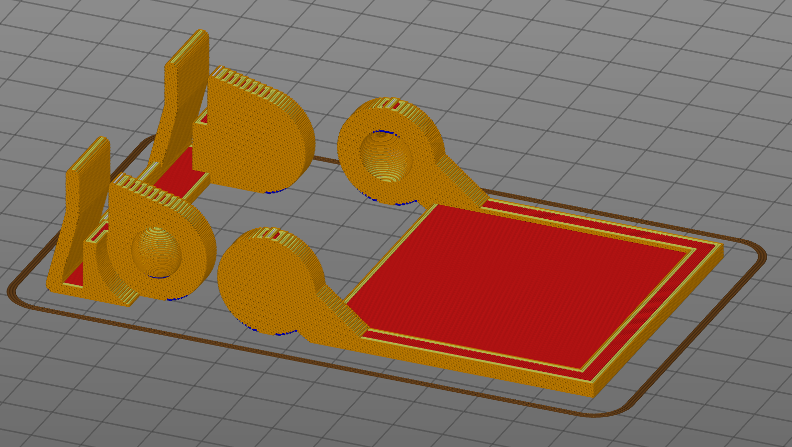

Not yet test-printed. If it works well, it’s meant to be easily customizable for different bezel thicknesses and to adjust to match preferred screen angle.
It’s not a print-in-place because that would not support an interference fit. Odly, it’s not print-in-place because a print-in-place has to be too loose for this to work! :relaxed:
First print overnight showed a significant set of changes to make for the second print, now underway.
Second print works better, more changes coming!
Starting the fourth print, gets better each time!
I hate how long it takes for thingiverse to post a render of an SCAD file, but I’ve at least posted it on thingiverse now.

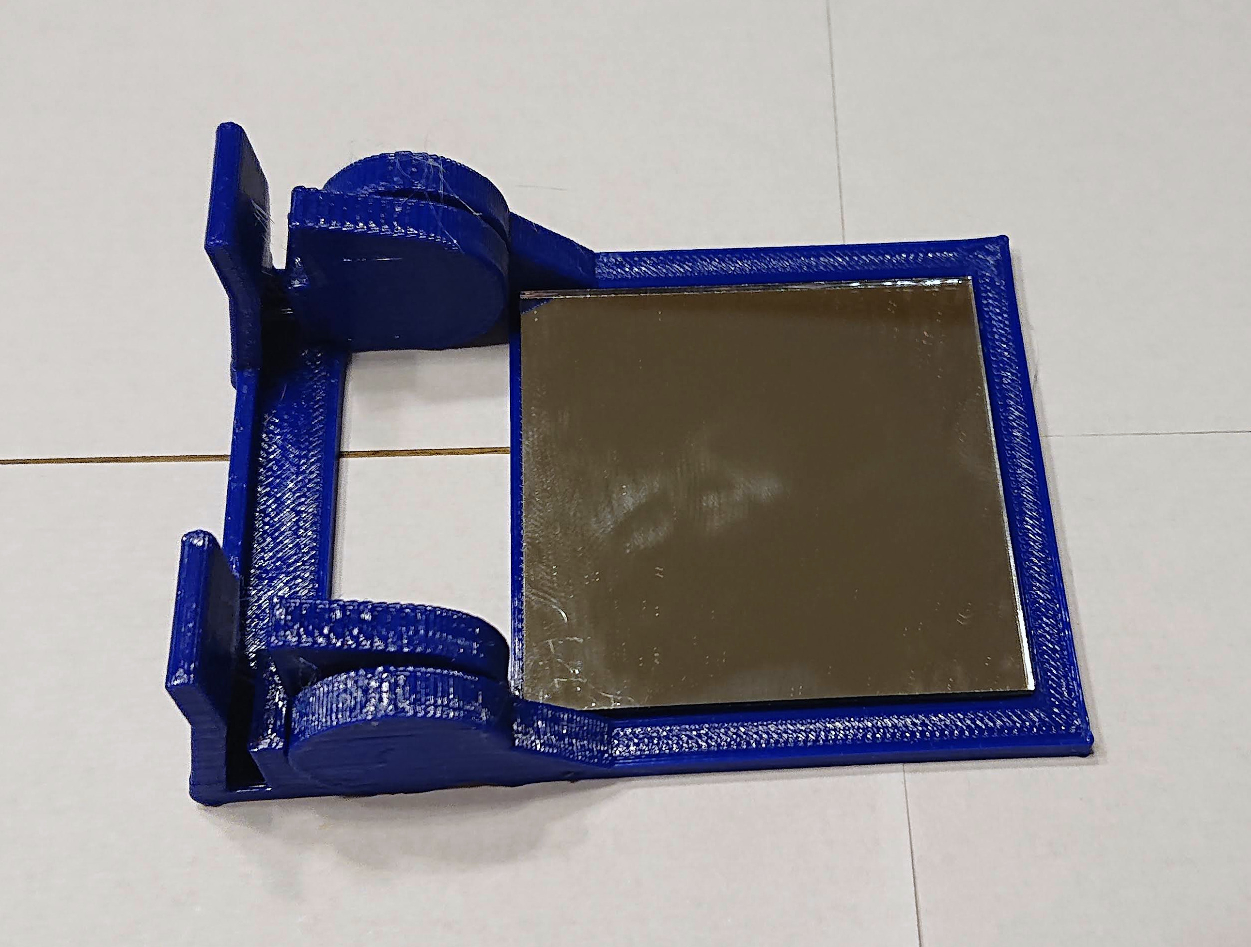

Mirrors don’t arrive until tomorrow, but this print looks good.

Iterated a few times before and after work, and I think it’s now looking pretty good. I’m not sure how much range of monitor thickness I can get from a single print, even with fairly tough PETG. But it’s now a more solid fit than what I had before. And now the lid should be able to move up to more than 180⁰ to use the web cam as a web cam. About 25g plus mirror.
Still just as customizable as before, but now it’s more likely to work to share it with a friend.
As printed, with mirror installed:
Folded down to show the document camera mode:
Installed on a laptop screen, in document camera mode:
Flipped up to use the webcam:
