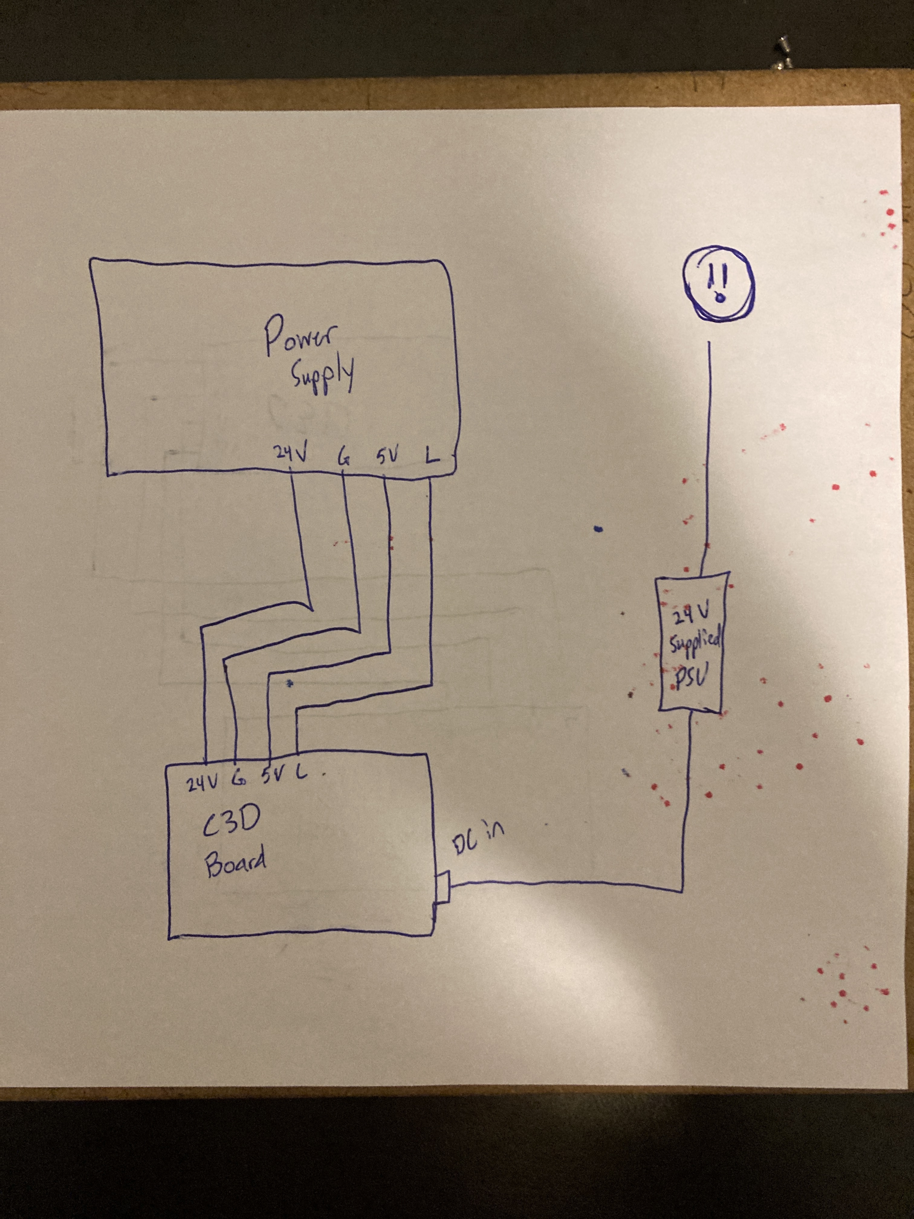

Can you draw how these are wired? i.e. point to point
How is the C3D dc supply (24VDC) wired to the C3D
Sure thing. I will post a photo as soon as I can draw it up.
Essentially the c3d board has a DC in plug (round) right under the USB plug. That comes from a completely isolated 24V supply that comes with the board. It is plugged into an outlet in the wall.

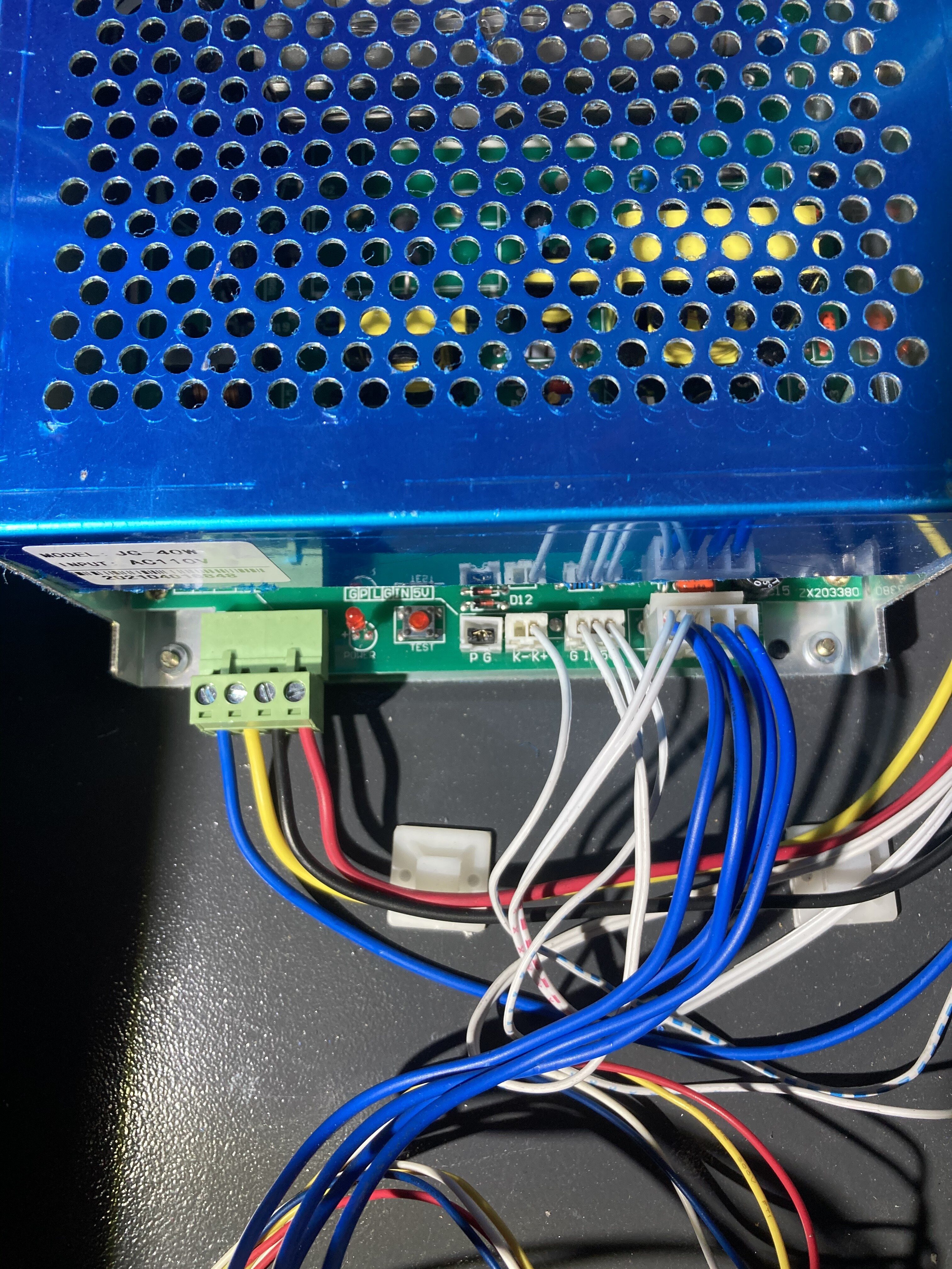

The 4 pin rightmost plug on the laser power supply goes straight to the c3d board. My original photos show this connection, it has 4 blue wires.
I will draw up the connections and post the photo as soon as I can.
I notice that there are black and red wires into that connector as well?
Yes, those power the red dot on the laser.
Dylan, you look to have the end stops and motors wired correctly and there’s only one other connector which could be a problem… that is the connector which leads to the 24v/Gnd/?/L connector of the LPS(Laser Power Supply). I would recheck that those signals match correctly the labels on the C3D connector. The “L” signal is what controls the amount of power to the laser tube so if that connector is plugged in backwards the tube power control would be uncontrolled.

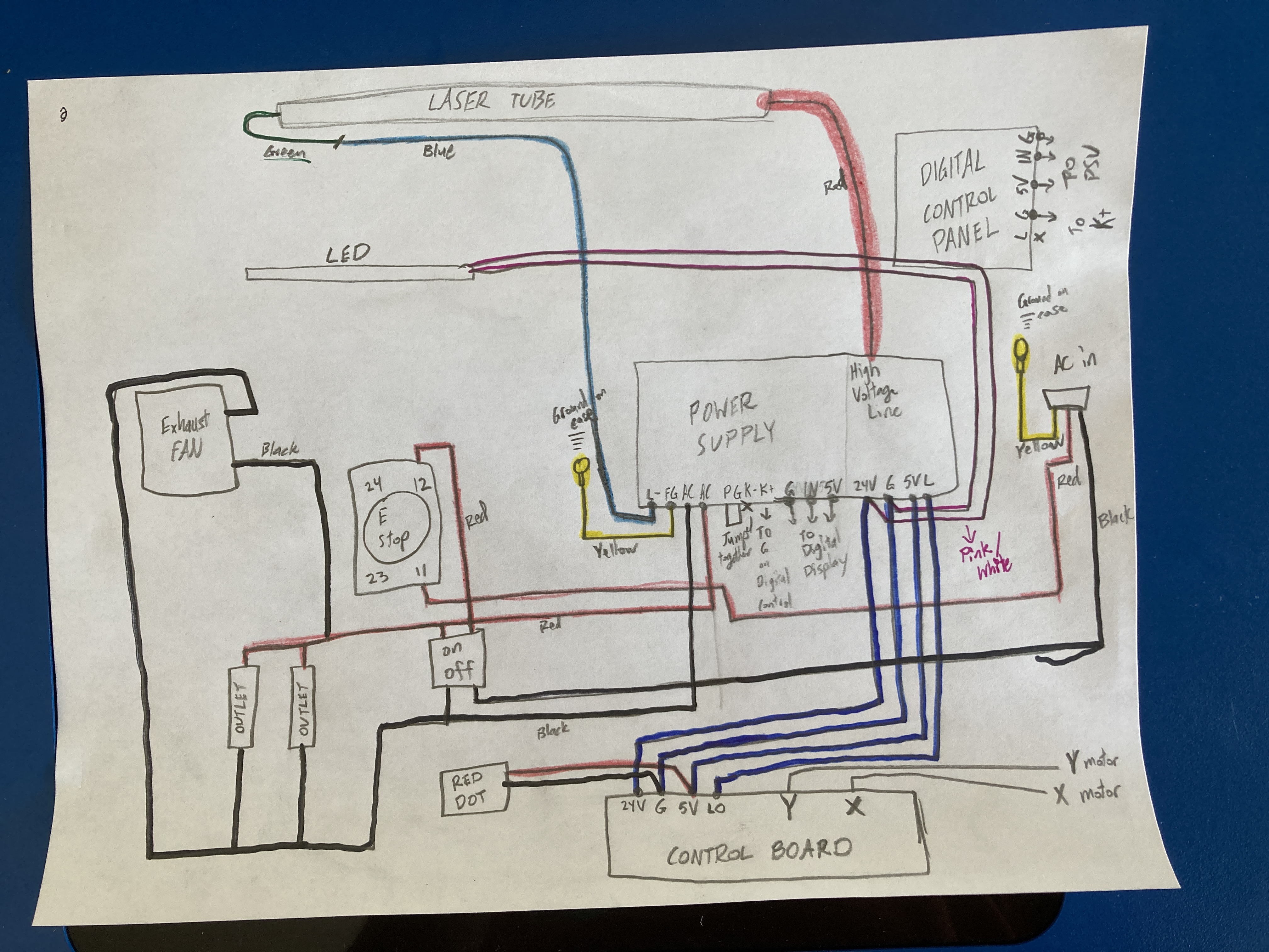

Here is the wiring schematic STOCK.
Here is a basic drawing showing how the C3D board is connected to the LPS and how it’s own power supply is hooked up.
