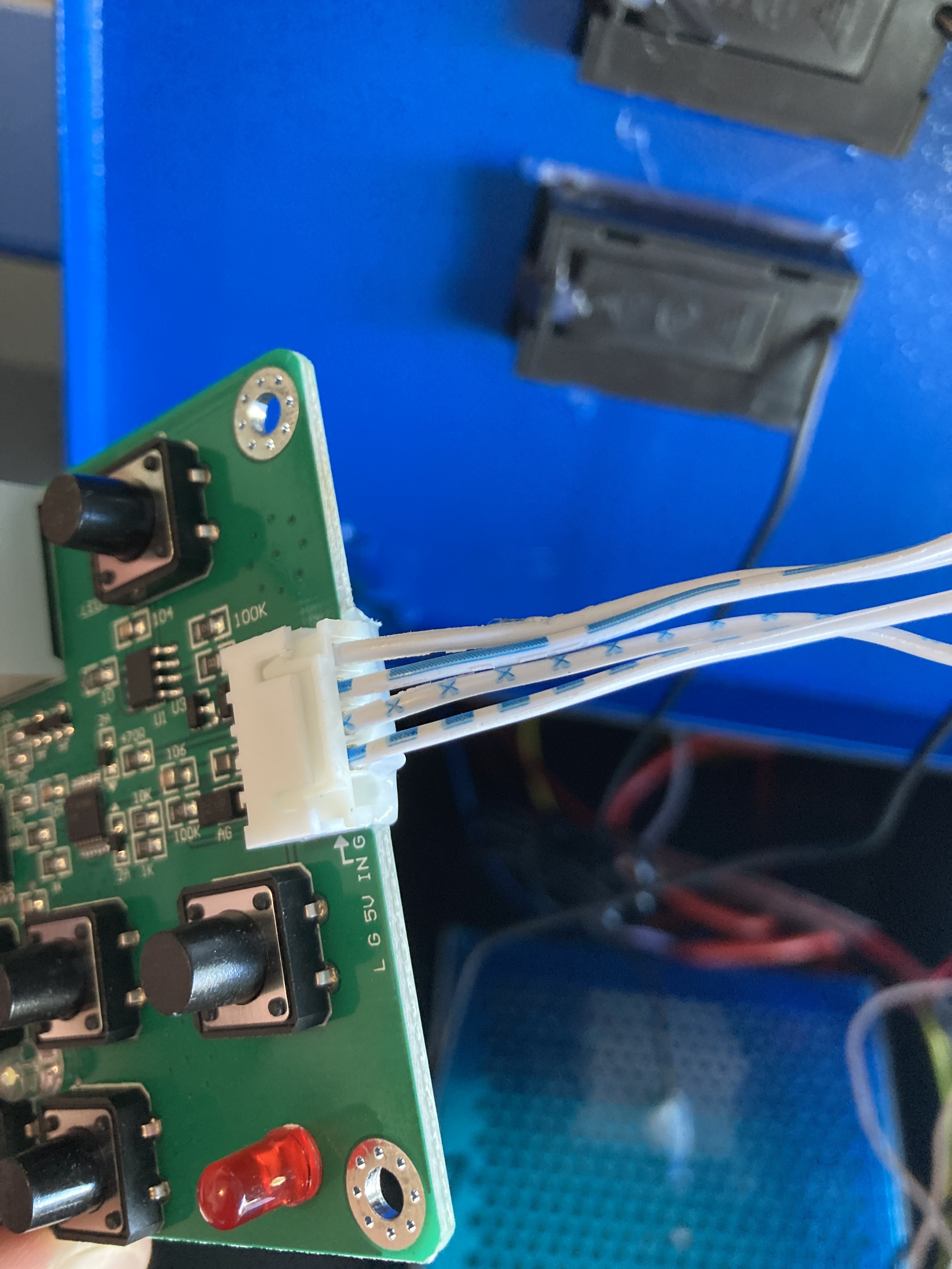

I have double checked that all 4 blue wires line up to 24v, g, 5v, and L. In fact, we can verify this because the 24V LEDs are wired into that 4 pin coming out of the LPS. On the board side, the red dot is wired to G and 5V and it works. Though I have since removed the red dot wires as they were just stuffed into that connector, not even crimped.
So it seems to be wired properly.

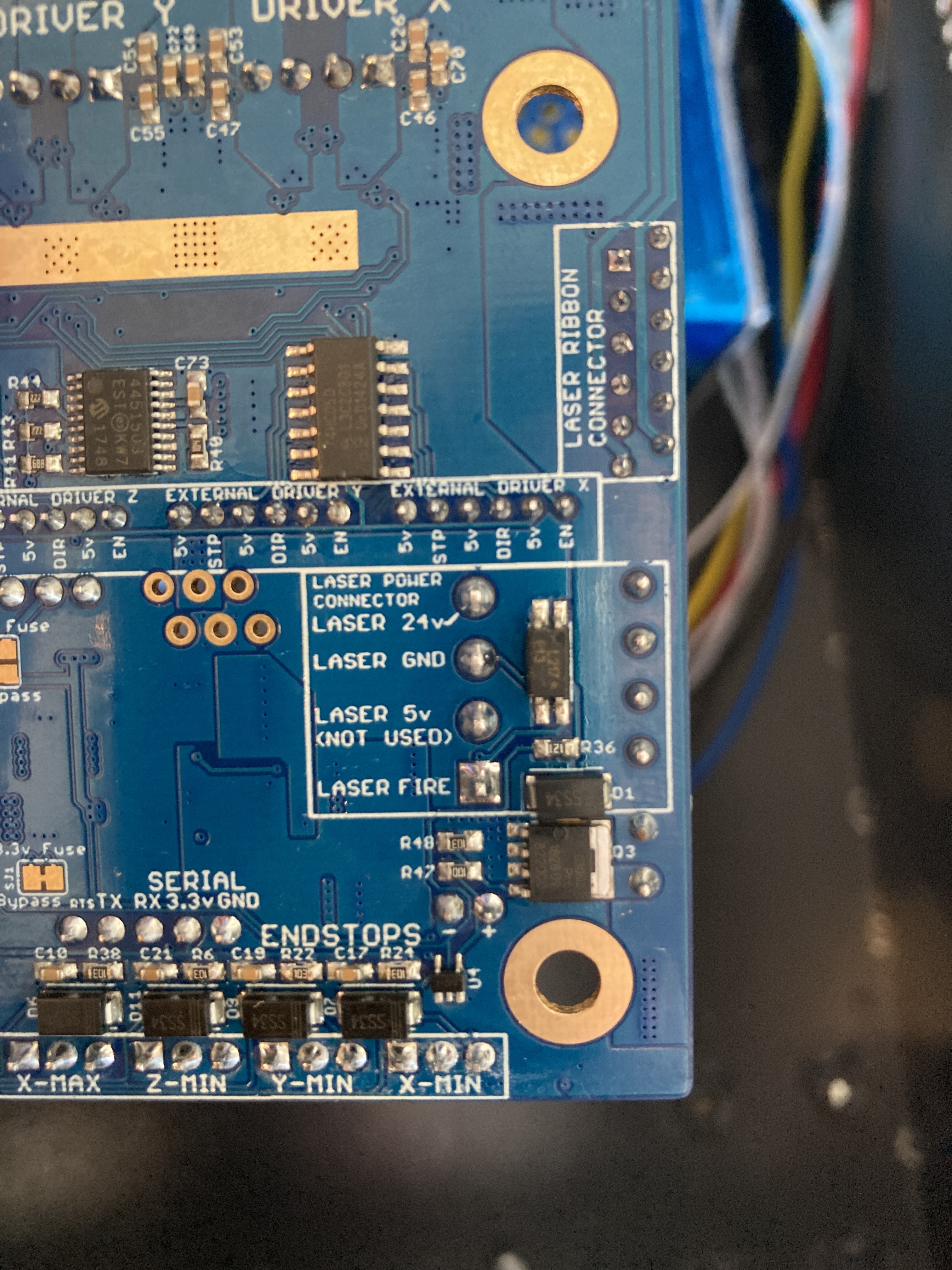

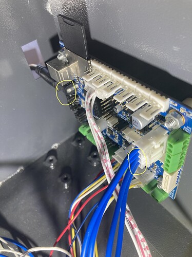

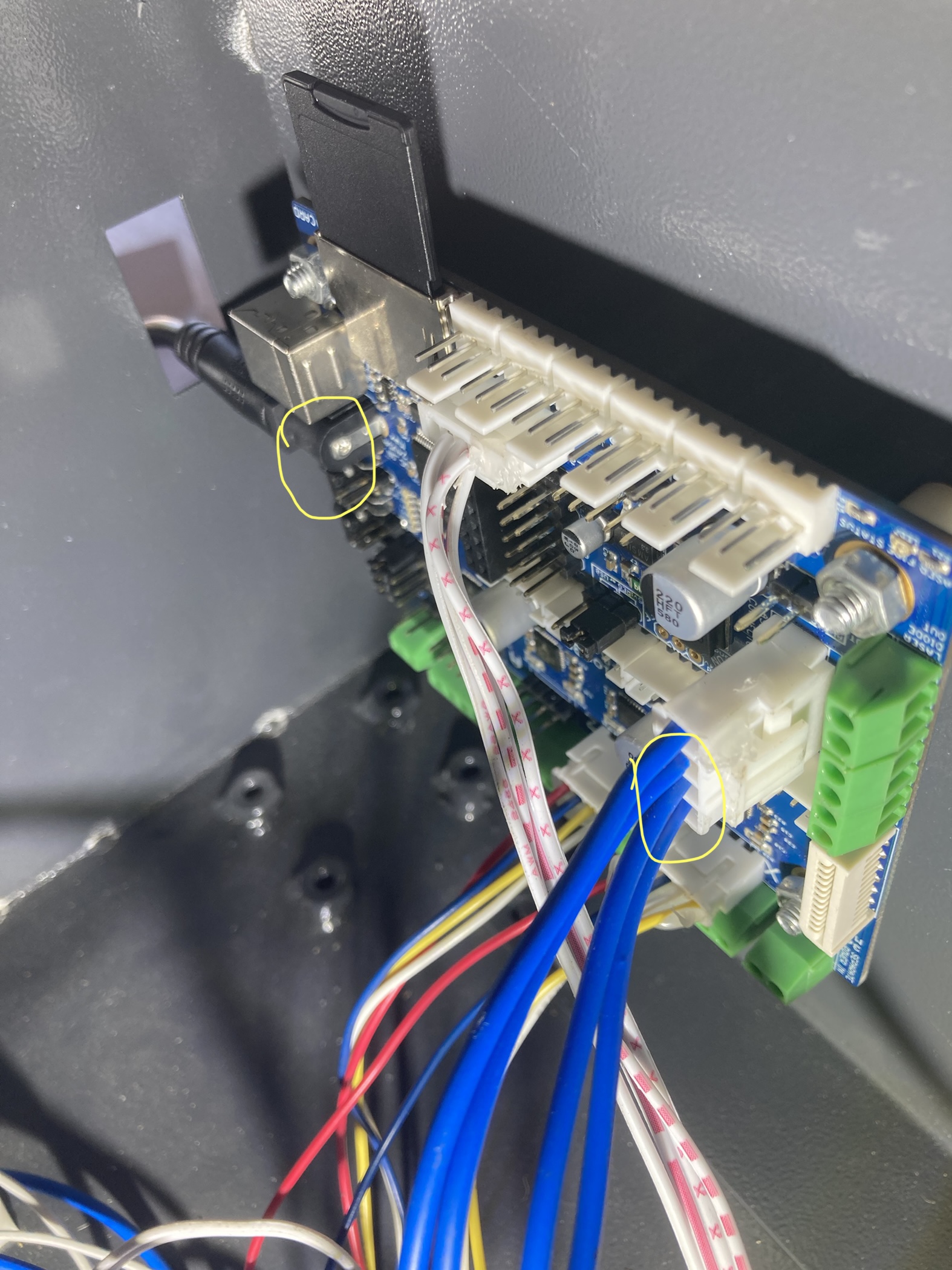

Here you can see the back side of the c3d labeled which pin is which, then showing the front side where the L wire is routed properly. The other 3 are going to the right pins on the LPS as well.

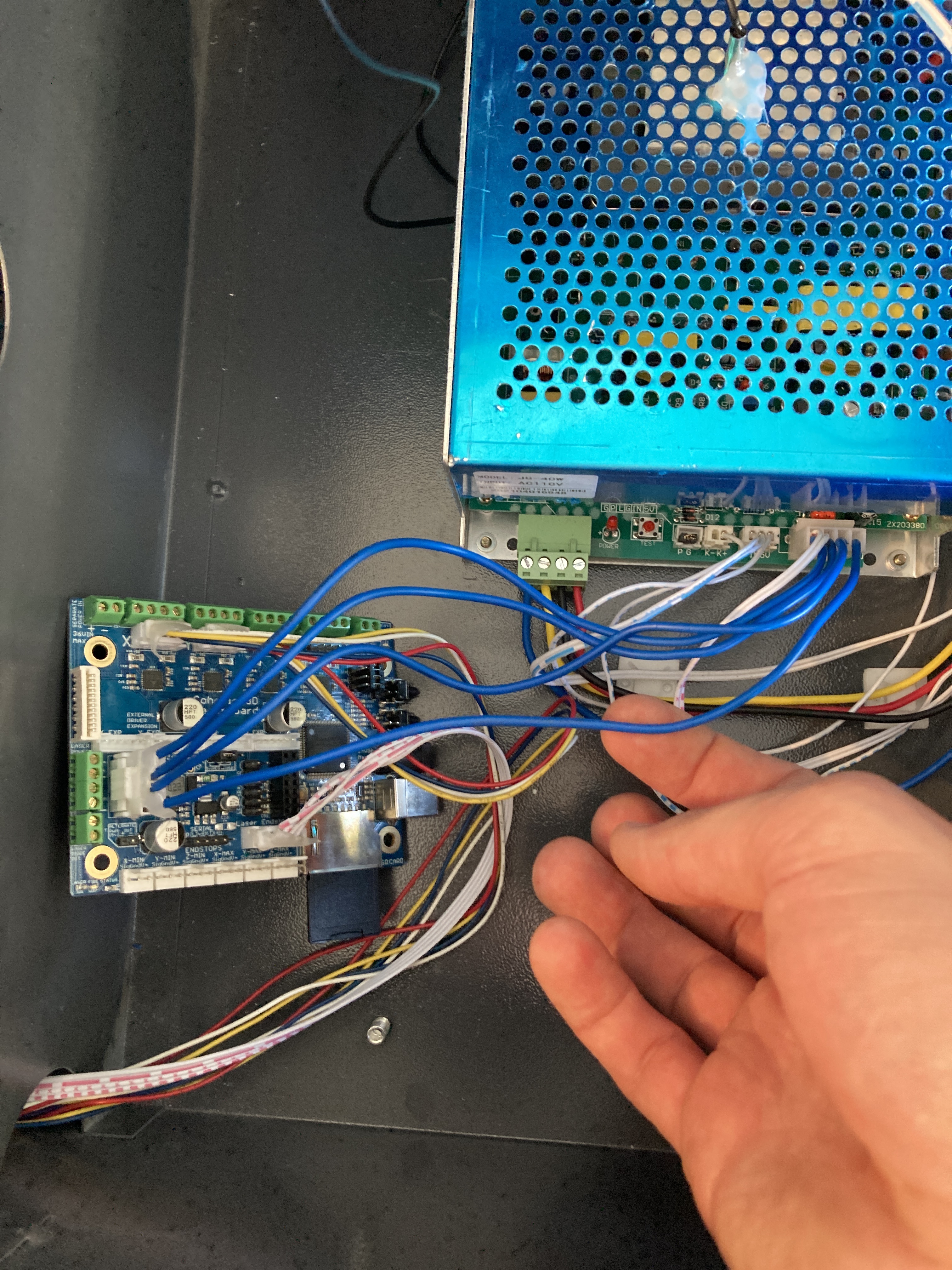

Traced each to the LPS, they all line up with these pins on the LPS…

The C3D is holding the L pin on the LV connector low (gnd).

Measure the voltage [to ground] on the LaserFire pin of the LaserBoard with the power on with these conditions.
---- Measure Voltage on Laserfire ----
Do this one with power on
|Ref#|LV connector on C3D* |Volts on LaserFire @ C3D|
|M1|Plugged in |??|
|M2|Not plugged in|??|
*with the L pin inserted in the connector

It’s been a while and I could not find the correct schematics for this board. I am just trying to see how the Laserfire pin is being driven in this board configuration. Can you point me to the schematics??

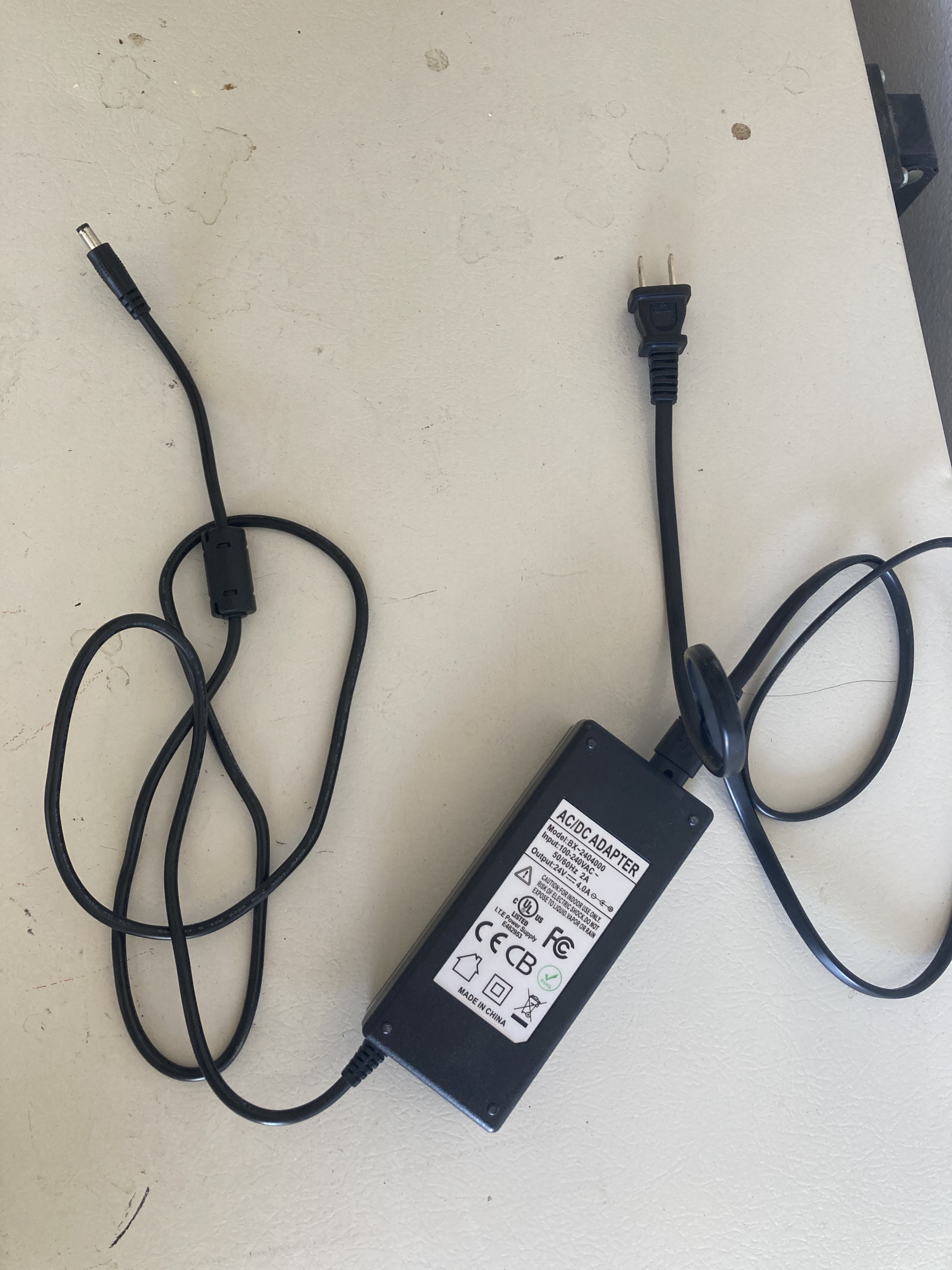

Ah, I had a feeling this was what you are looking for. See the photo, which is the power supply C3D supplied to be used with the board. Not sure how I can test ground on this…
MMM did not know that was the type of supply.
Plug it the ac and and measure the voltage on the dc connector from inner pin to ground just to be sure there is a ground.
Plug it into the Laserboard and then check (with power off) the continuity between any ground on the laserboard and the LPS ground.
Before I do anything wrong, is this where you are saying to measure voltage? From the DC in - G on the LV connector?
I meant before you plug it in but that will work. Do not short out those pins.
Sorry for my confusion, how would I measure voltage prior to plugging it in?
