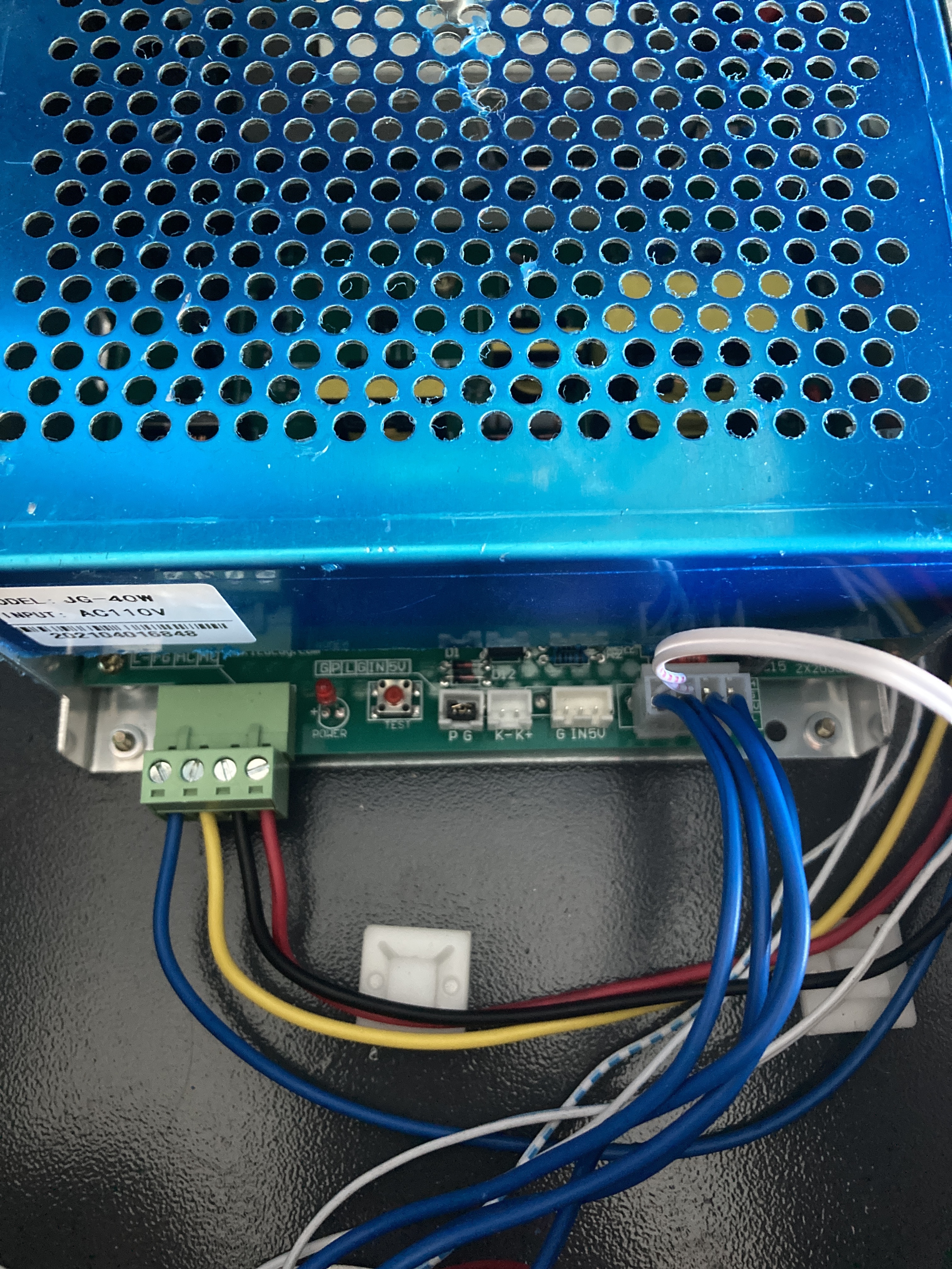

I apologize for my not tracking with you here⦠when I power on the C3D by plugging in the DC cable the LED indicator comes on showing the board is receiving 24V.
Not sure what you mean by shield - is that meaning the back side of the DC in? The part I circled in the photo?
Inner pin being the pin on the backside of the board measured to the G pin on the LV connector?
I am referring to the connector on the end of the LVPS not plugged into the board.

Laser fires immediately at power on with only the AC plug on the left, P and G jumped together, and the LV connector plugged in. Seems like it fires at a higher power and it fires immediately at power on. Typically it takes a few seconds for the laser power % to show, then the laser fires.
If I remove the jumper on P and G laser does not fire at power on, no laser enable, and no laser test. Laser test button on LPS will fire laser.
