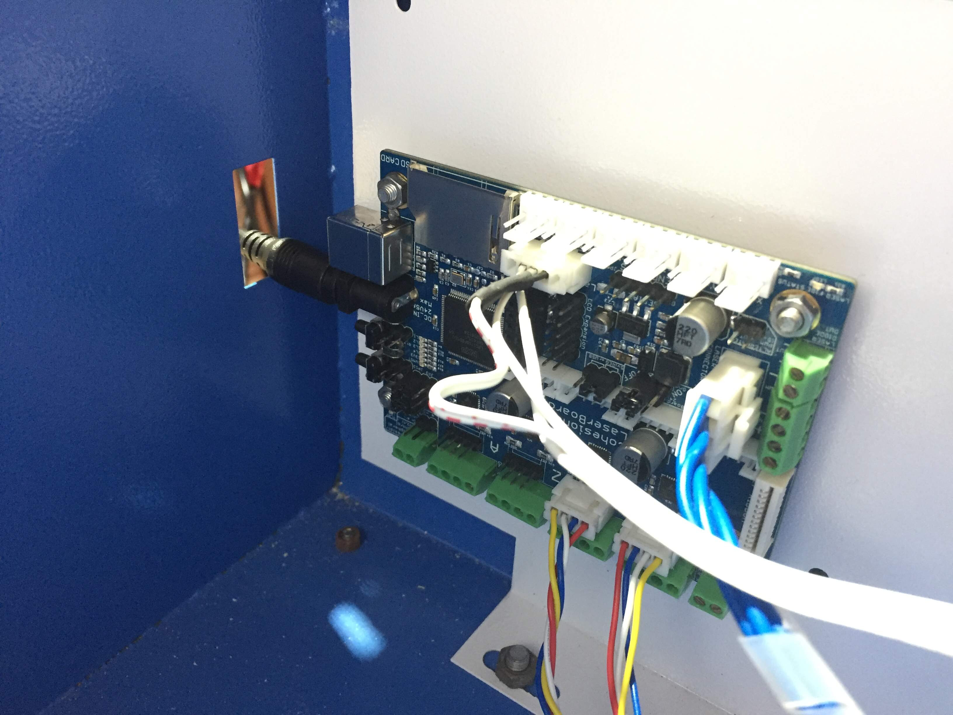

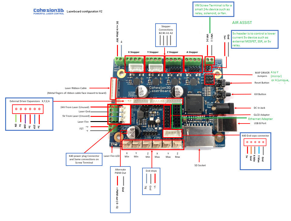

On the C3D website I found 2 places where it discusses wiring the board to the K40.
This first link seems to be the place to start when installing the board. Plug n play. All 4 wires remain in the LV connector per these instructions.
Then there’s this one, discussing wiring to various types of LPS - notably pointing out NOT to use the 24V and 5V wires from the LV connector.
Which to follow…? Obviously based on my setup, I followed the 1st article.

Shit: I assumed that since the C3D says “Not used” it meant that they were not connected. Then again if there is a config where the LPS power is used to power the C3D these have to be connected?
… connecting these supplies together can be a big problem.
Disconnect (pull out) the 24V and 5V pins from the C3D side of the cable and try again.
This shows both 4 pin power cable and 24V barrel connector plugged in a the same time.
Yet:
My assumption - based on the first article, which seems to be the one C3D points users to right away - is that leaving them connected was fine. Heck, even their own pictures show it that way.
Yet, as you pointed out, in another article they specifically say NOT to connect them??
The second seems clear that you do not want the LPS 24 & 5v connected to the C3D board.
Just pull those pins out and try it.
Just pulled the 24v and 5v pins out of the C3D side of the LV connector - laser fires at power on. Same result whether they are connected or not.
