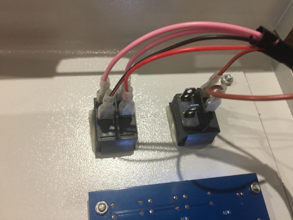

We need some pictures:
  • The connector side of your LPS
  • The controller showing as much wiring as possible
  • Any interlock switches that the cover you refer to interpose
  • The control panel front
  • The control panel back side wiring

Ignoring the Mains Terminal block and counting from the left, which terminals are ‘L’ & ‘TL’ or are ‘L/LO/TL’ all the same terminal? I’ll try and upload some photos. My photo showing terminals 1 to 10 (if it uploads) ignoring the Mains Terminal block.

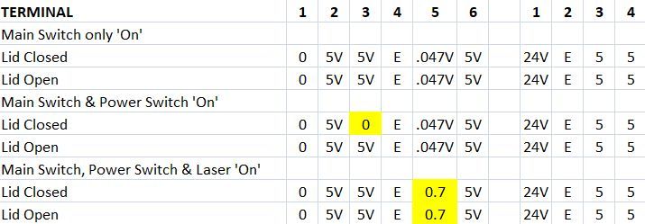

In your case, it’s the L in the middle (intended to be used for the test button on the control panel) and the L on the right (intended to be used by the controller):
L- FG AC AC     G P L G IN 5V     24V G 5V L
According to that table, P (“2”) is always high even when the lid is closed. This means the interlock switch is defective or not connected.
Neither the test button on the control panel nor the controller should be able to fire the laser.

I have done some more testing/checking and have come to the conclusion that all wiring appears to be correct. I can’t find out why the laser fires when the lid is closed; short circuit?? I have tested the ‘Laser Test Switch’ at the control panel PCB and terminals 3 & 4 (Test & GND) and it bells out using my multi meter. Maybe a fault with the m2Nano PCB?
