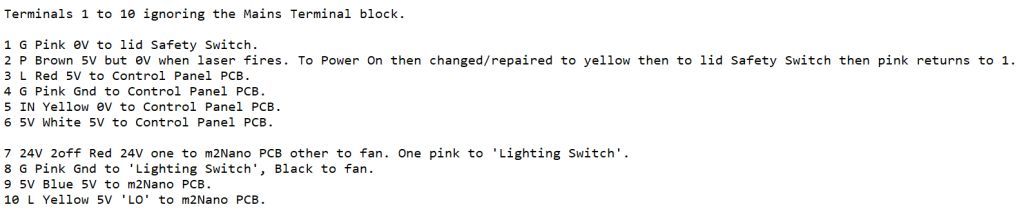

New updated LPS terminal readings.
The ‘Power Switch’ is the laser power switch. I did not take a photo of the ‘Main Switch’ (keyed) the ‘Emergency Stop’ switch or the battery powered temperature LCD. (see photo)
There is nothing else connected to the middle L and it has 5V on it all of the time except when the lid is closed and the laser fires; it’s then 0V. The last L goes to the m2Nano that has nothing connected to it at all except the stepper motors and I did unplug it one time but it did not make any difference.
The updated chart below shows terminals Gnd, IN & 5V, you can see there that only IN changes when all switches are On and the lid is either open or closed. They all go the the Control Panel and appear to be normal.
P is OK.
IN as can be seen in the chart ‘5’ does go to 0.7V (the laser is set at 11.0%).
( P=0V(grd), IN=5V ) the L signal should be sitting above 5V and the laser NOT FIRING but if you connect G(ground) to one of the L signals the laser should fire. Therefore one of those L’s must be grounded somewhere and it must be the L in the middle block as the other L only goes to the m2Nano board.

that latest chart looks like I would expect… There are a few things connected which all have to be set to get the P signal to enable( go to 0V ). That’s the lid switch closed and the Laser Switch ‘on’.
The “Power Switch” does not make sense to me in how you are explaining it since it is what should turn on the AC power to the machine. Yes, you also have a safety key switch but I would not expect that metal switch to be connected to AC power. Maybe it’s inline with the P signal…
But after all that and all the things it took to get P=0V I see that L is still at 5V throughout all the tests. I don’t understand how then you say if the lid is open then L goes to 0V when you stated in the chart on the last line “lid open” … P=5V and L=5V
The ‘Power Switch’ switches the power On for the laser and the LCD is not lit with it Off; it does not switch the AC power. The AC power is switched by the keyed switch which is actually labeled ‘Switch Machine’, that switch along with the released ‘Emergency Stop’ supply power to the LPS. In the photo of the opened lid you can see those two switches near the bottom (blue wires in and red out). I have just rechecked it all again. I’m not sure why you say “L goes to 0”, maybe because the original chart at the top shows that but I found P wire had fallen out, the updated chart shows that L doesn’t go to 0V at any stage, P goes to 0V when the lid is closed because the laser fires.
