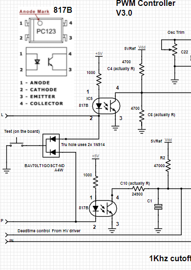

Note: typically LO and L are connected internally on the board and are therefore the same signal. You can check with a meter.
Please let me know if this it true for this LPS type as I may have an error in my schematic.
It does seem that LO/L is getting grounded with the P signal however your measurements do not show that?
I have seen this kind of behavior when there is a bridge or bad diode in the LPS test button circuit, although the table does not show P controlling L?

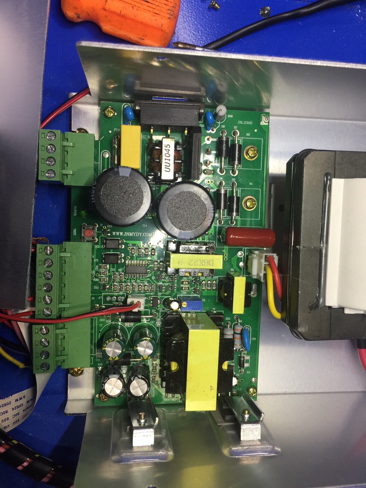

Thanks donkjr. I will hopefully get a chance to investagate further tomorrow and will check (if I can) if L & LO are connected internally. I have been thinking for a while that there must be some type of internal switch that has faulted and remains closed and I would not be surprised if it’s the one in the middle of your schematic which appears to be the same as the one at the bottom. In my attached photo, are these the pair of chips (PC123) located just above the ‘TEST’ button? Cheers.

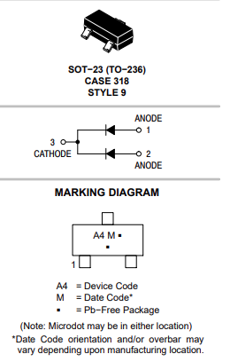

The dual diode package is the small 3 pin chip right next to the TEST button and those look like the two opto-coupler ICs/chips (one for the L circuit and one for the P circuit ) just below the diode chip.

The behavior of your supply [i.e. it fires when P is grounded] suggests that there is somewhat of a short between P and L. Outside of that, the supply seems normal?
Therefore, I suspect the diode array connected to the test button A4W. Alternately there maybe something on the backside of the PCB or connectors creating this problem
That said, the measurements, do not seem to support this theory. In these irrational cases I just keep testing stuff until it makes sense…

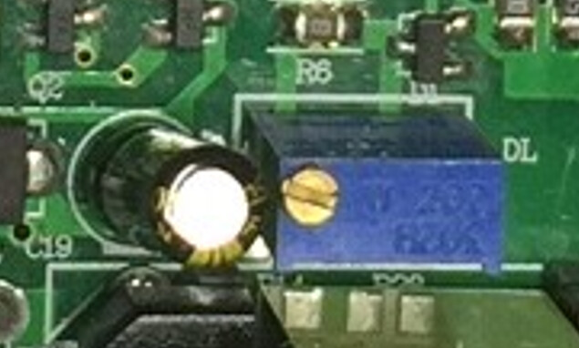

I found that there was a 7.4 M ohms resistance between L/Lo and GND and on close inspection of the PCB I found that the metal cased earthed capacitor next to the adjustable potentiometer was touching the brass adjustment screw on the pot. After moving that over a tad plus separating some other components I was not getting a reading :slightly_smiling_face:. I temporarily put the PCB back and made all connections bar P1 & P2 terminals. I powered up and pressed the ‘Test’ button on the LPS and the laser fired, I then proceeded to carry out ‘Test 1’ and when I touched the loose end of the wire from GND to P there was a “cracking” sound but no flashes or smoke; I then pressed the ‘Test’ button on the LPS but the laser did not fire :worried:.
I have removed the PCB again but cannot see any obvious damage. Not sure where to go from here.
Yes L & Lo are on the same circuit when checked at the soldered terminals under the PCB. P2-5 is not connected to either P2-4 or P1-1.

Can a test be carried out at the three pins on the LPS where the Flyback transformer plugs into, if so what voltage should I see? This to test the circuit between the 'Test" button and the three pins, if nothing there I guess the LPS is faulty. Cheers.

Is this the adjustment screw you are referring to? Most capacitors of this type have nonconductive sleeves on them.
What was your conclusion on the state of the diode array that I have been pointing you to test?
Looks ok; Pins 1 to 3 and 2 to 3 both read 0.57 ohms; no flow the other direction and no flow between 1 & 2.
