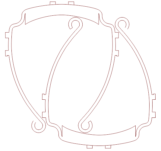

So, I got a 48"x96" of .020 PETG from my supplier this morning, it was about $25. I was able to dice it into 8"x12" pieces, it yielded 48 of them.
I resized the file to the max it would fit while leaving me a little room for error. It was a good bit smaller than the original but I thought I’d give it a shot.
I actually got the settings pretty close the first time, it was tedious to separate but workable for a test. My sister tried it on and was impressed, but thought it could use more coverage around the sides. I did some magic in Inkscape and came up with a design that, while shorter that the original, actually had more coverage on either side!
I was also able to arrange the forehead straps to maximize the material usage and meanwhile got the settings dialed in to near perfect.
mask3
I was unable to locate any rubber bands so I improvised with some of my wife’s hair ties. It’s a little tight on top and a little loose on bottom, but with the correct size bands I believe it’ll be perfect!
My sister is going to present it to the powers that be at the hospital tomorrow and see what they think. If they like it, I can knock these out in bulk for less than $0.60 each! Also, my brother-in-law is a firefighter, and they’re taking extra precautions on calls these days, so they be of use to them as well.

If laser cutting it, looks like I could nest them and get 2 in a piece 214 x 209mm (includes 1.5mm margins).
Quick look on Amazon shows I can get a 1/8x24x48 piece of polycarbonate for about $37. In a 24x48 piece I could get 20 headbands at the current size.
If you shave off about a bit of the design from front to back you could probably get another 6 (assuming you can cut down the sheet with minimum loss of material, like scoring and snapping).
Of course with a bed bigger than a K40 you could probably do a better nesting scheme to get a better packing efficiency.
