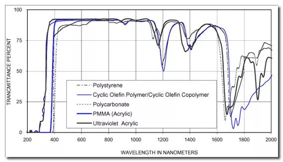

A good set of search terms here is “acrylic transmission curves” — here is an example that shows how similar clear plastics are:
https://www.gsoptics.com/transmission-curves/
Note that there are a couple plastics there that are transparent to UVA (longest wavelength ultraviolet).

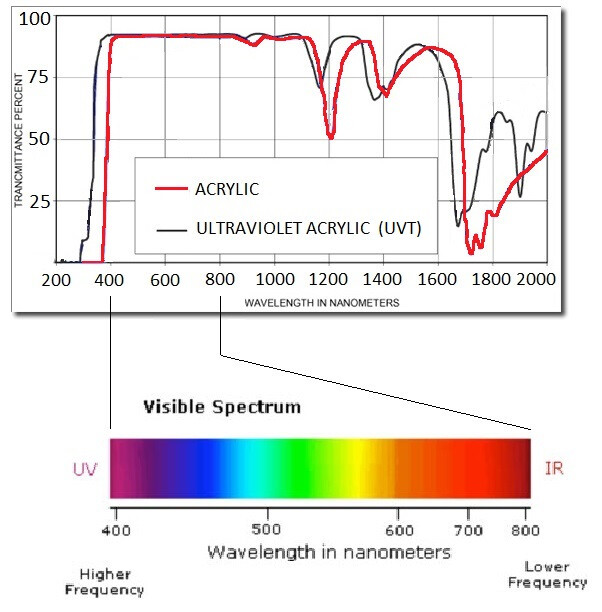

This writeup of the difference between normal acrylic and UVT acrylic shows the visible light spectrum:
