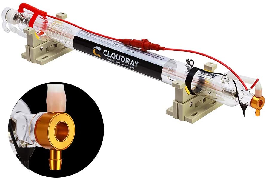

A tube like this cloudray one runs in the order of $180. You may find a cheaper brand if you look around.
Cloudray is doing a 6th anniversary sale but I don’t know whether it applies to tubes.
Similar or the same direct from Cloudray for $120 plus shipping:
Or look through what they have:
720mm tube from Lightobject for $170 (two-week backorder right now though):

I like the idea that the Cloudray tube you linked to on Amazon comes with the wiring already attached - seems simple-enough to do, but I know the proper insulation for that high-voltage connection so close to the housing is not that easy.

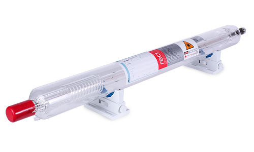

Some of the older cheap tubes had a reputation for losing their seal after a while, regardless of use. The Reci and SPT tubes (at least) have a better reputation for longevity.

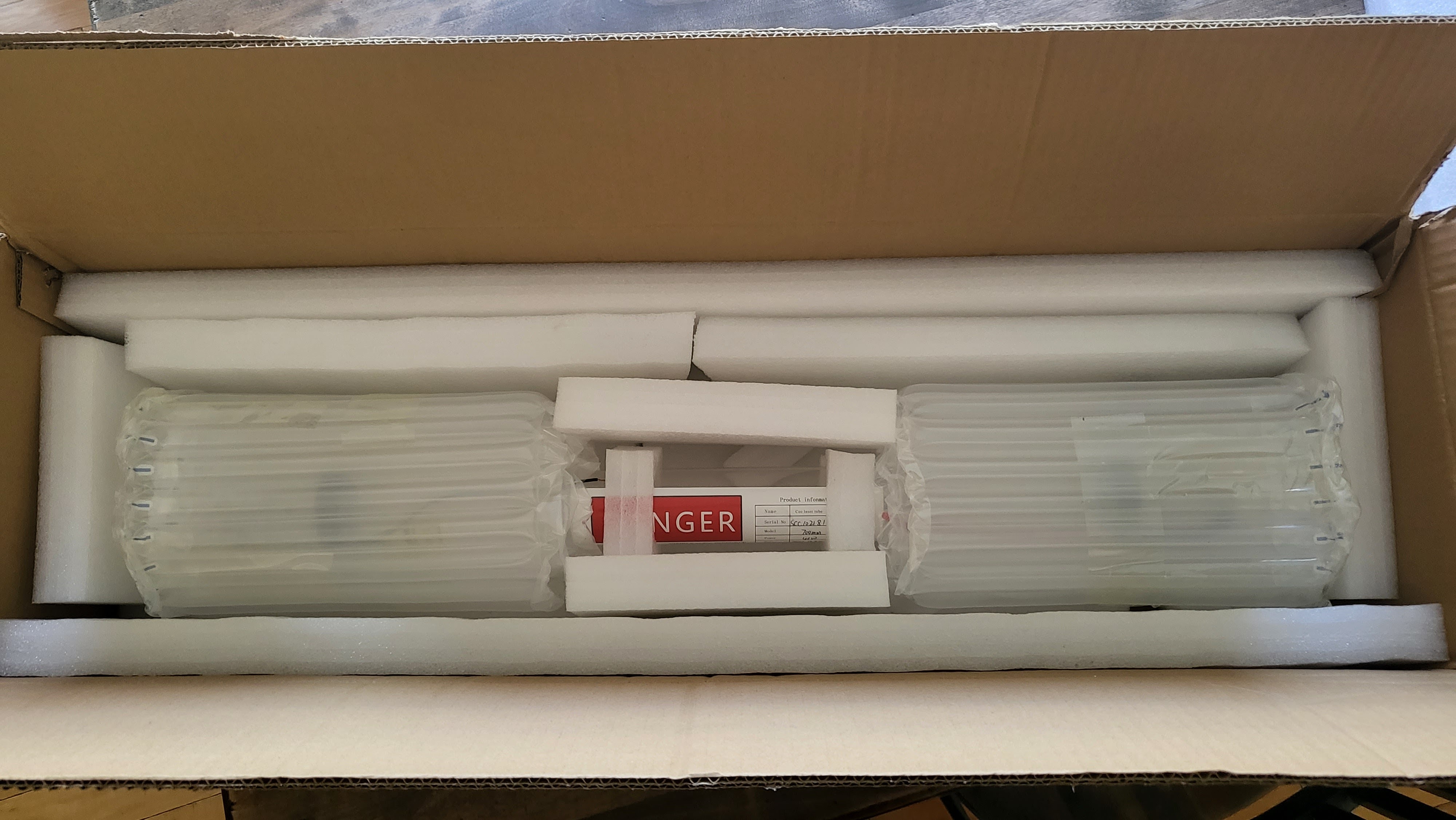

Welp, FedEx just dropped off my 700mm OMTech laser… I’ll be heading out to pick up some distilled water and some supplies a bit later and hopefully I’ll be operational over the weekend. I will let you all know how things turn out :-).
