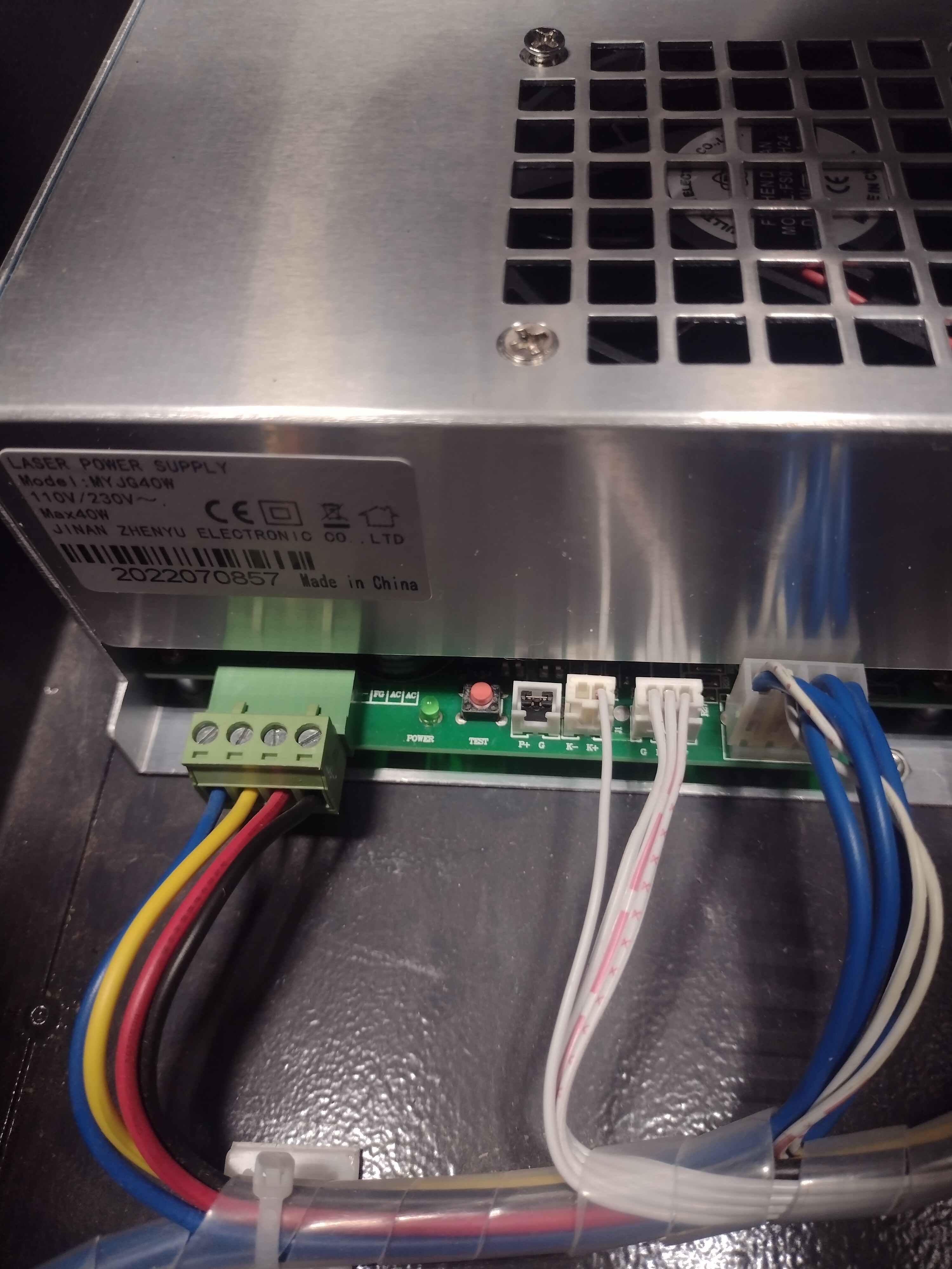

I have recently installed a replacement power supply after the failure of my original power supply. I used an OMTech MYJG-40W. I selected 115V via the slider switch, connected the anode to the laser in the same method as it had been originally installed and plugged in each of the connectors.
Upon installation, the machine “woke up” and the laser would test fire from the button on the LPS. Loading a job, the machine worked as intended EXCEPT that the laser would not fire from commands from the control board. After consulting some blogs and forums, I realized that the interlock circuit was most likely to blame. My machine is not equipped with any such interlocks. Upon inspection of the original power supply connectors, I discovered that a tiny jumper plug had been installed across the P+/G1. I transferred the jumper plug to the new power supply. Now, when the machine is powered on and the power level is increased much above zero, the laser fires continuously!
Could this be a grounding issue? I went ahead and tried adding a external ground to earth from the grounding lug, but this had no effect.
Did I just receive a faulty power supply? If so, what is your recommendation for a replacement power supply?
Attached are photos of the new power supply (with black jumper plug installed), the old power supply, and the M2Nano board.
Something is continuously enabling the LPS to fire.

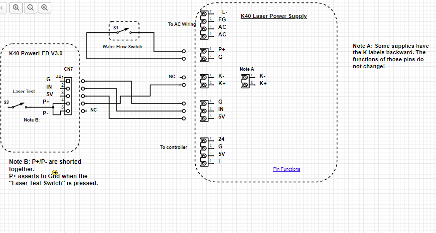

---------------Test Procedure -----------------------
------ Wear EYE PROTECTION ---------------------
Set the power at 20%
Remove these cables from the LPS:
  • 2 pin K-K+
  • The rightmost 4-pin connector
Power up the machine.
  1. Does the laser still fire continuously?
    Yes: The LPS internals is enabling it to fire. Stop & post the result
    No: then do this
    • Power off the machine:
    • Plug the 4-pin cable in
    • Power up the machine
  2. Does the laser fire continuously?
    Yes: The L signal from the controller is enabling the LPS to fire. Stop & post the result
    No: then do this
    • Plug the 2-pin K-/K+ cable in
  3. Does the laser fire continuously?
    Yes: the K+/K- is being held low from the control panel. Post result
    No: you shouldn’t have gotten here. Post result

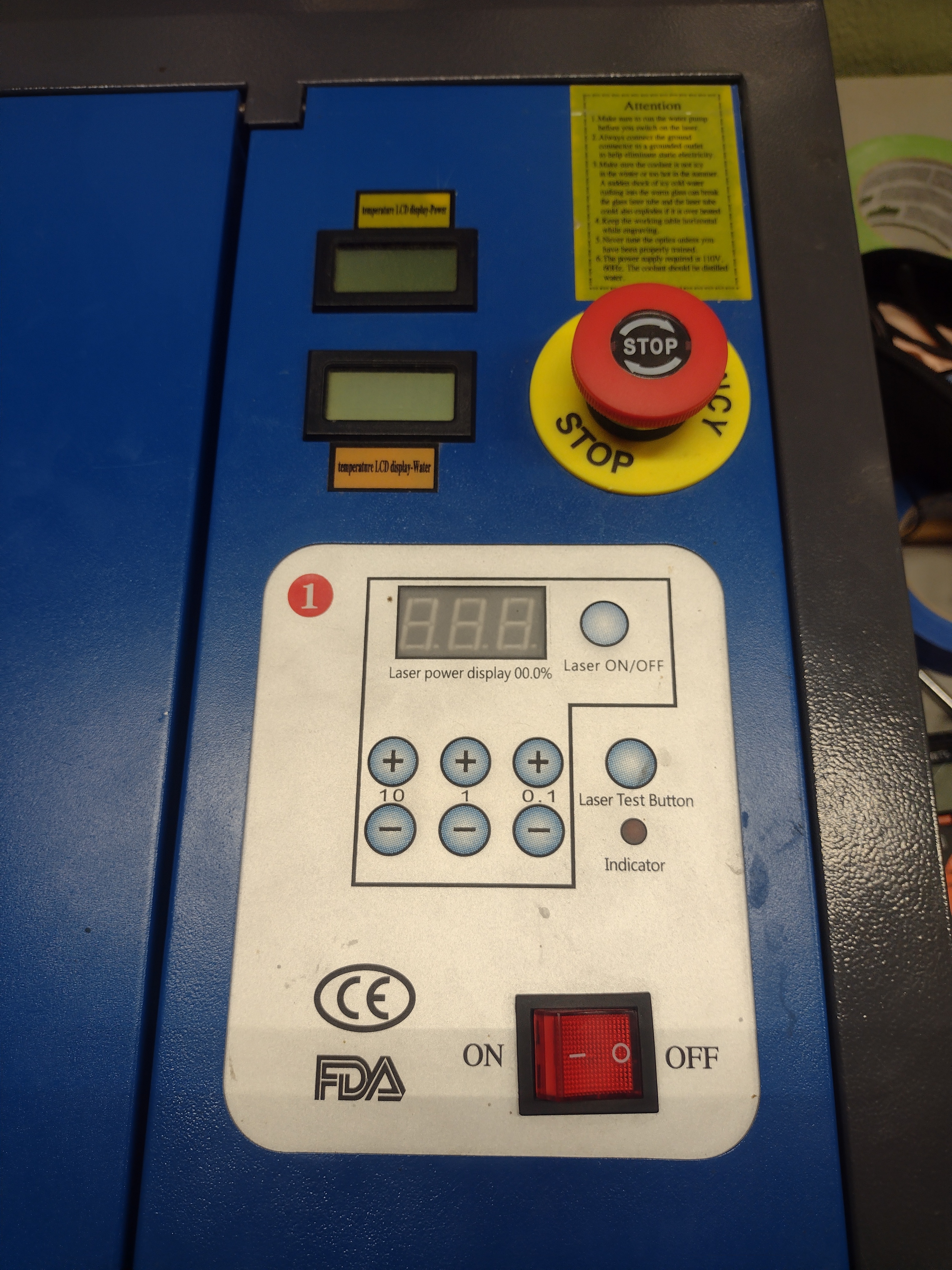

Digital control panel, yes.
It seems that your digital panel is continuously asserting the laser test button signal (K+ to ground).
Please post a picture of the panel.
3. Is the laser test switch on the panel stuck on?
4. If you have a “light instruction” Led on that panel is it on continuously? Does it illuminate when you push the button?
This is the current control panel. It is a replacement of the original which had a faulty display. It was the first thing that I replaced when the machine initially stopped working. Though I tried to order a direct replacement, the one I got is not made with a laser test button.
As for the indicator light, I believe it was flashing initially during a raster operation when I installed the new LPS (prior to installing the P+/G jumper), but it doesn’t seem to be illuminating now.
I still have the original which I could reinstall.
I don’t understand this statement with the picture you showed of your current control panel since it shows a button labelled “Laser Test Button”.
Has the machine ever worked properly with the new control panel installed?
No sir. I replaced both the control panel and the LPS while the machine was not working. There is a good chance that the new control panel is doing just what you indicated in your earlier post.

Hi Doug. I misspoke when I said that the new board didn’t have a laser test fire button. What is actually absent is the laser on/off button from the replacement control panel. It is not obvious from the exterior as the labels are just on a flexible layer that does not get removed when the panel is swapped.
