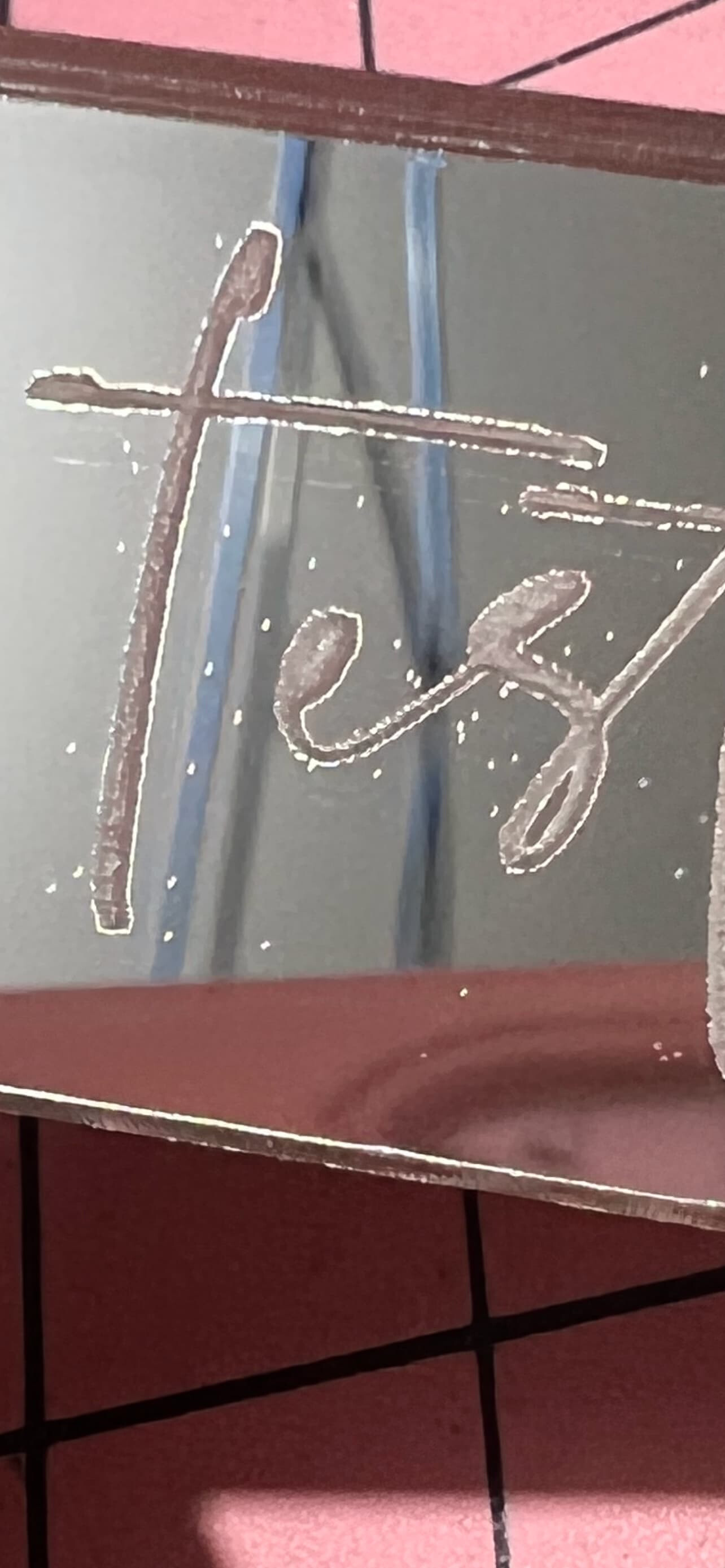

Laser glitching around text
A LightBurn user is seeing this when they use LightBurn with their Ruida based laser. It doesn’t do it using the same text on RDWorks.
The speckles get closer to the text letters when the speed is dropped to 150mm/s(from 300mm/s).

here’s the image after the speed was cut 50%
dots-half
Thoughts?

Turns out it also does it with RDWorks… She just did a test on leather to prove to someone, who didn’t read the thread, that it’s not the mirror material and it does it on leather and she did the test on both LightBurn and RDWorks.
it is intermittent and showed it does it less on larger blocks/boxes of engraving as opposed to letters. When she created 4 vertical and 4 horizontal lines, left scan angle at 0 and engraved both sets of lines, the horizontal lines showed no signs of speckling dots. Therefore I didn’t bother going to vector testing since when the laser is on for longer periods of time it doesn’t erroneously trigger outside the area and the laser head never really travels outside the lasing area.

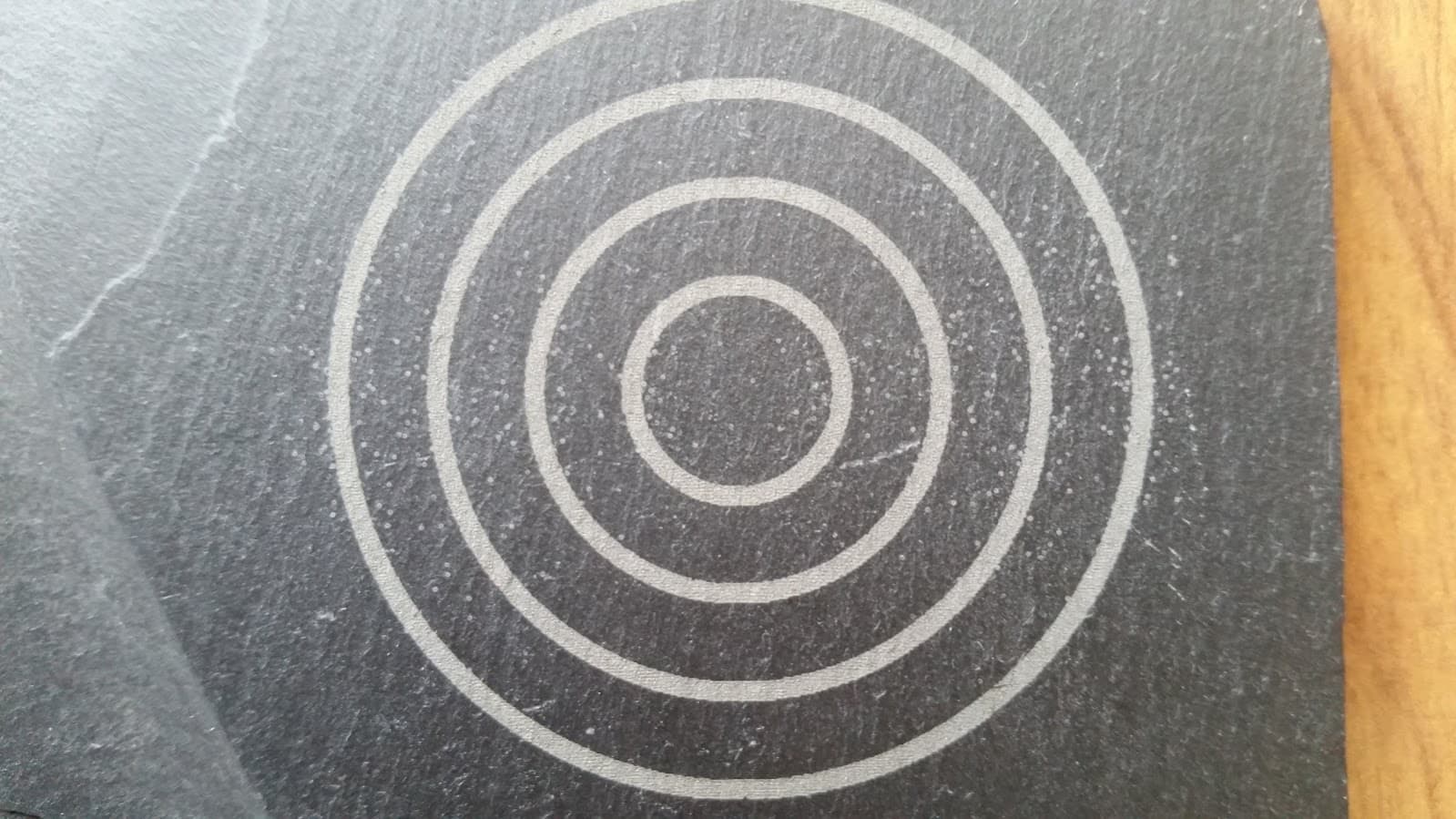

Yet another person chimed in about having the same problem and posted a picture of a test he had done. Look at the distribution, it is shaped like an hour glass on its side. weird.
This user found if he keeps power out of 18-20% it does not do the speckling dots.
The hourglass may make sense?
The problem is somehow manifested and related to the vertical axis. Effectively the vertical axis delta gets smaller as you approach the center of this design.
