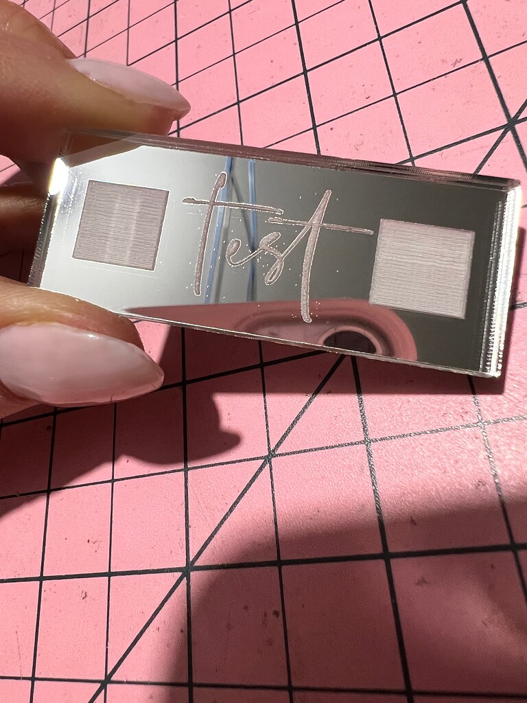

What’s even stranger yet is that a 3rd person joined the discussion on the LightBurn forum saying he too had the problem but as long as he keeps the power above 20% or below 18% the problem goes away. Even noticed that it’s effected by cold weather and happens more in cold weather. The original poster said that she’s in the southern hemisphere and is in cold weather but her laser room is not “cold” but is cooler than the rest of the house. She also confirmed that if she increases the power and also increases the speed the effect is greatly reduced.

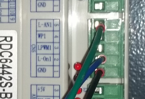

They are all Ruida based controllers. 2 of the 3 are using LPS-L for Laser-Enable and LPS-IN for Ruida-PWM. One of them tried a 2nd Ruida and had the same issue.

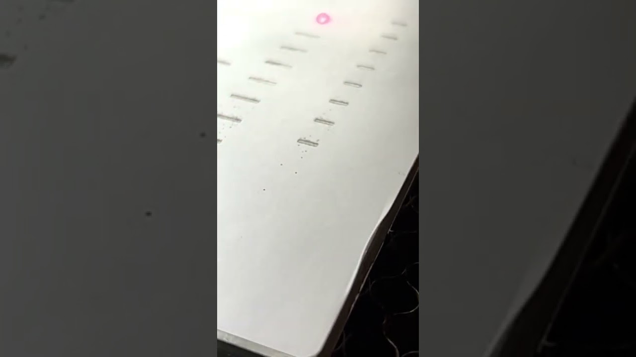

here’s a slow-motion video of the effect in action.
Fascinating…
Using the arrow keys I statically stepped through the video and took screenshots.
You can see the random dots being created. Of course, that is not new news but the position of the head is curious.
It appears to me that there are unexpected deliberate movements and single dot fires that are outside of the programmed imaging area.
The laser fires in the programmed area. Moves vertically down the page and then fires an unexpected dot and then back to the programmed sequence.

Seems like a Rudia firmware problem to me.

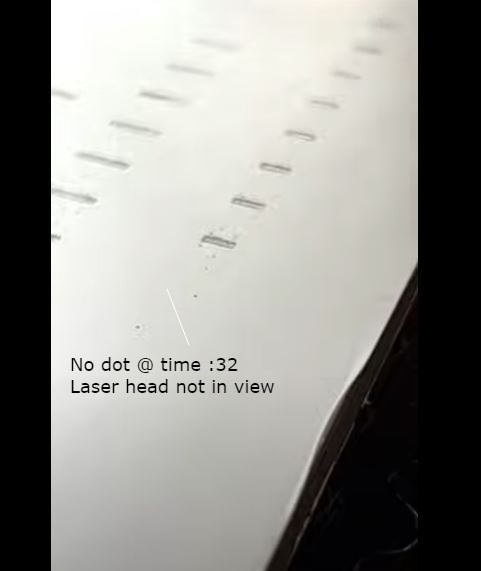

These captures are time stamped
@ :32 [watch for the random dot to be created in next frame}
@ :33 A dot is created the head is the frame. But it seems the head is outside the intended imaging area. [the rectangular boxes]
@ :35 the laser is further up the page firing in the expected area.
35_LaserON_Annotated

My LPS wired like this:

I am doubtful of this theory because in the video the head actually moves to an erroneous location and fires and then returns to the programmed imaging. The LPS has no ability to move the carriage.
I think this is because the Rudia is actually miscalculating and creating erroneous moves during a job.
Of course, my theories would be erroneous if the video is playing tricks on us.

An interesting point, that I didn’t see here was that when bi-directional is turned off it’s only on one side of the engraving. I mentioned, to clarify that it was on the leeward side.

I can’t get beyond the evidence (video frames above) that the head is actually moving outside the programmed imaging area and firing a single dot? Then it returns to the programmed area and continues.
Do you see any reason the video is fooling me???
This notion is important because it completely eliminates the LPS and the theory of noise affecting the LPS. The LPS could randomly fire but not randomly move and fire.
In fact other than “noise in the controller” it mostly eliminates noise as the culprit. Even then, noise in the controller would have to cause it to create a legitimate move and fire. Noise isn’t usually that intelligent.

If you look at the stopped images I posted and the posted times you can see the head move, burn a dot and then return ???
The only thing I could see what the head moving in the axis of the scan, as it was overshooting( due to high speed engraving and acceleration settings) it glitched and briefly fired the laser. And it’s inconsistent as to when during the over-shoot this glitch occurs but it was observed to cluster the glitches close to the actual scan line when the speed is reduced.
I wish I could see the head moving out of line with the scan but since the video was take at an angle to the scan axis it’s not so easy to see when it’s already moving in both X and Y relative to the video framing.
Ok let me see if I can do a more clear capture.
