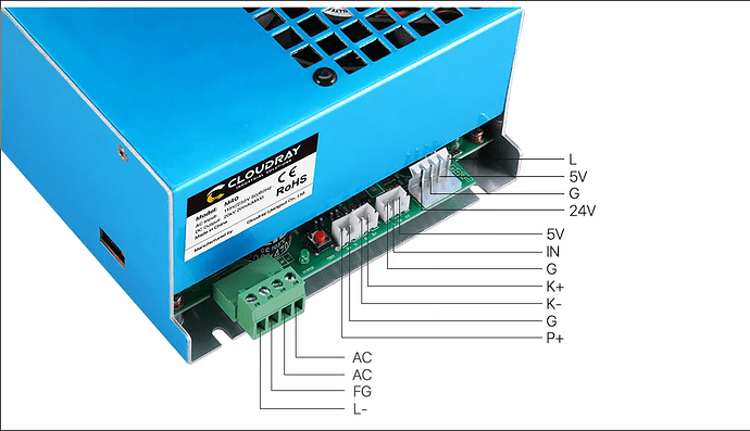

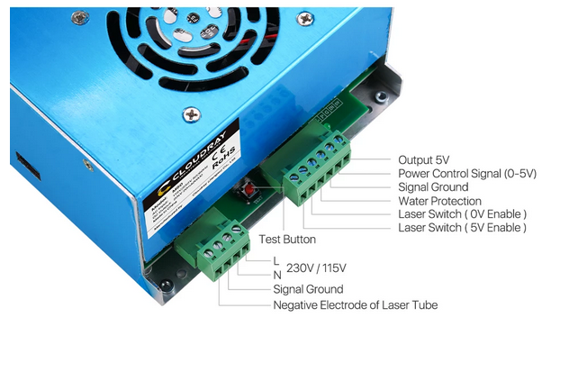

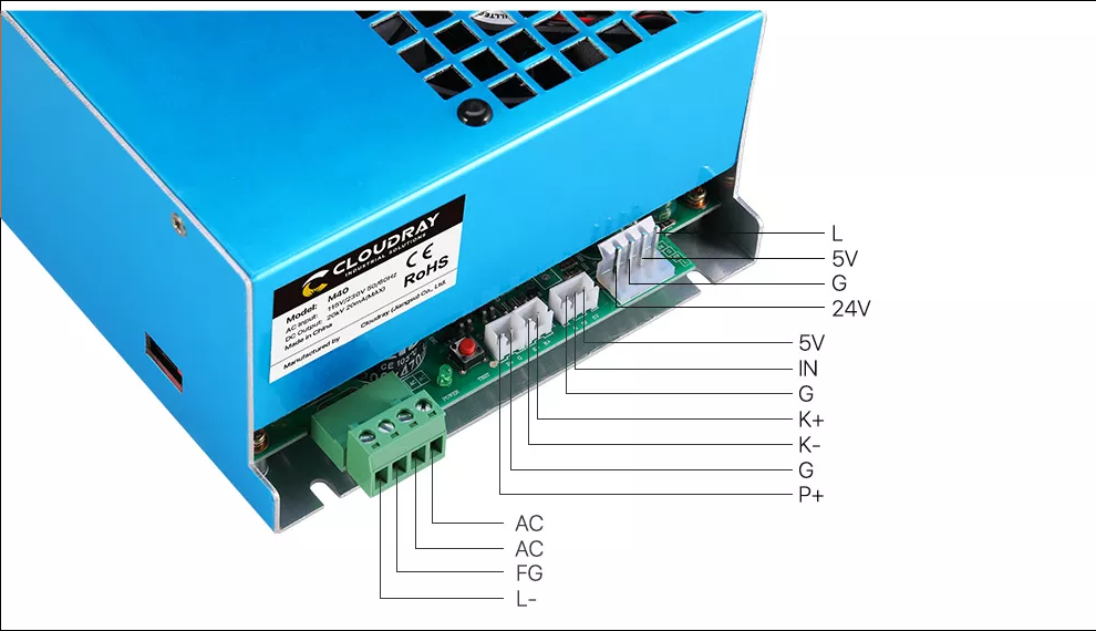

If you revert to the lps and yours looks like this:
Screenshot from 2022-06-13 09-00-27
Mine looks like this:
How clear is H, L and IN used as a reference to ‘your’ lps. The naming convention varies with the manufacturer. They are pretty inconsistent.
There was mention of emi… if not emi/rfi, what would you be attempting to filter.? Did you have a specific frequency in mind?
I’m not trying to pick on you, but I think I’m not understanding what you are attempting. I’d like to try about anything at this point to clear this up. However it has to be something we can actually do.

Are you telling me that the Power Control Input( LPS-IN ) is getting a varying TTL square wave, ie having pulse width modulation? The Power Control Input?
I must have missed when that was stated because I thought it was just a fixed period and fixed duty cycle signal used only to set the max power output of the LPS. If so it’s just not anything any of the other controllers( non Ruida ) take advantage of and if there were a benefit I would think the developers would have jumped on it long ago. Many systems just put a stable DC voltage on that Power Control Input( LPS-IN ).
Now the other signal is what/where I thought all the magic happened with regards to controlling how the laser was putting marks on materials. And that signal LPS-L or LPS-H and labelled as Laser Switch(0V and 5V) enable on the Cloudray picture. There, an ever changing pulse train is output by the controller and controls the pixels being marked on the material by the laser.
Personally, referencing the signals by the LPS names/labels makes more sense than mixing labels by controller output label and LPS label. Many here are far more familiar with the LPS-IN and LPS-L labeling used on LPSs found in K40 and K50 machines.
Unfortunately none of this discussion is eliminating any part of the system from the problem originally stated…
Yes, that’s the original lps design. There are really two inputs to control the lps. IN is the power control. L is to enable the laser to lase at whatever power level IN is set.
