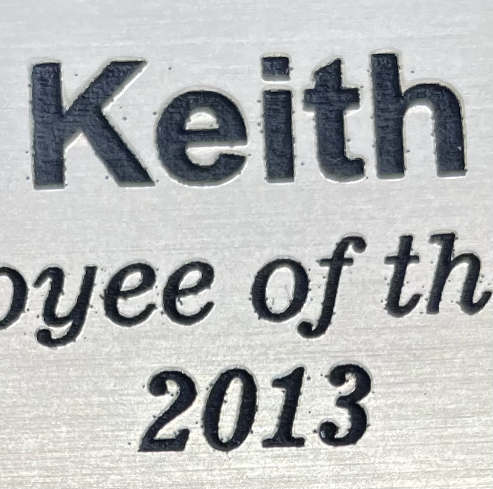

Well, it seems I’m seeing the same issue with my 50W. (KT332N controller)
I was etching a name tag on a plastic gold tone over black name tag blank. Just using the plastic protective film it came with as the masking.
I hadn’t noticed this before, which I theorized was due to the pulses not penetrating my normal masking.
Masked another blank using my normal masking and the glitches are not seen. So if your masking is heavy enough you can work around this if it’s a problem. Still would be nice to have a hard fix.

Ok, it’s a random and spurious output of energy of extremely short duration. :crazy_face:
Wasn’t trying to be offensive, but it must be lasing to do that. I’ve seen a number of these and most of them have changed out the tube, controller and lps and have the same issue… It would be nice to know where this originates.
It was interesting on one, where they disabled bi-directional engraving and the aberrant spots show up on the trailing side of the engraving only.

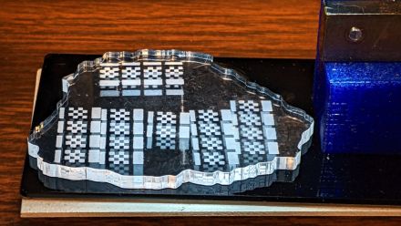

Just to close this out, Ed Nisley over on the Lightburn forum posted about what he found and blogged in detail. It turns out that the LPS at low power output( < ~30% PWM on LPS-IN ) has some LPSs sending power glitches on the output even when the Enable signal on LPS-L is off/High. I don’t know if this will show up when the LPS is controlled like a stock K40, ie DC voltage on LPS-IN and PWM on the Enable signal/LPS-L.
Ed’s proof it’s in the LPS as it’s controlled only by Ruida with PWM on LPS-IN and Enable on LPS-L.
Ed’s test rig setup.
