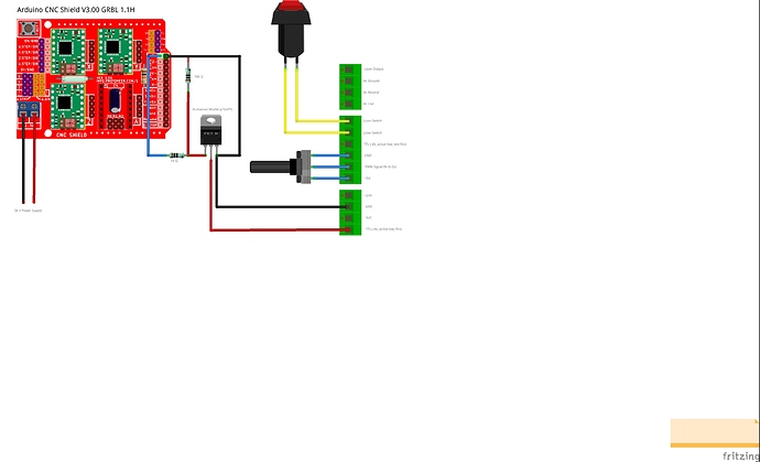

hi forum, i just joined this maker forum because i also have a laser k40, sorry for my automatic translation but i don’t speak english, i am italian, i wanted to share the mod i made on k40 with arduinouno and shield v3, i I found 3 identical connection projects on the net but I saw that the laser power was less powerful than the m2nano, I attach diagram.

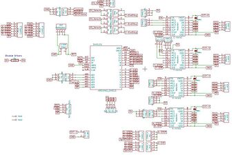

Controller & Sheild Schematic post schematic

first post i put drawing links,
IN>Z+
G>gnd Z

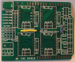

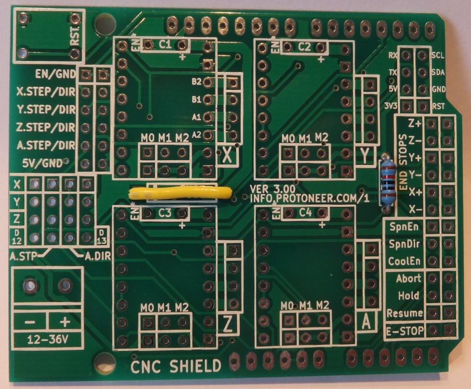

You are using this shield:

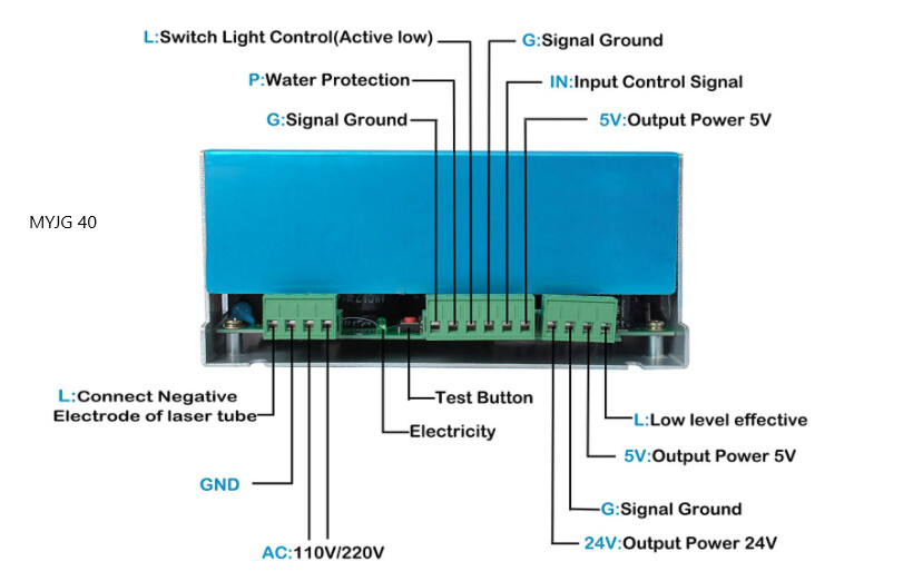

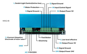

This is your LPS:
** You’re connected to the LPS like this:**
----Wiring table -----
From PinName Function To Pin
Sheild Z+ Power Control LPS IN
Sheild Z+gnd ground LPS G
LPS L ground LPS G
LPS P ground LPS G

@cprezzi are you familiar with this type of Grbl connection. To me, looking at the sheild, it looks like the Z end stop which is Arduino D11 {a PWM pin} is used for the LPS-IN pin connection. Is this correct??
all right what you wrote, power supply and schematic same as my schematic, parameter grbl $ 30 = 255
when i tried to cut plywood 3,5mm at 100mm / s full power 255, i couldn’t cut, i didn’t understand why, i abandoned arduino 1, in 20 days comes mks sbase LPC1768

@marcy I do not recomend the schematics from your fist post with the Arduino PWM out connected to the LPS IN. Instead I recommend connecting the potentiometer to GND / IN / 5V (like original K40) and use the L pin for the PWM signal. And because the L pin is inverted (active low) this means you would need a Mosfet to invert the PWM signal. Please see:
