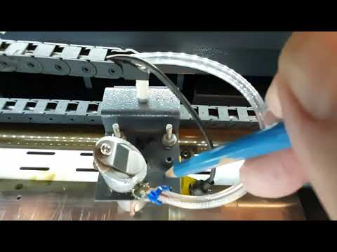

Check out this video…
K40 - Head - Adjustment Screws
That’s really great, thanks for sharing. We’ve been needing something to make the head adjustable. :smiley:
