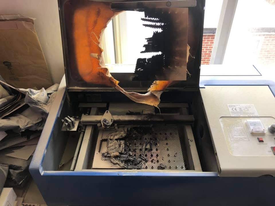

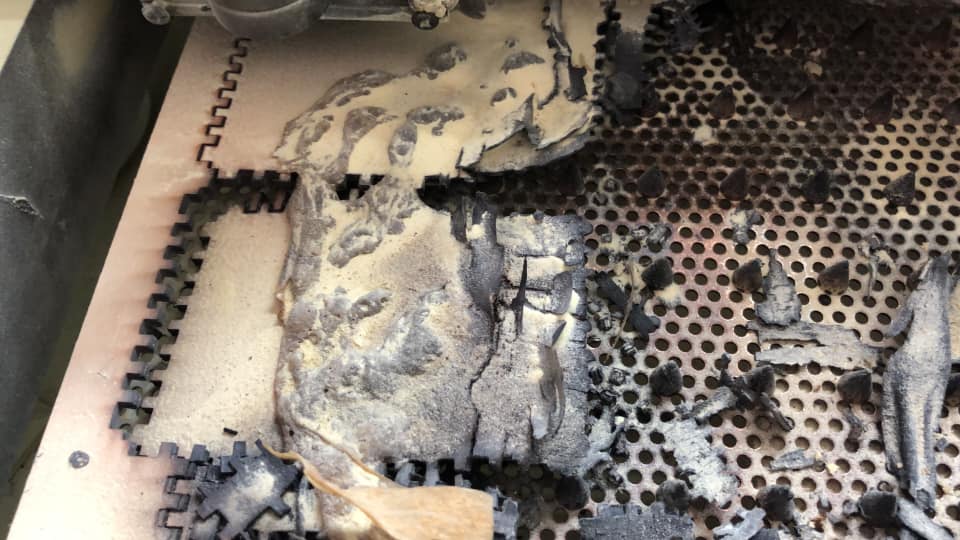

23 Feb 2020 Anybody want a slightly used K40? One careful owner.
I NEVER walk away while it’s cutting…Until today ?:frowning:
Nobody hurt thank God. Massive flames from such a little thing and my God those covers smell when they’re burning! Lucky I had the extinguisher to hand. Was only cutting 3mm birch ply. Last 2 of the order as well. Typical

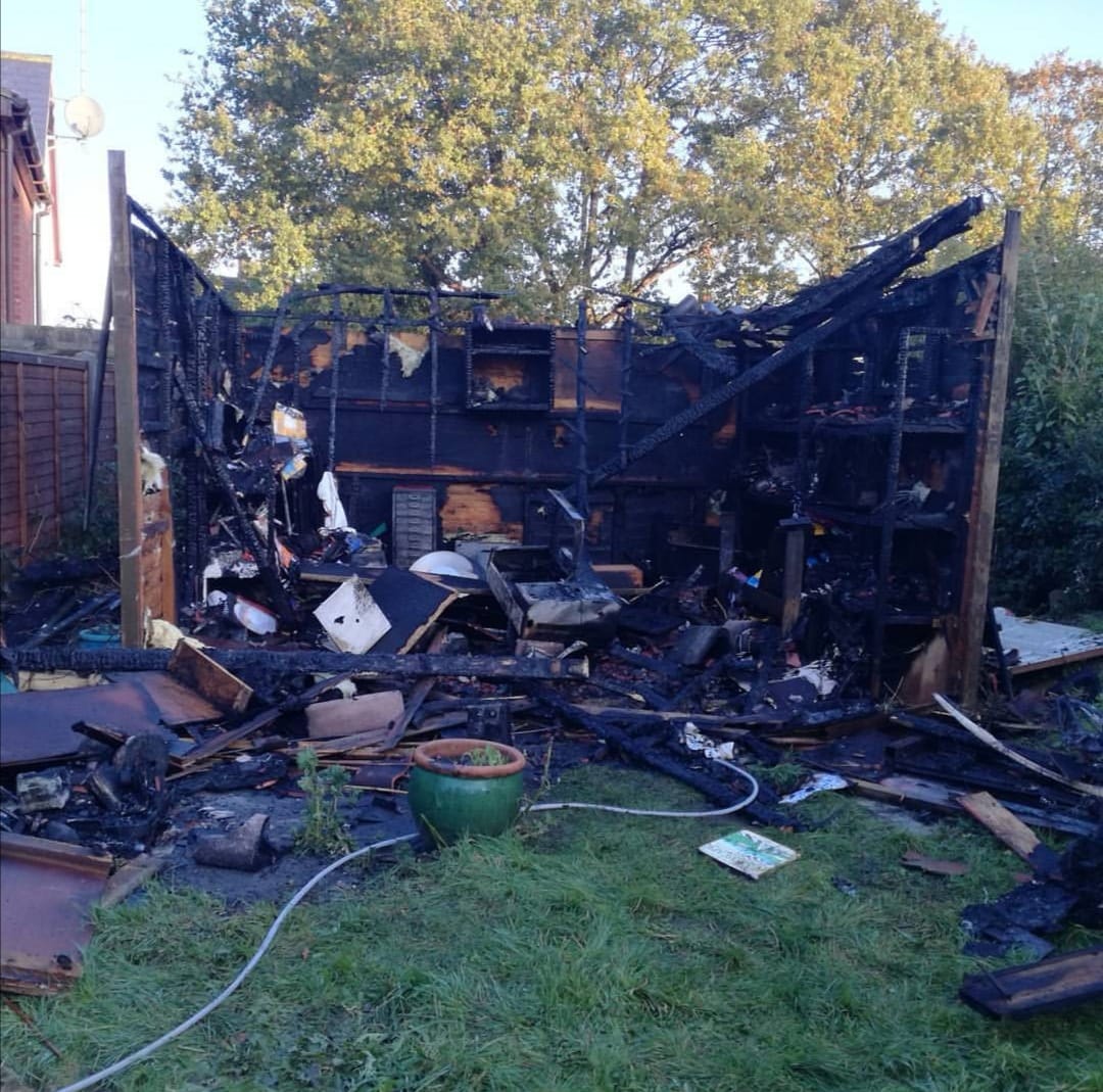

I quickly nipped to the house for a pee all gone in 8 minutes
All in all around 16k in loss on this ******* lol
[this prompted the question]
how does that happen in 8 minutes 0o
[the reply?]
a fire in a small enclosed wooden space. We called the fire brigade it took them 8 minutes to get to us by that time it was all over.

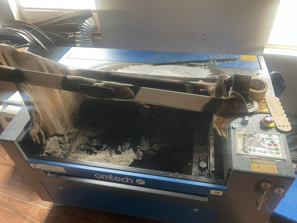

Just saw it in the OM group today.
Do not ever leave any laser unattended, always have a CO2 fire extinguisher at hand.
