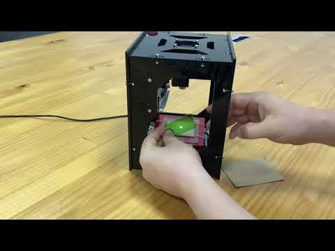

I went looking at NEJ laser engravers and now I stand corrected :zipper_mouth_face: .
  • The unit is a fixed frame with an adjustable objective lens mounted on the module.
  • The focal point is adjusted by moving the lens watching the beam through an attenuation material. Doesn’t seem too precise to me but maybe it’s good enough. My limited experience with these diodes is that the power is very sensitive to proper focus.
  • Btw this doesn’t mean that I am any more comfortable with anyone looking at the laser. I never cease to be amazed that China gets away with selling potentially unsafe products.
I would still try it but I don’t know how useful a ramp test would be because you would have to figure out how much to rotate the threaded lens holder to tweak it to hit exactly on the surface. Maybe multiple ramp tries until the smallest point is on the table.
It seems that adjustments for engraving vs cutting will also be a challenge to achieve. At first thought, I would get a selection of various thickness materials to use for engraving vs cutting and put them under the target.

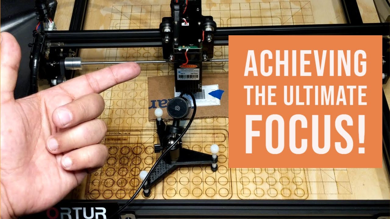

Yes but with an adjustable focus lens, surely it is a 2 part job? Adjust the focus for the smallest waist on the hourglass and then get that point in the correct position on the z axis. That is one of the reasons I wanted to add a motor driven z axis.
Anyway I have ordered a cheap digital microscope camera, so I can use it something like this…

I just cannot imagine myself looking at a laser beam through a microscope. There has to be a safer way.
Thanks for the info, I will take a look at Thorlabs and see if they do anything suitable for a 450nm diode laser.
Well you are looking at the beam on a computer screen, which I guess is no different than looking at a youtube video.
The cheapo (<ÂŁ20) USB microscope arrived yesterday and I am quite surprised at the quality for the price. Now I just need to get the machine built. :roll_eyes:
AH! Your talking about a digital microscope. I did not watch the video! Ya I would do that if there was covers on the machine :)!
