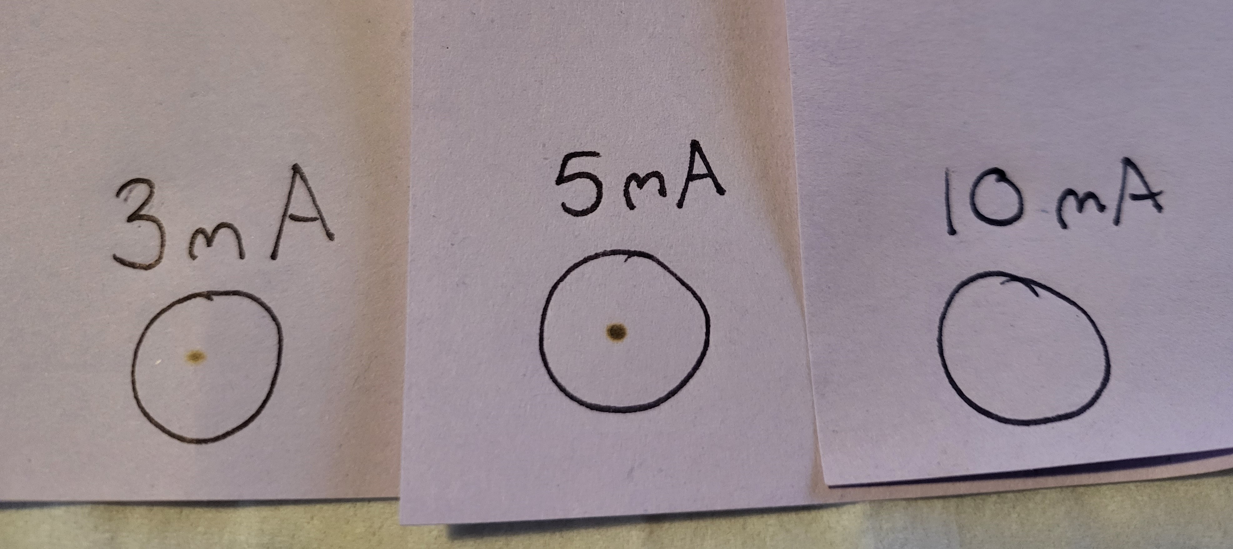

turn the power up well above 3-4 ma, like 1/2 power.
Put a target at mirror #1 and test fire.
Then Please Post:
  • The current reading on the meter
  • A picture of the burned target.
Hey Don, I put it up to 5mA and with a pieces of paper over mirror one and can confirm that the piece of paper was unharmed.
I moved the paper to the exit of the tube and still the paper survived,
Hold the paper at the tube I turned down the power and when it go to 3mA the paper got hit by the laser
Forgot the photo - so I will get one shortly

Is would suggest that the tube is damaged and not lase-ing above 5 ma
Or
the LPS is not outputting the proper power above 5MA
