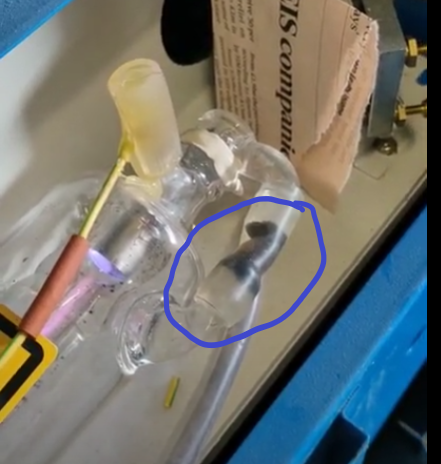

The end of the tube looks ok, see pic in link below, along with video (as new user, couldn’t upload)

Is there something plugging the water jacket?
JacketPlug

Not sure how old the tube is, was 2nd hand, so suspect it could be in need of replacing and the seller hasn’t been 100% honest. The water was flowing ok, that’s just some mould on the inside of the tube I think.
