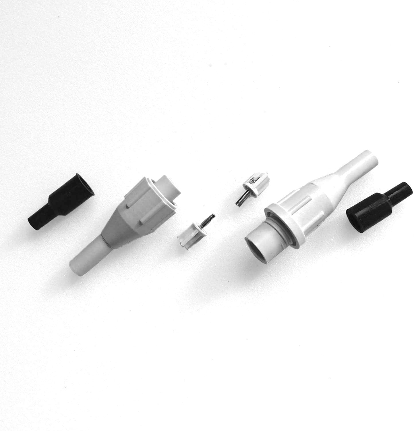

If your tube already has a wire attached I would recommend these connectors.
this is what I see available in the uk
I think you don’t want the connectors already connected though.
If you can’t get the plain connectors that @NedMan linked to, I’d suggest the “twist and seal with silicone tubing and sealant” option. You can leave a bit of extra wire and order some of those plain connectors to attach the next time you open the box.

If your machine doesn’t currently have a high voltage connector, get one. It’ll save you time and give you peace of mind. It’ll make future tube changes easier too.
Don’t think about it too much, I’d never done it before and managed to swap it out in 10 minutes, it’s been running great ever since. Feel free to message me if you have any questions
can’t seem to find the right high voltage connectors on Amazon UK. Any advice on the right one? And yes @renegadeltd I am probably thinking too much about it. Probably will continue to until the tube arrives in a few days :smiley:
I got mine from eBay - grey goose I think the company is called. They are the company that are the distributors for mini grbl board

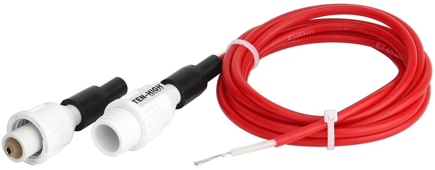

  • Add a HV connector [like the one @NedMan suggested above] inline with the existing HV cable and the new tubes pigtail. This makes it easy to change the tube in the future. HV connector must be installed correctly. I seal the ends with high dielectric constant silicon RTV **.

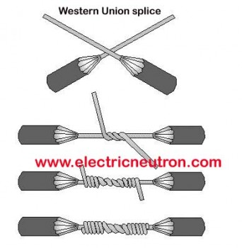

    • Join the pigtail to the existing LPS HV lead by twisting them like this: image

Thanks everyone for the EXPERT advice. I tend to think the HV connector is the way to go, if I can get one. I have emailed a local electric wholesaler to ask if they have them here. I’m in Ireland but I sent the US link above to give them an idea of what I need and explained why. I’ll keep you informed. the tube is due to arrive tomorrow. If it does I’ll update as well.
